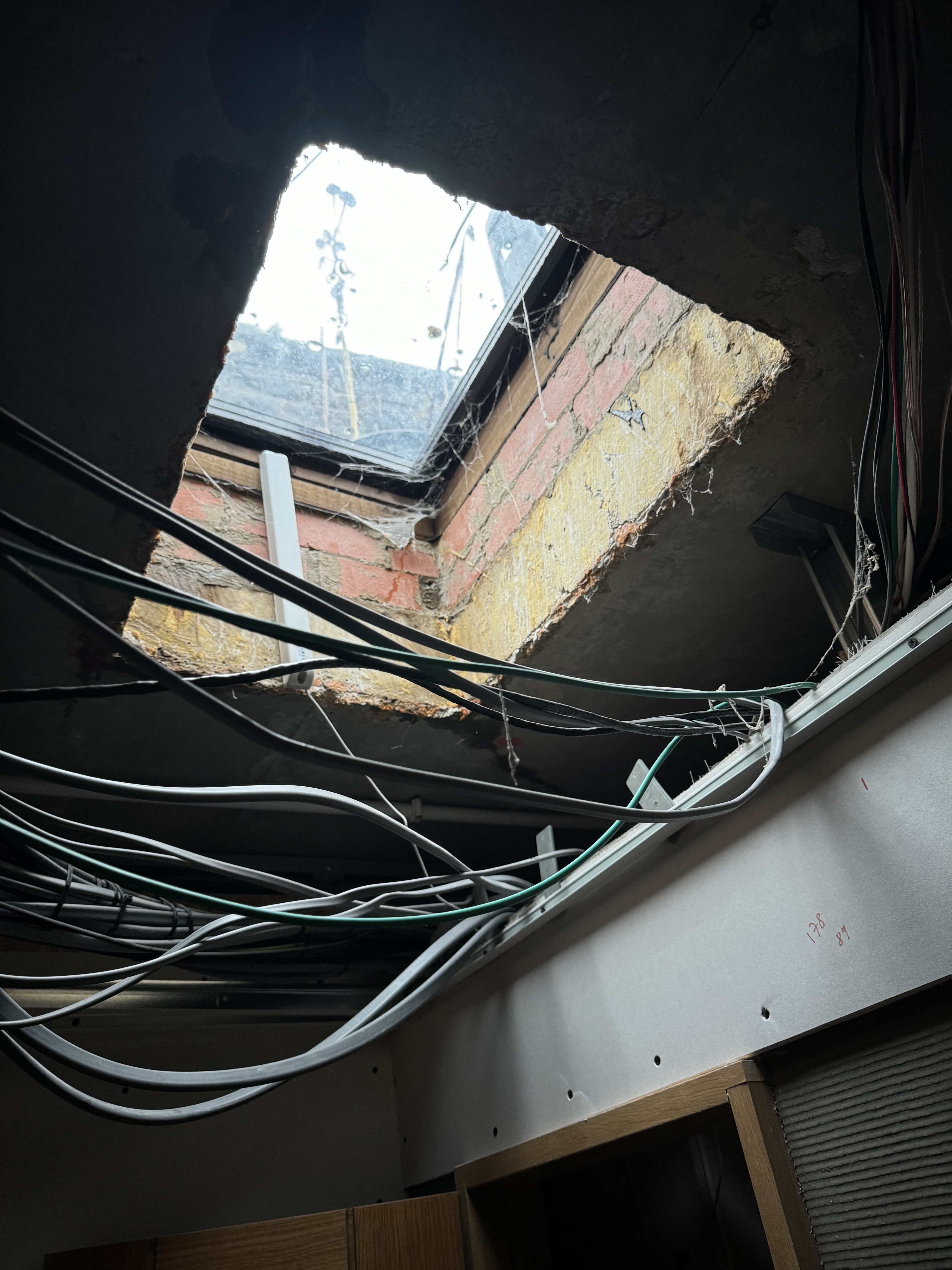

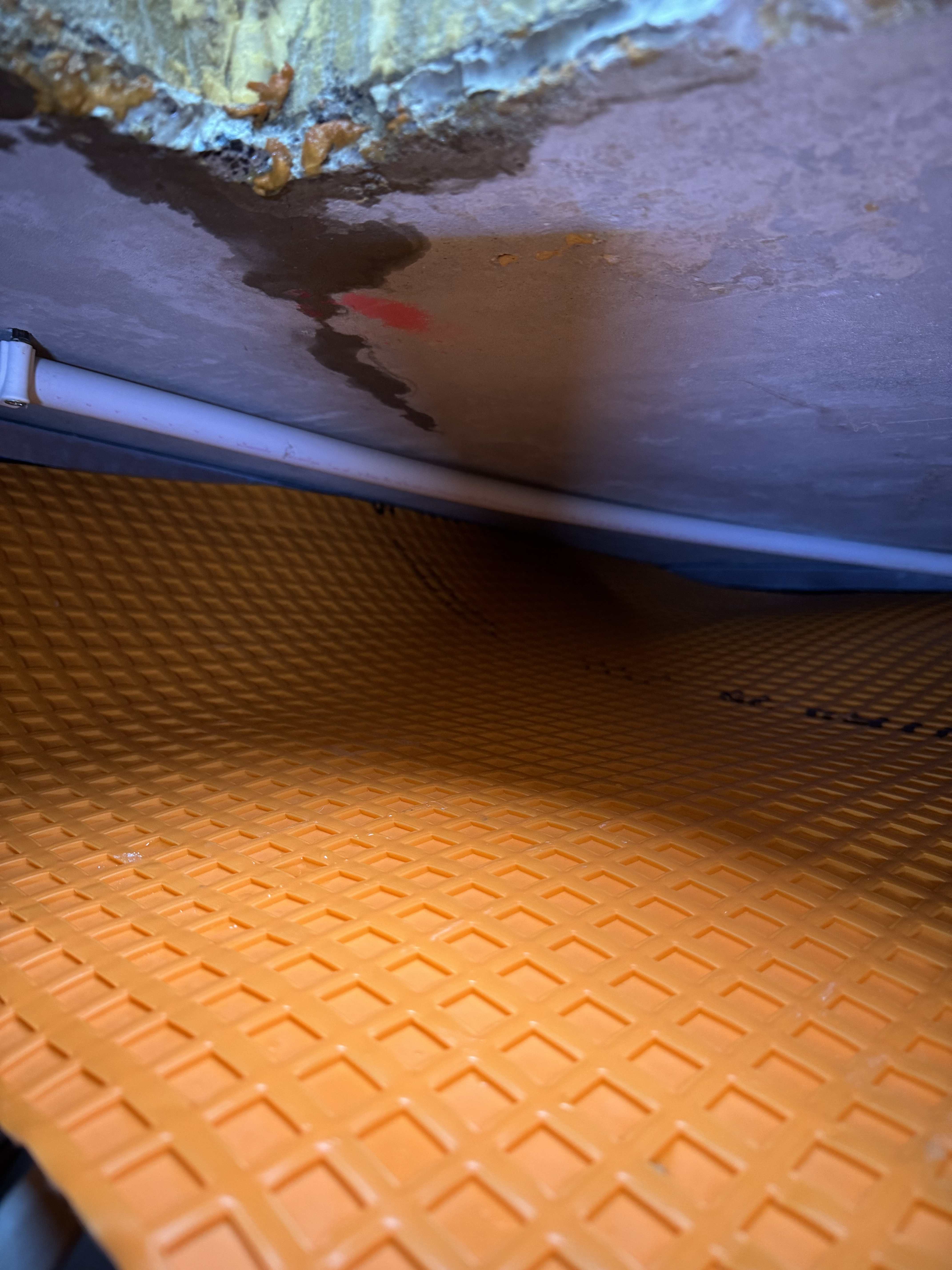

Pocster Posted November 24, 2024 Share Posted November 24, 2024 Ok - stop laughing that’s the 1st thing . The ongoing saga continues- due to the storm etc has got a bit worse understandably. So the glazing does not leak . I believe water is getting in outside the plot running down the wall and getting in over the concrete slab . If you look closely at the glazing you can see water comes in only above the concrete I.e dry as a bone above this . I need to ( one day ! ) dig up the lane side outside that wall and try and fine any gaps -fill with cement . But of course - that’s not a guaranteed fix . So in reality I think I need a 2nd ceiling ( above tiles - below cables ) with the sole purpose of directing water towards the edge ( dimpled membrane on wall leading to perimeter drain ) Take any suggestions how to do this ! . My 1st issue is how to make a ‘tray’ that sits around the base of the Lightwells and directs water into a ‘ceiling ‘ membrane . Obviously once I think I have a solution I’ll empty the room , take down the tiled ceiling . So I’m thinking of a simple ‘wedge’ structure . The membrane sits in this ; and as it has a fall directs water to the outer wall . Its what I do around the sky lights that’s got me a bit stuck . Photos for amusement of current sky light leaks 1 Link to comment Share on other sites More sharing options...

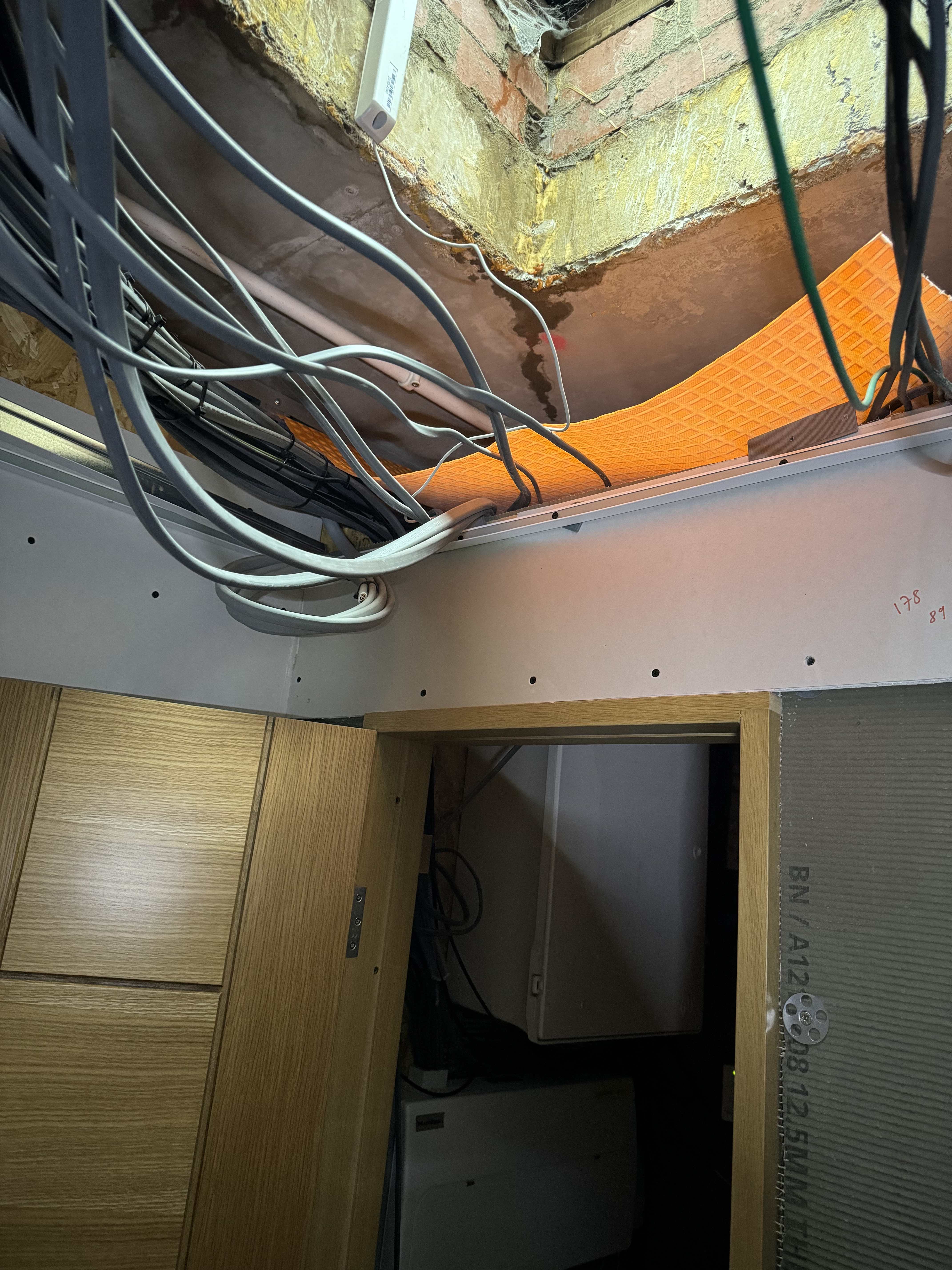

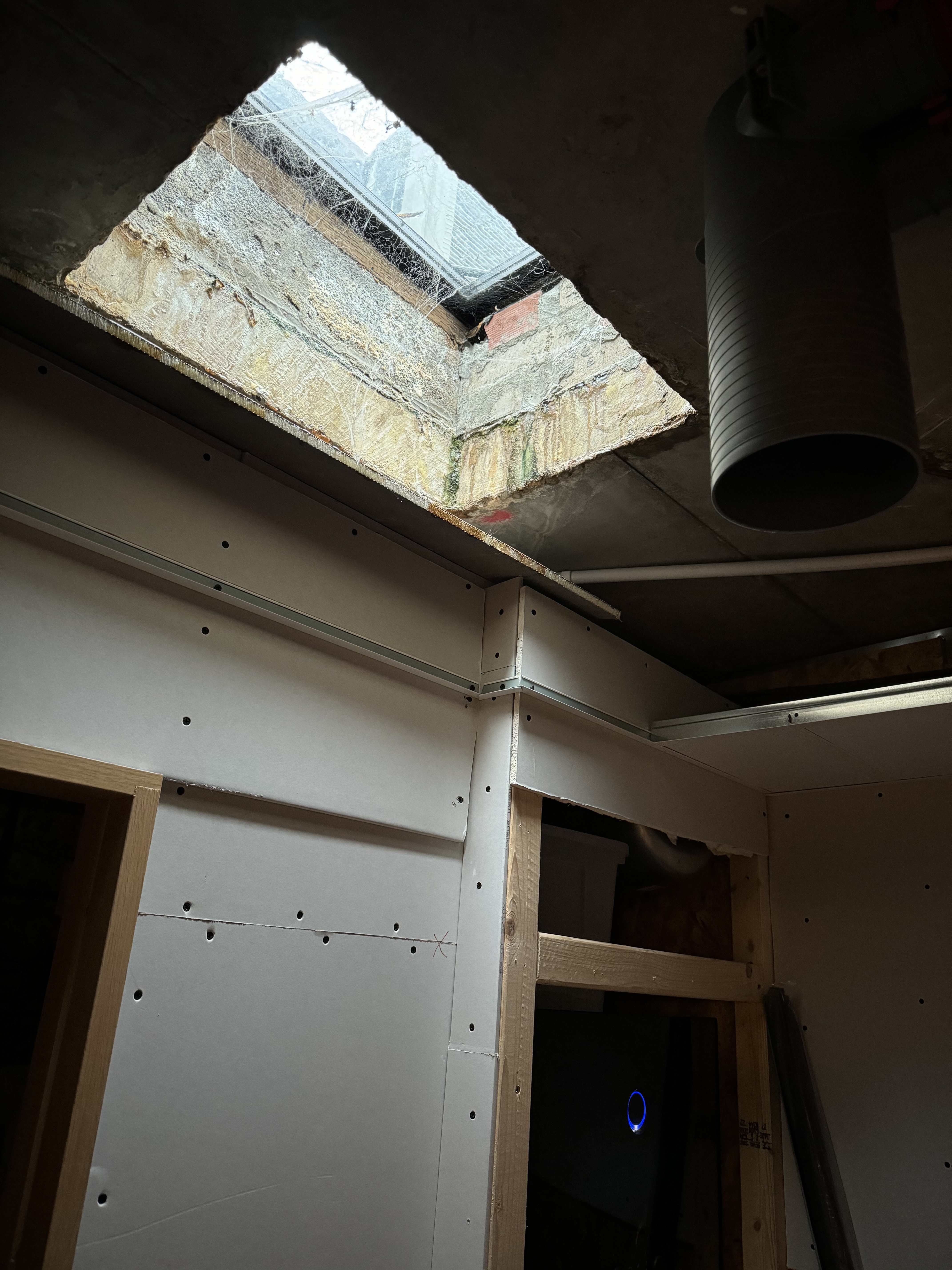

Pocster Posted November 24, 2024 Author Share Posted November 24, 2024 The 2nd photo is a sky light just outside the electrics cabinet . New line of water tracking in its direction !!! . So I wedged some membrane up with a fall to at least direct any drops outside the electrics room …. 1 Link to comment Share on other sites More sharing options...

Pocster Posted November 24, 2024 Author Share Posted November 24, 2024 2 minutes ago, joe90 said: Really difficult to suggest a solution but might a little dam of silicone bead to stop the water tracking where you don’t want it then it should drip into a container or somewhere it won’t cause trouble. emoji was not meant to be sad but “what the feck do you do?” Yeah I have in strategic spots where maybe a water track line crosses a pipe - put a zip tie on it to help limit it . Seems to work sometimes. It’s the Lightwells I’m unsure what to do with . Need to have water drip into some kind of channel around them that direct the water into a membrane . Not an easy thing … Link to comment Share on other sites More sharing options...

joe90 Posted November 24, 2024 Share Posted November 24, 2024 I made some small guttering for a little outhouse here made from 32mm drainage pipe cut in half and glue gunned together, or a funnel glued there with a pipe attached 🤷♂️ 1 Link to comment Share on other sites More sharing options...

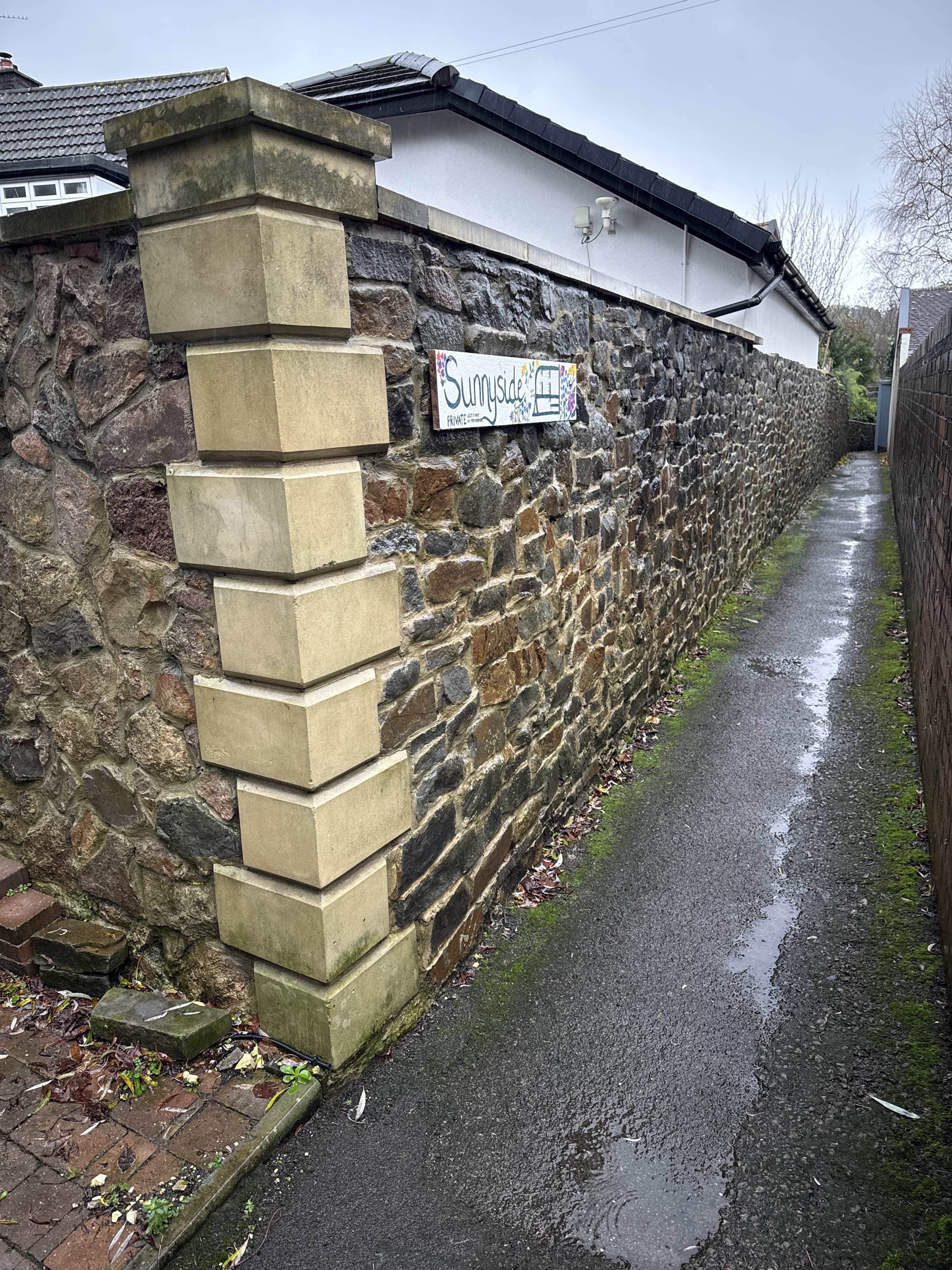

Pocster Posted November 24, 2024 Author Share Posted November 24, 2024 Just now, SteamyTea said: How about some pictures of the outside. So here’s the wall which I’m 100% certain is the issue . Leak is somewhere below the base of it I.e concrete slab below there . But even when I dig that up - fill what I can - it’s no guarantee of a fix . 1st glazing unit is approx 1m to the left inside wall . Link to comment Share on other sites More sharing options...

Pocster Posted November 24, 2024 Author Share Posted November 24, 2024 1 minute ago, joe90 said: I made some small guttering for a little outhouse here made from 32mm drainage pipe cut in half and glue gunned together, or a funnel glued there with a pipe attached 🤷♂️ Yeah I’m thinking that kind of thing . But it’s how I ‘fix’ it to the membrane for a waterproof connection. Think I need to make something under the larger glazing ( easier access ) and simply use the professional approach of trial and error ! Link to comment Share on other sites More sharing options...

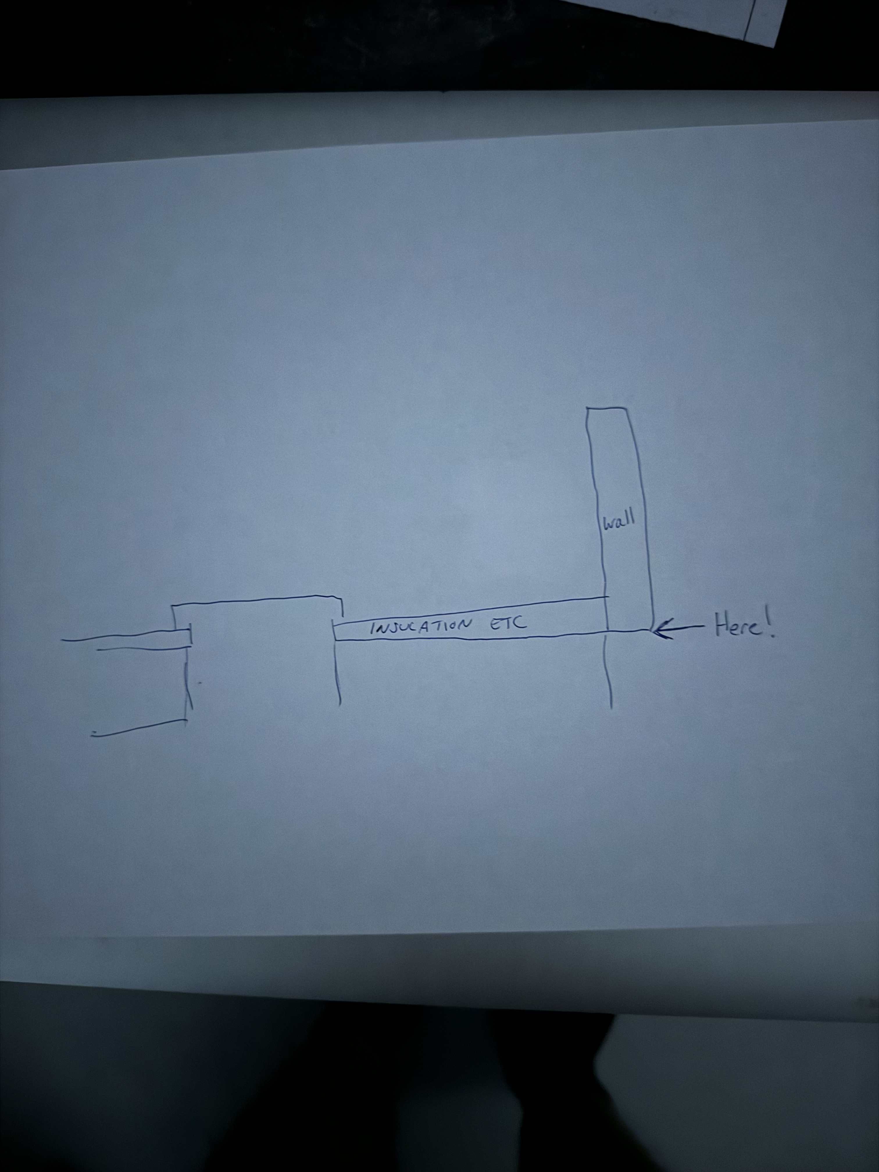

Pocster Posted November 24, 2024 Author Share Posted November 24, 2024 (edited) 6 minutes ago, joe90 said: Ground will always be damp, DPC needs to be continuous outside of any concrete. Can you dig up around the skylight and waterproof the outside of any concrete ? Thats a big “ not possible “ . There was zero dpc in the design . So that wall sits on the edge of the concrete slab . As water runs down it and goes below the ground ; I believe it’s finding gaps ( between slab and wall ) and simply running there . So I do need to dig up that edge in the lane ; presumably just go along and smear cement on the edge I.e down from wall base to over the edge of concrete slab . Edited November 24, 2024 by Pocster Link to comment Share on other sites More sharing options...
Pocster Posted November 24, 2024 Author Share Posted November 24, 2024 So just to clarify . Wall sits on edge of slab . I’m certain ‘here’ is the point the waters getting in and then running across the slab until of course it finds an exit - the Lightwell . Link to comment Share on other sites More sharing options...
Pocster Posted November 24, 2024 Author Share Posted November 24, 2024 I know I need to dig up along that lane . But on a blustery wet Sunday decided to look at the drips and procrastinate . Link to comment Share on other sites More sharing options...
Kelvin Posted November 24, 2024 Share Posted November 24, 2024 I know you’re sure where it’s coming from but have you proved it to yourself by using a hose on the window side to see if water comes in or not? Link to comment Share on other sites More sharing options...
Pocster Posted November 24, 2024 Author Share Posted November 24, 2024 (edited) 26 minutes ago, Kelvin said: I know you’re sure where it’s coming from but have you proved it to yourself by using a hose on the window side to see if water comes in or not? Yes . Zero leaks if I do that . Look at photos you can see water line is on concrete slab - none coming through above I.e upstand etc . Edited November 24, 2024 by Pocster Link to comment Share on other sites More sharing options...

Eric Posted November 24, 2024 Share Posted November 24, 2024 Is that water on the bricks above the slab? Marked on the photo. 1 Link to comment Share on other sites More sharing options...
