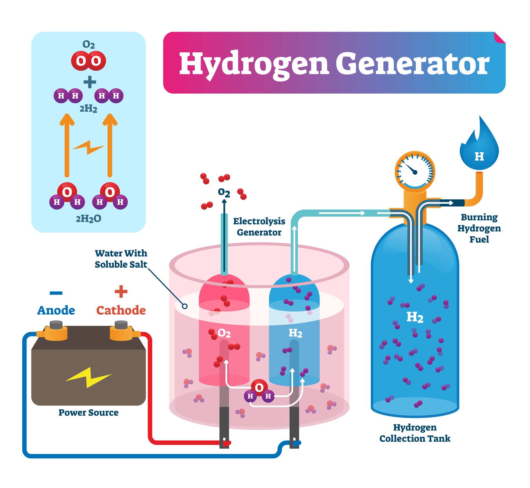

SteamyTea Posted November 29, 2024 Share Posted November 29, 2024 On 29/11/2024 at 16:03, JohnMo said: Easy, we pay wind farms to shut down production already. So the cost wouldn't be high. Instead of switching wind turbine power off, you provide a dump and generate hydrogen from the excess electric dumped Expand Not as simple as power, a couple of wires and a bucket of water. Link to comment Share on other sites More sharing options...
JohnMo Posted November 29, 2024 Author Share Posted November 29, 2024 On 29/11/2024 at 16:10, SteamyTea said: Not as simple as power, a couple of wires and a bucket of water. Expand But not a lot more difficult Most the major wind generation is offshore, so surrounded with water. Link to comment Share on other sites More sharing options...

SteamyTea Posted November 29, 2024 Share Posted November 29, 2024 On 29/11/2024 at 16:16, JohnMo said: Most the major wind generation is offshore, so surrounded with water. Expand A hydrogen generator is a fuel cell, so expensive metals and an ion exchange membrane. Then it needs pure, deionised water. Then water vapour needs removing from the gas. Then compressing. Then cooling. Then transfering into suitable containers at 700 psi. Then transporting. It is not like a school science lesson, that just heats the water up and releases tiny amounts of gases. 1 Link to comment Share on other sites More sharing options...
