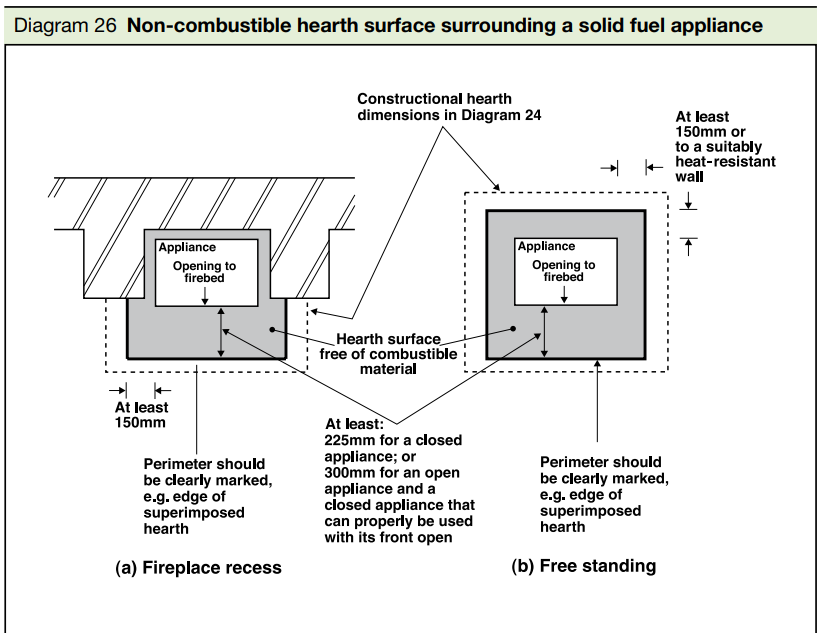

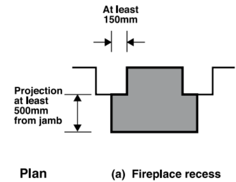

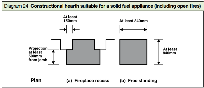

benben5555 Posted 13 hours ago Share Posted 13 hours ago Hi, Bit confused about the required depth of the hearth in front of the log burner. There are two diagrams in Part J and I'm not sure which one to follow. It will be in a 'fake' chimney breast which is 420mm deep. Any help much appreciated. Thanks Link to comment Share on other sites More sharing options...
ProDave Posted 13 hours ago Share Posted 13 hours ago It's quite clear, the hearth in all cases should extend at least 225mm in front of the stove for a closed appliance (which I assume this is) How deep it is overall depends on the dimensions of the stove and how close it can go to surrounding walls. Link to comment Share on other sites More sharing options...

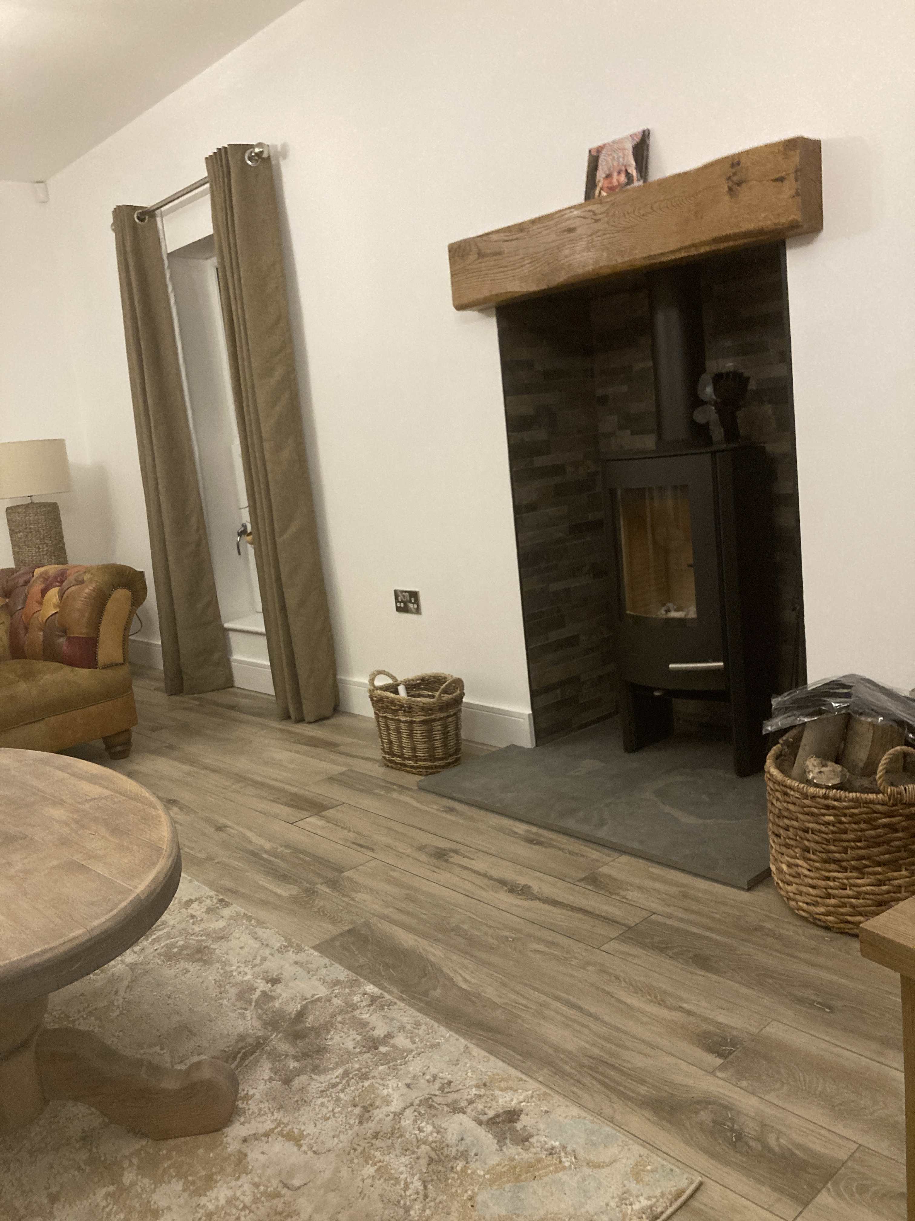

nod Posted 12 hours ago Share Posted 12 hours ago I’ve just done ours and come out 400 from the skirtings 1 Link to comment Share on other sites More sharing options...
benben5555 Posted 12 hours ago Author Share Posted 12 hours ago 17 minutes ago, ProDave said: It's quite clear, the hearth in all cases should extend at least 225mm in front of the stove for a closed appliance (which I assume this is) How deep it is overall depends on the dimensions of the stove and how close it can go to surrounding walls. Its not clear to me unfortunately! What is the meaning of this bit where it says 500mm Link to comment Share on other sites More sharing options...
nod Posted 12 hours ago Share Posted 12 hours ago Our previous hearth came out half the distance of this one Around 200 Which was suppled and installed by the stove shop and Hettas certified by them So the diagrams probably just a guide BC will only be interested in the cert Link to comment Share on other sites More sharing options...
dpmiller Posted 32 minutes ago Share Posted 32 minutes ago the constructional hearth is not the finished visible surface. Link to comment Share on other sites More sharing options...
