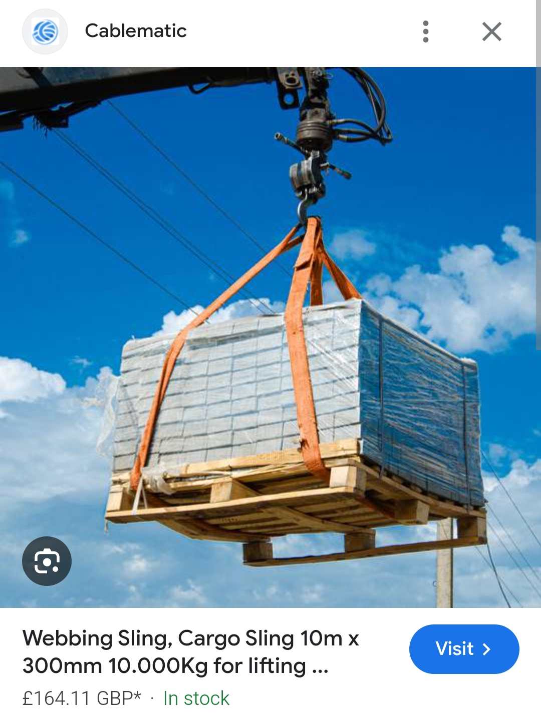

You can sling pallets with two straps and a hook too.
Screenshot_2024-11-19-19-09-45-600_com.android.chrome-edit.thumb.jpg.3cf0a6e306b506ae9e34494d9649bb19.jpg
Beware though the pallets have no SWL in this config and it can be hard on the straps. If you're careful it'll be a cheap way to move stuff though.

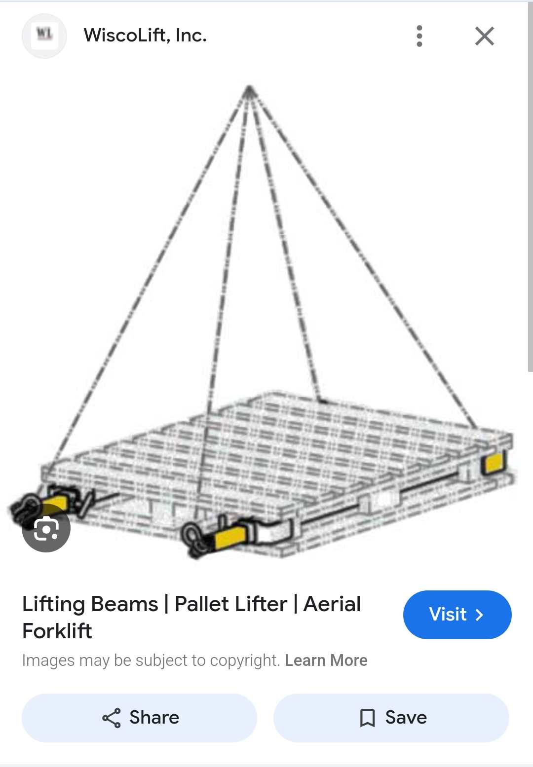

Screenshot_2024-11-19-19-18-58-996_com.android.chrome-edit.thumb.jpg.be7e96b95c0442f777ea96b1f57d0e4b.jpg
These are what you should really use in that situation.
