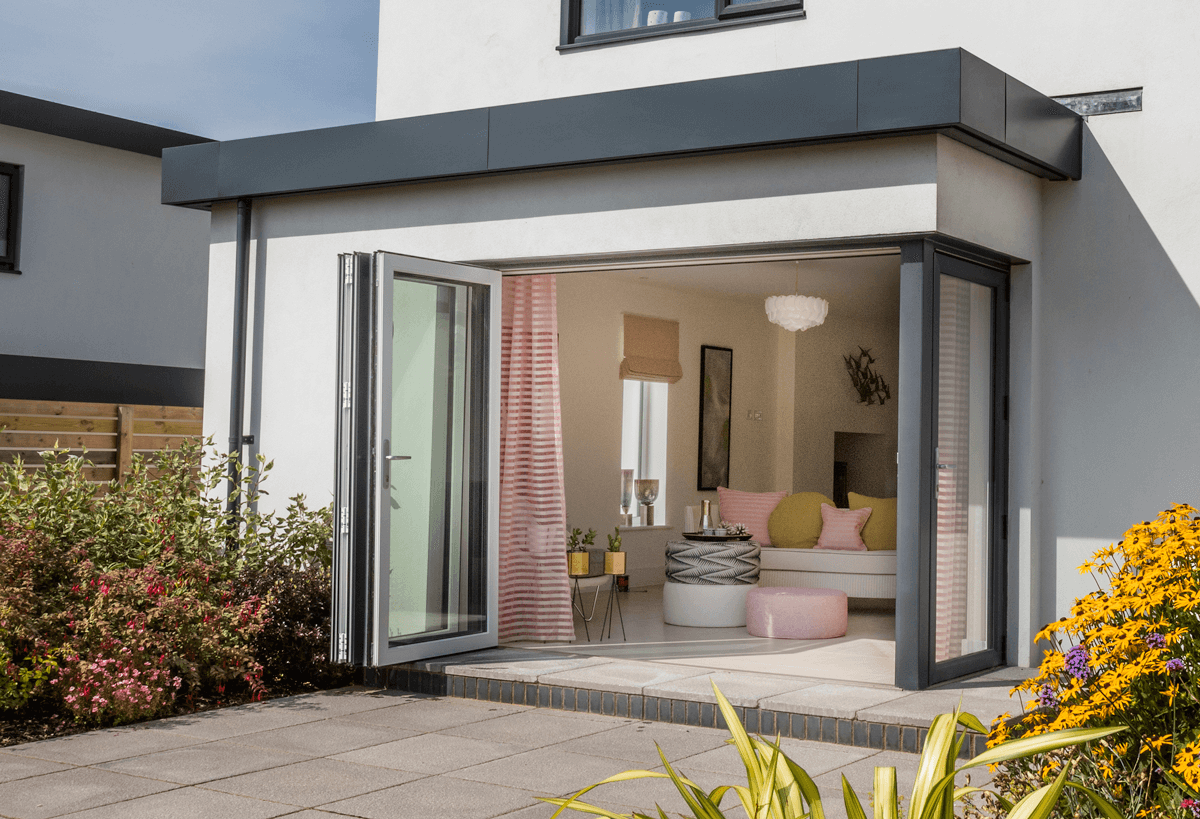

tvrulesme Posted November 19, 2024 Share Posted November 19, 2024 I'm in the process of building an extension with a flat roof. Looking to recreate a metal fascia/soffit like the picture below. My google searches have been a little unsuccessful. Most of the fascia's I find are designed for pictched roofs. Would I be looking for off-the shelf fascia/soffits or are these usually something you get fabricated? What should I be searching for? Fascia, soffit, overhang, coping or something else? I'm still in the design phase so would be easy for me to adjust the depths etc of the timber the metal face will be attached to if that saves money on bespoke. Link to comment Share on other sites More sharing options...

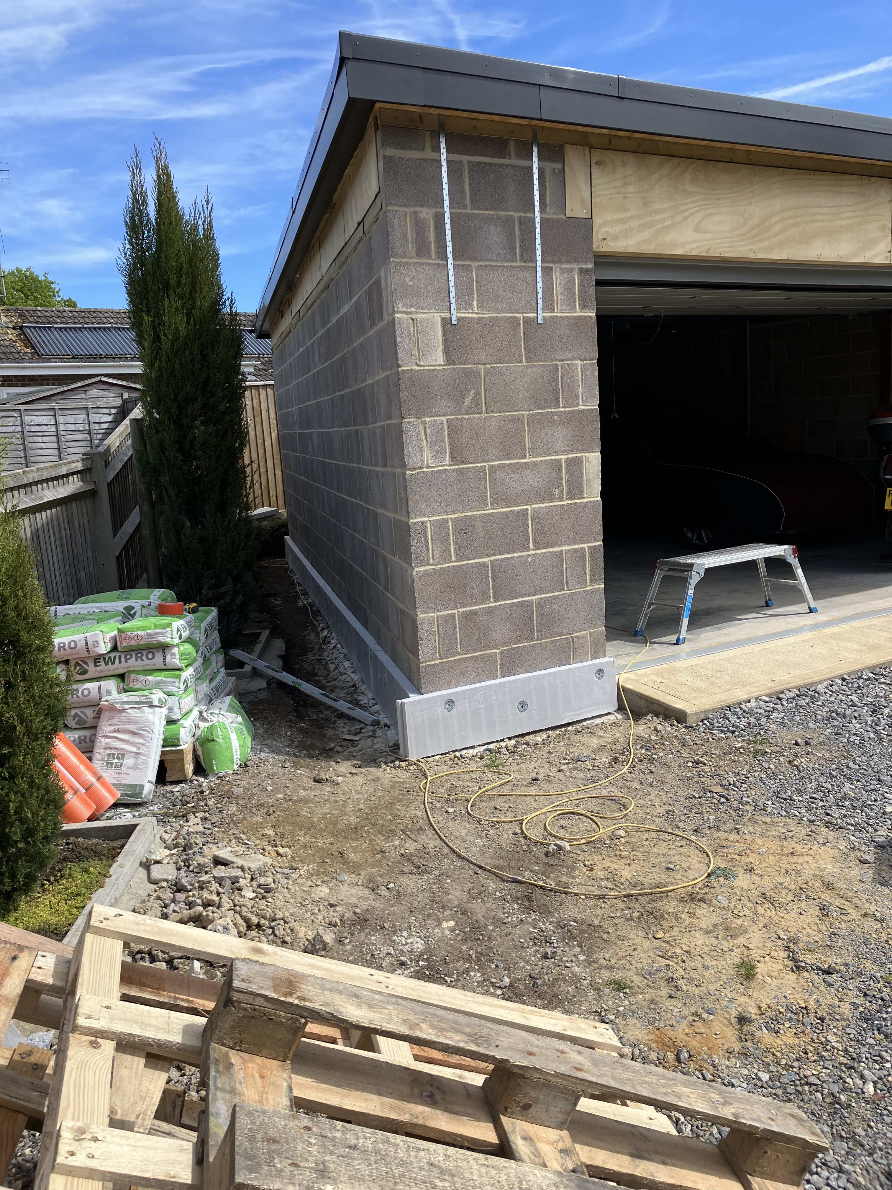

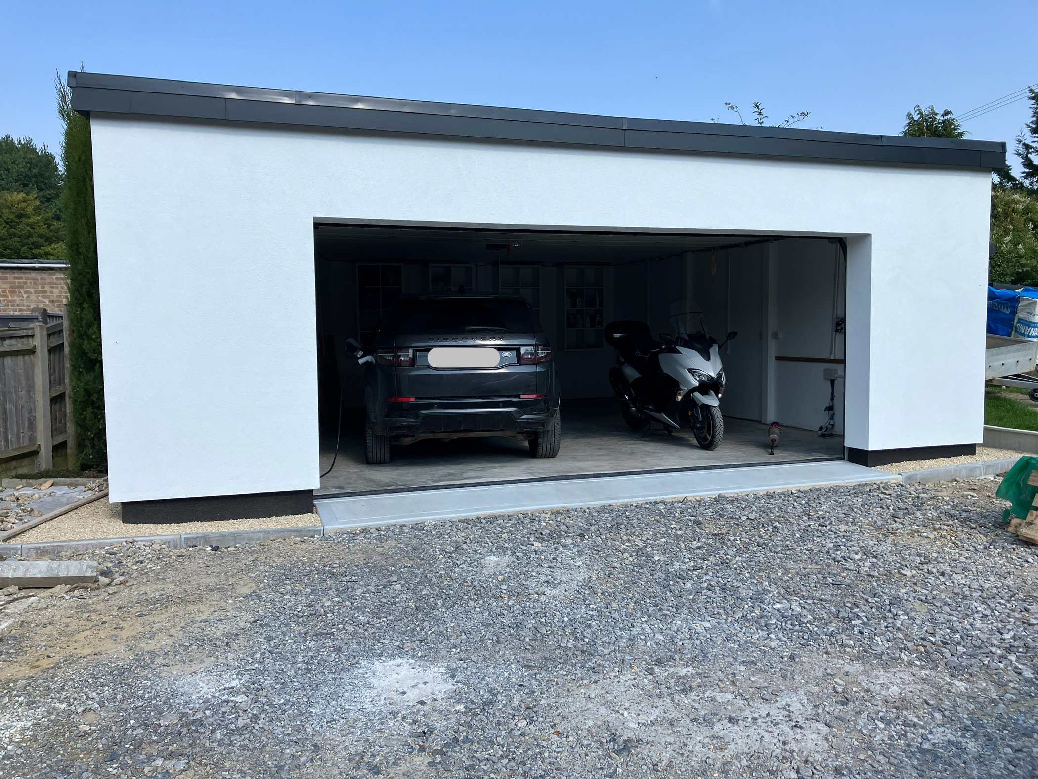

Russdl Posted November 19, 2024 Share Posted November 19, 2024 I got a local metal fabricator to make some for me for my garage roof. I screwed up though as we have an EPDM roof which is finished off with a PVC trim piece. I should have had the metal fascia the full height of the roof fascia with the PVC trim over the top of the metal but I stopped the metal short, pretty much level with the base of the PVC trim and it looks a bit rough. I’ll draw a picture to clarify the above if you’d like. 1 Link to comment Share on other sites More sharing options...
tvrulesme Posted November 19, 2024 Author Share Posted November 19, 2024 Thanks a lot @Russdl Still looks very tidy from the pictures but I get what you mean. I'd like to get metal capping to match ideally. How did they fabricate the joints? Is it just a overlapping piece or did they do something special? Link to comment Share on other sites More sharing options...

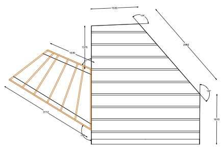

Russdl Posted November 19, 2024 Share Posted November 19, 2024 The corner pieces overlap the straight fascia bits. One of the reasons I had them locally fabricated is that the corner in the picture below is not a standard 90 degree corner but 75 degrees. I designed mine to be fixed through the soffit element (which would be hidden by the EWI) and the top of the fascia element (that would be hidden by the PVC). The hidden fixing bit worked, I’m just disappointed in the finished look - however you don’t really see it unless it’s pointed out so I should get over it eventually! 1 Link to comment Share on other sites More sharing options...
tvrulesme Posted November 19, 2024 Author Share Posted November 19, 2024 9 minutes ago, Russdl said: One of the reasons I had them locally fabricated is that the corner in the picture below is not a standard 90 degree corner but 75 degrees. Very good point. I have a lot of non-standard angles and some weird gradients to deal with. Will have a chat with some local fabricators. Link to comment Share on other sites More sharing options...
