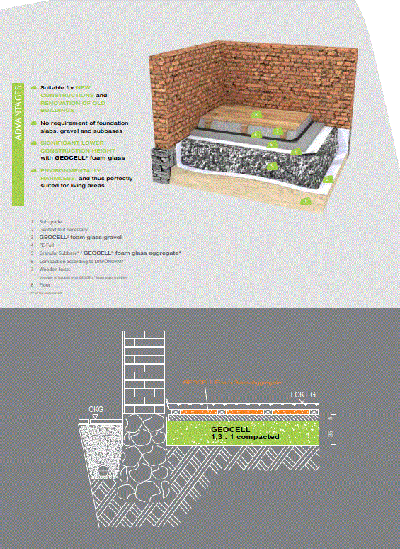

sgt_woulds Posted November 12, 2024 Posted November 12, 2024 You could try the Geocell system (from Mike Wye) - although it would mean wheelbarrowing a ton of expanded glass rubble to your back garden which might be just as hard as pumping concrete there. Is very DIY-doable though: Back to Earth also do something similar: Solid floor insulation – How to create a solid, insulated floor - Back to Earth

Roger440 Posted November 12, 2024 Posted November 12, 2024 22 minutes ago, sgt_woulds said: You could try the Geocell system (from Mike Wye) - although it would mean wheelbarrowing a ton of expanded glass rubble to your back garden which might be just as hard as pumping concrete there. Is very DIY-doable though: Back to Earth also do something similar: Solid floor insulation – How to create a solid, insulated floor - Back to Earth Foamed glass is easy to move as it weighs next to nothing.
sgt_woulds Posted November 12, 2024 Posted November 12, 2024 Says a man who has never done it ! 🙂 Try shovelling 2 1/2 tons of it into wheelbarrows and making what feels like the equivalent of a round trip to the sun backwards and forwards! Geocell binds together making it incredibly hard to get a shovel in, (had to use a shallow frying pan in the end) - moving it was the hardest physical thing I've ever done. I'm saying this as an ex-roofer used to shifting tons of slates up onto a scaffold 'cos the boss was a tight old so-and-so who wouldn't pay for a Bumpa. Other than that, yes it's lovely and light...
