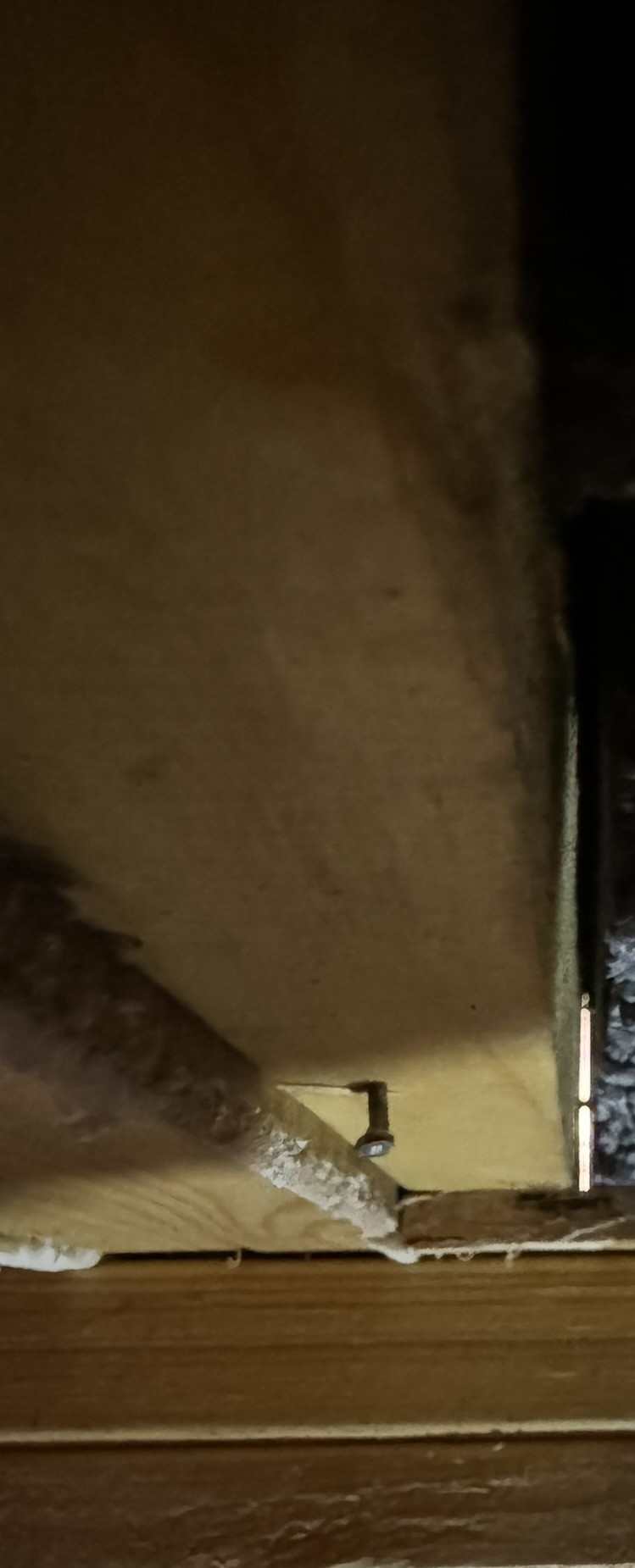

ProDave Posted October 24, 2025 Posted October 24, 2025 On 30/08/2025 at 17:08, G and J said: A minor but pertinent example is our MVHR ducts. We have a flat roof bit with a steel in the way of ducts for two supply terminals. I asked them to design in holes for the ducts in the steel. They did that. They also went one further, without being asked, and designed the holes to coincide with gaps in the metal web joists and spaces in the flat roof design. Holes in steels is an important one. One house I wired the designer had specified several holes in the steels, but then installed one steel was installed backwards, so most of the holes were at the wrong end, leaving just 2 useful holes in the beam separating 2 ends of the house for me and the plumber to fight for to route our cables and pipes. If only someone had read the drawings and checked when being installed, that beam could have been put in the right way round.
saveasteading Posted October 24, 2025 Posted October 24, 2025 2 minutes ago, ProDave said: leaving just 2 useful holes in the beam And were you expected to resolve this and make the holes? For my knowledge bank... do sparkies get taught rules of thumb about where holes should go? I know most plumbers don't, or don't care, but it's obv trickier with pipes.
ProDave Posted October 24, 2025 Posted October 24, 2025 2 minutes ago, saveasteading said: And were you expected to resolve this and make the holes? For my knowledge bank... do sparkies get taught rules of thumb about where holes should go? I know most plumbers don't, or don't care, but it's obv trickier with pipes. No we didn't make new holes in the steel, we worked with what we had. Fortunately I knew the plumber well so we could decide what had to go through the steel, i.e. how tap pipes as runs needed to be short and some high load cables for the same reason. I routed a lot of the smaller and less demanding cables via a longer route to avoid the steel. The point of my post was if only someone noticed while the crane was there installing the beam and got it put in the right way, it would have been a lot easier. Or just drill a row of holes all along it at manufacture so it would not have mattered. I do know about where and how big to drill holes in joists but this I learned from self building. As is evident looking at any older house most trades are not routinely told this.
SteamyTea Posted October 24, 2025 Posted October 24, 2025 1 hour ago, saveasteading said: For my knowledge bank... do sparkies get taught rules of thumb about where holes should go? I know most plumbers don't, or don't care, but it's obv trickier with pipes I seem to remember that they do get taught it if they do a proper Level 3 apprenticeship. We were taught it on our Part P (limited scope) and that was specially designed for plumbers, PV installers, HVAC etc. Steico do this useful guide. Site_Guide_A6_online.pdf It is wrong that technicians, from other trades, should be making decisions about structural elements. We would not expect a painter (which has Level 3 qualifications) to be making changes to structures.
saveasteading Posted October 24, 2025 Posted October 24, 2025 9 minutes ago, SteamyTea said: making decisions about structural elements. But in reality, we know a plumber will generally notch a hole in a joist rather than ask. So it's good to hear that some know the principles.
SteamyTea Posted October 24, 2025 Posted October 24, 2025 58 minutes ago, saveasteading said: But in reality, we know a plumber will generally notch a hole in a joist rather than ask. So it's good to hear that some know the principles. It is, generally, not the ones that know we need to worry about. I work with some completely uneducated numptie, if they get away with something just once, that becomes policy, regardless of how often it has failed before or after. 1
