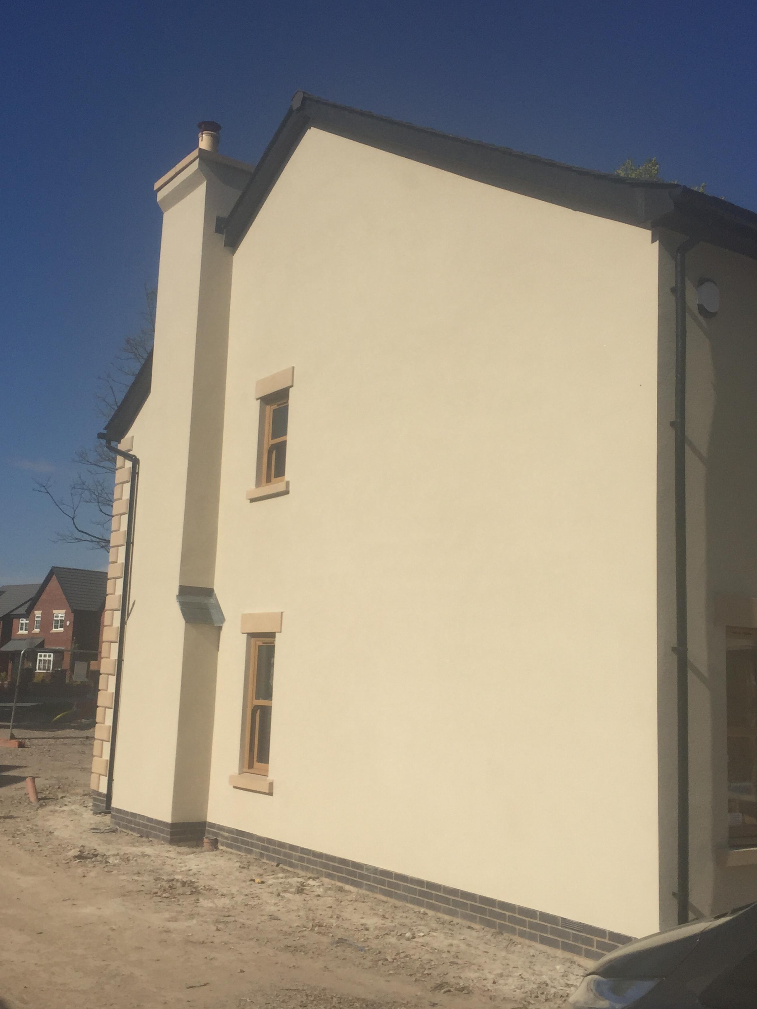

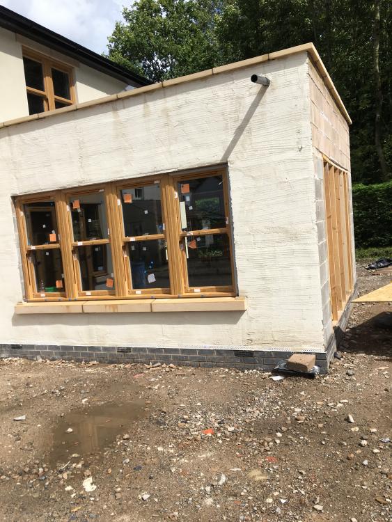

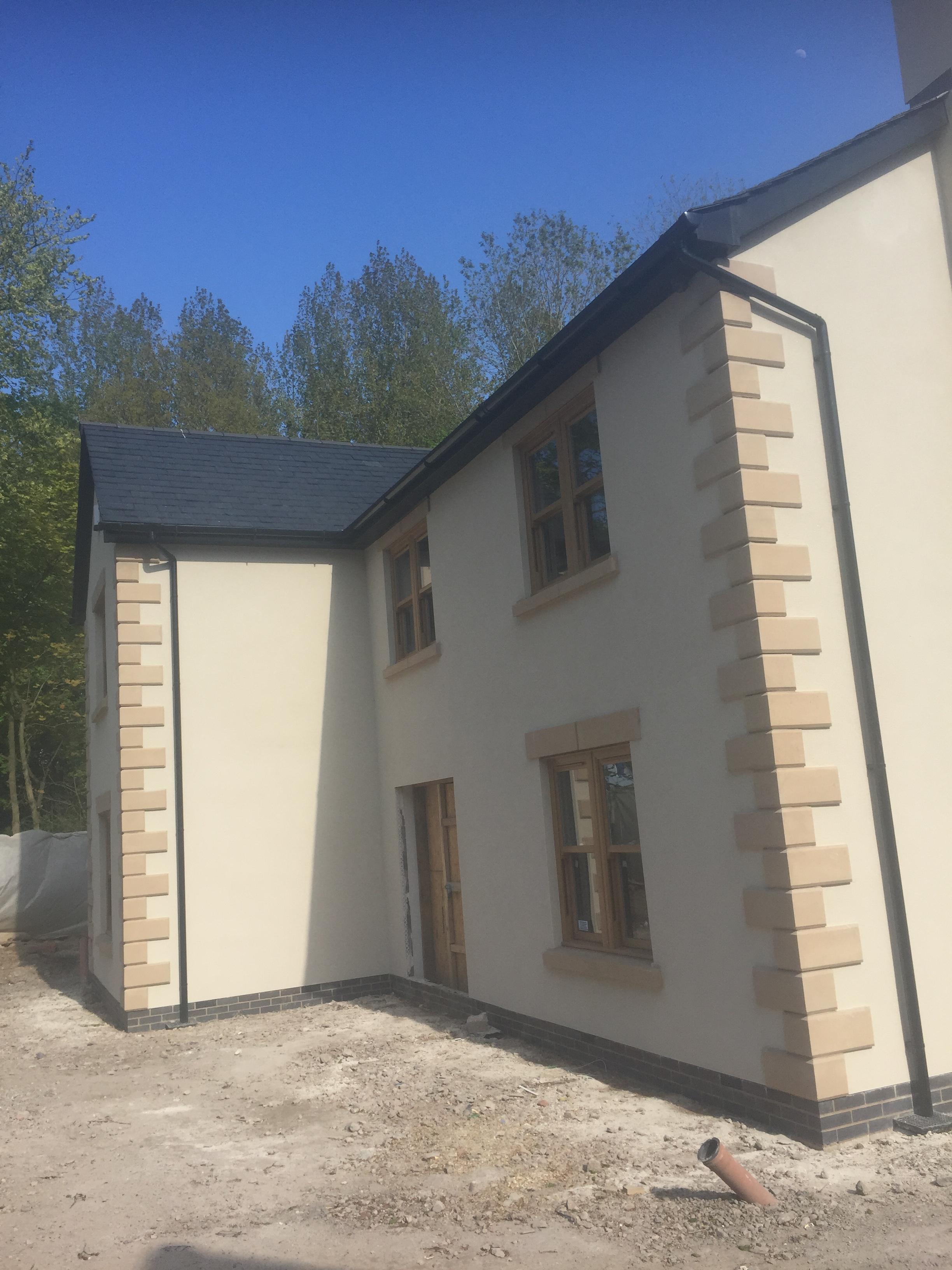

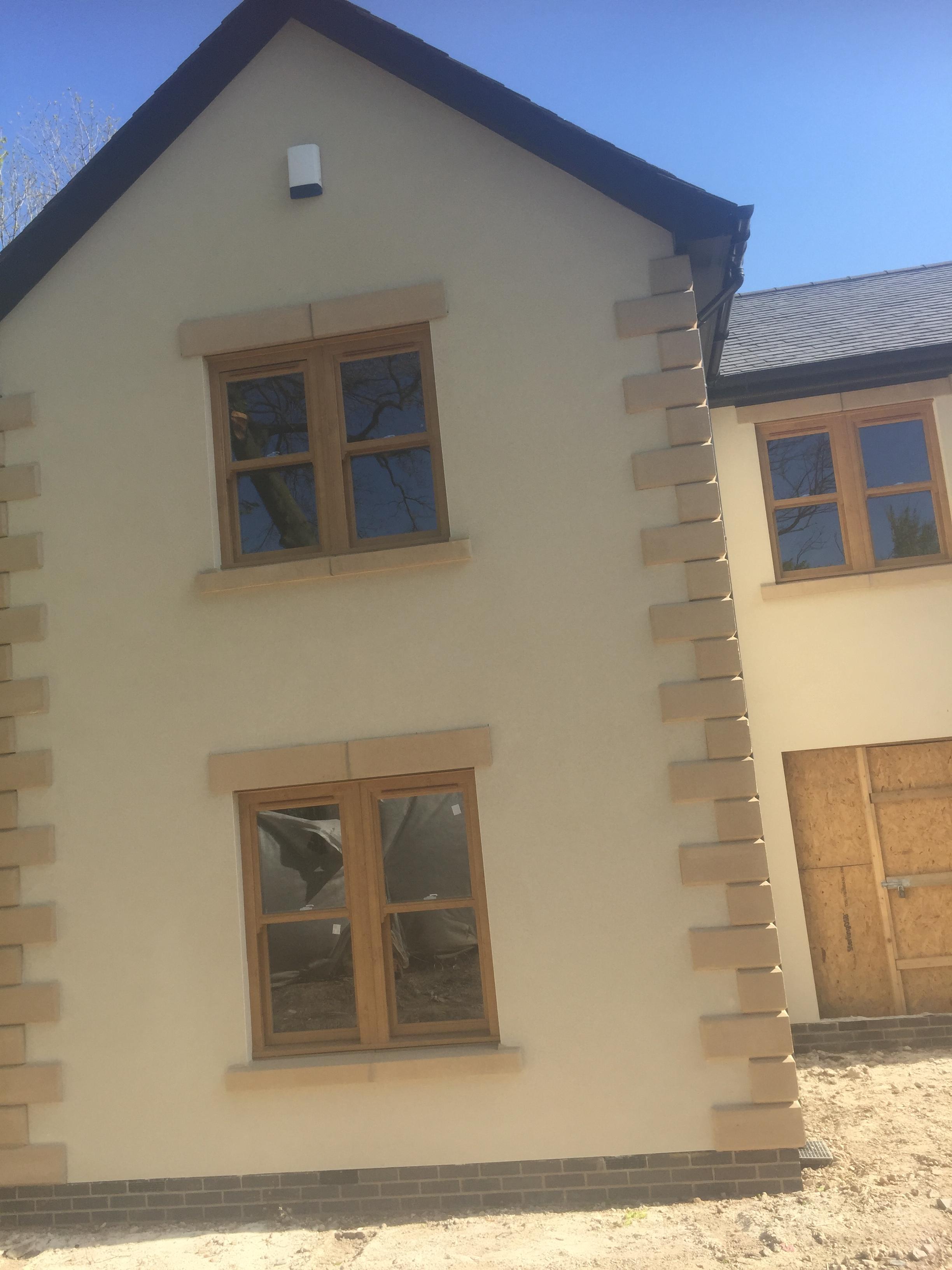

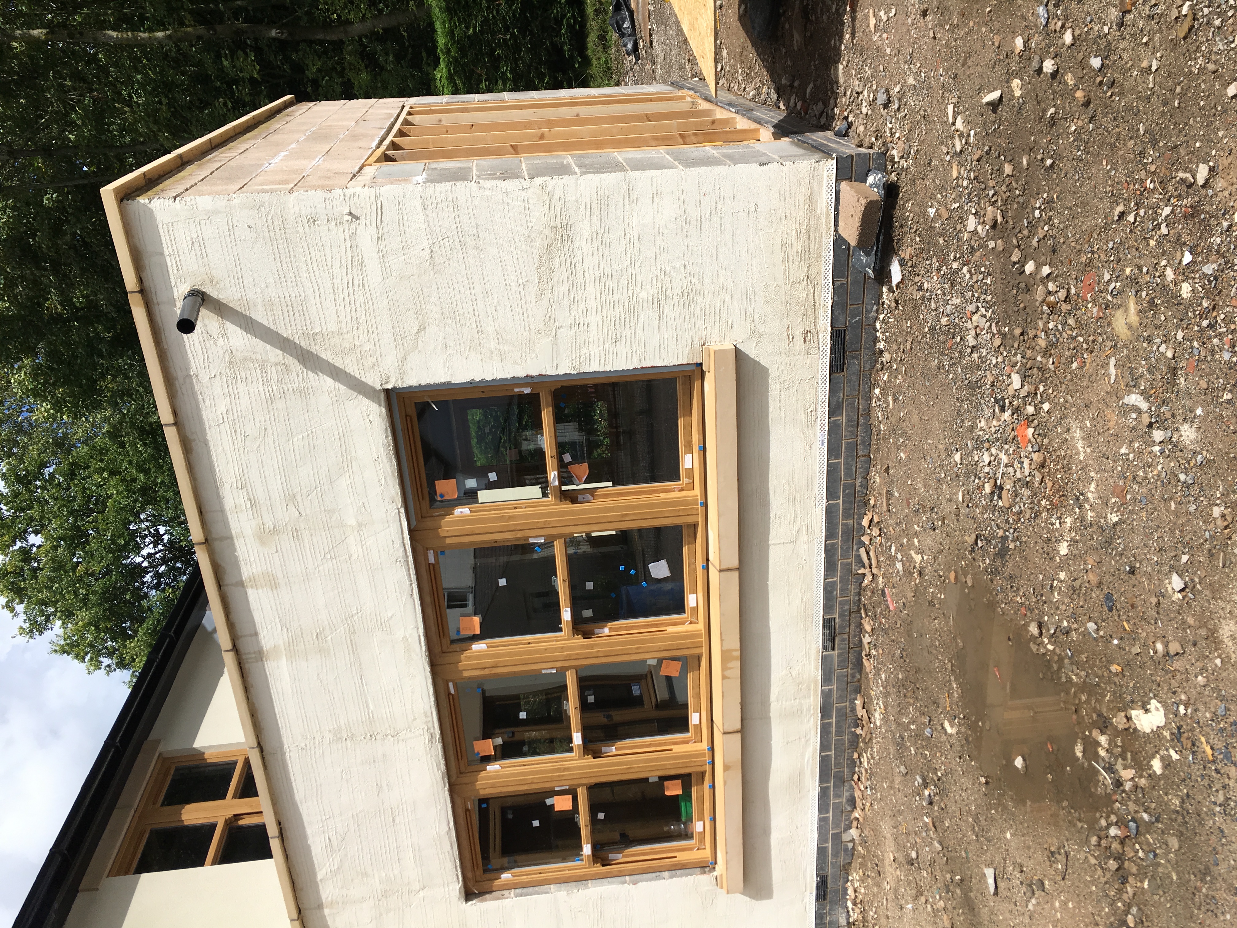

nod Posted November 14, 2017 Posted November 14, 2017 3 hours ago, Pete said: Just interested to see what people have paid for their exterior render as some quotes seem extortionate. Our system will be a thin coat fully embedded mesh onto a render board. TIA Don’t go too cheap I've been doing these type of render systems for over thirty years We are not particularly expensive But have been undercut by as much as 50 % on some jobs Dave is very near the mark with a £100 per sq mtr you're going to be looking at it for a long time This is the house that I’m self building. Two of us, four and half days applying two coats of k rend 300 bags Last March 3
