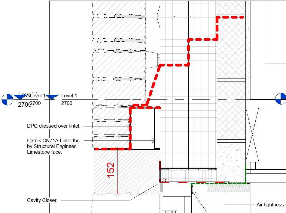

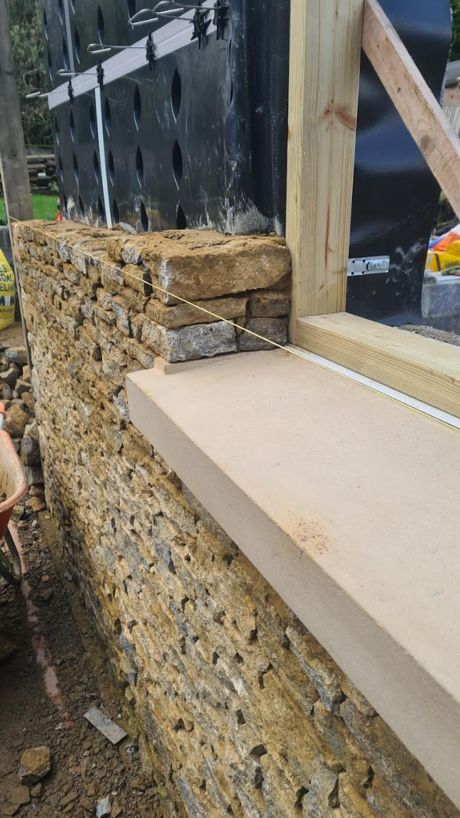

GEO-PAR Posted October 20, 2024 Posted October 20, 2024 (edited) I need to order my stone cills and lintels asap but getting cold feet on how I planned to do it. Interested to know what others think - Whether I'm being a little mad or if it will be okay? My intention was to have a natural limestone lintel self supporting. I only wanted it to bear onto the stone walls either side by 50mm (for visual reasons) but now questioning if that's enough. I'll then stick a Catnik CN71A (or similar) above it with a 10mm gap for deflection (so the steel doesn't crack the stone if it deflects). This steel will have your typical 150 bearing each side. I want to keep this above the limestone lintel so when you look up at the window, you don't see any steelwork. Edited October 20, 2024 by GEO-PAR
nod Posted October 20, 2024 Posted October 20, 2024 Why don’t you just sit the stone lintel in a catnic 2
scottishjohn Posted October 20, 2024 Posted October 20, 2024 If you do not use a catnic with inset limestone then a lintel will need to be at least 150mm into wall each side and thick you will need to be very specific on size with stone supplier if you want to set a one piece one in wioth planty of clearance to fit it in as the steek defllects does not need to be thick as its just for show Is this a new build or extension on exsisting stone building
scottishjohn Posted October 20, 2024 Posted October 20, 2024 3 hours ago, GEO-PAR said: 10mm gap for deflection 19mm would be normal gap for bedding it --so maybe a bit more clearance you need to knpw the deflection to work out how big gap for bedding you will need,so it looks right

Mr Punter Posted October 20, 2024 Posted October 20, 2024 With just 50mm end bearing I think the stone lintel will look wrong. Go with 150mm minimum.
GEO-PAR Posted October 20, 2024 Author Posted October 20, 2024 6 minutes ago, Mr Punter said: With just 50mm end bearing I think the stone lintel will look wrong. Go with 150mm minimum. Yeah I think I'm going to boost it up to at least 100 if not 150 like you suggest. I found this picture where the bearing looks about 50mm, but it's granite so being a harder stone, I guess this makes it possible
scottishjohn Posted October 20, 2024 Posted October 20, 2024 8 minutes ago, GEO-PAR said: Yeah I think I'm going to boost it up to at least 100 if not 150 like you suggest. I found this picture where the bearing looks about 50mm, but it's granite so being a harder stone, I guess this makes it possible still wrong , thelintel will be ok buy could crush those small bits under it

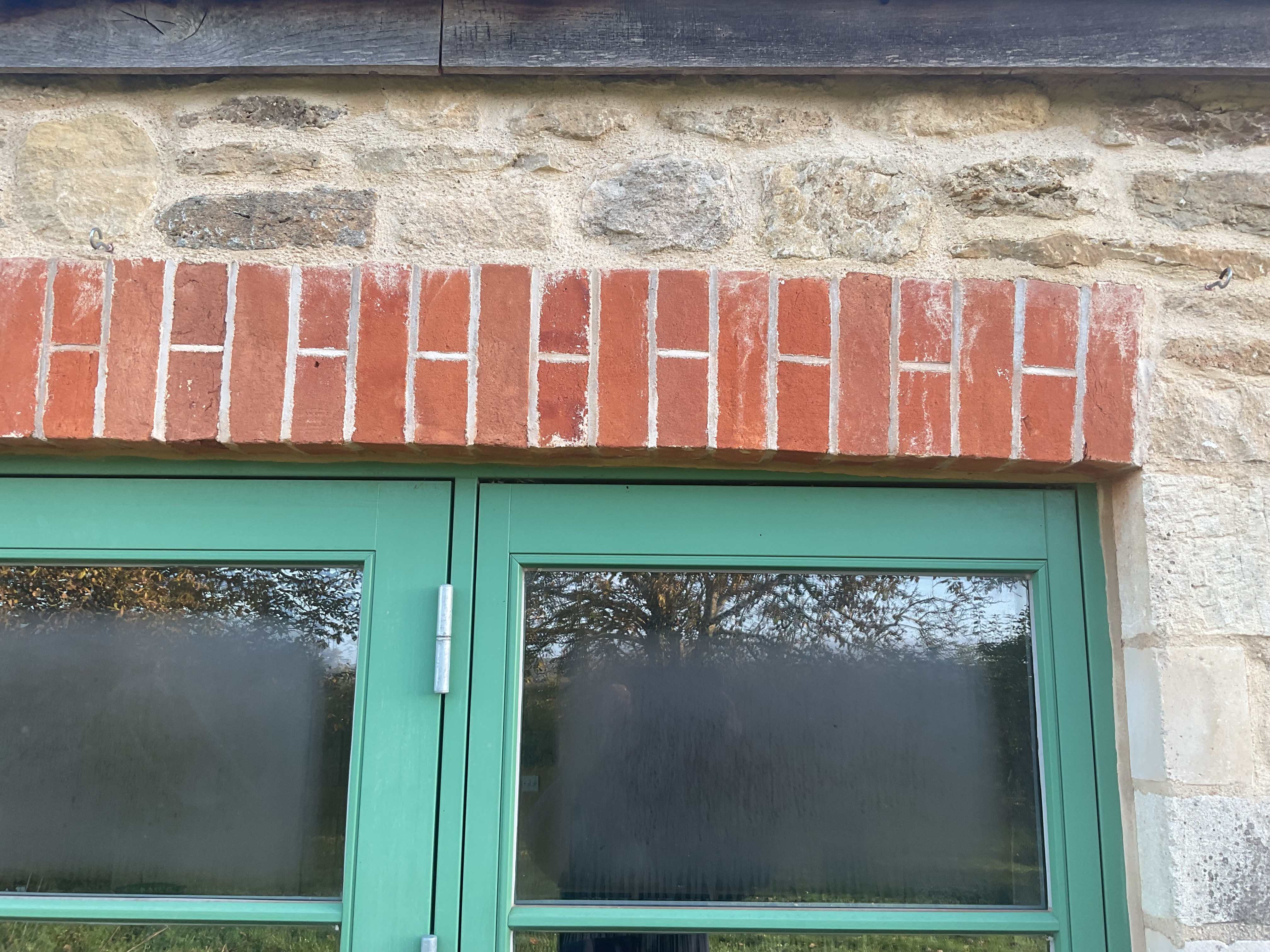

jfb Posted October 23, 2024 Posted October 23, 2024 Can you not cut a slot in the back of the stone lintel to fully cover the catnic? pretty sure that was what we did for our French doors (though we had an external steel beam not a catnic and were using bricks to finish) 1

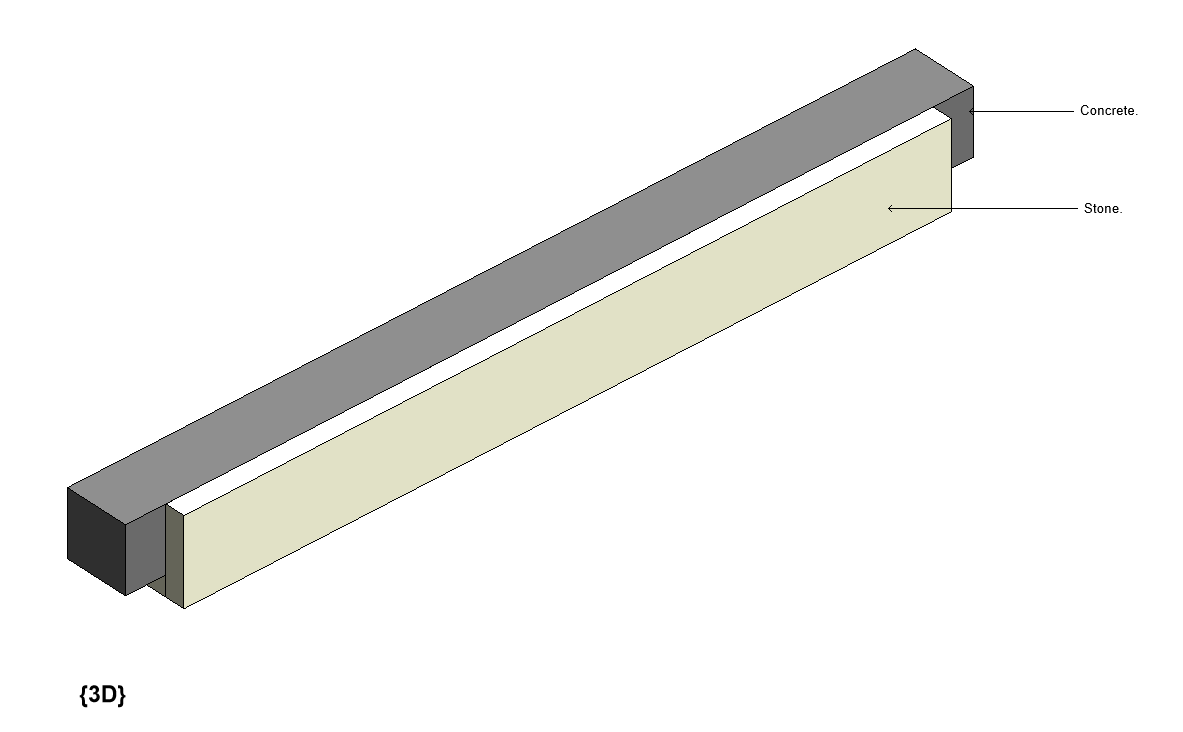

GEO-PAR Posted November 6, 2024 Author Posted November 6, 2024 (edited) Sorry - Didn't see these additional comments until now. I'm attempting to go down the precast route... 50mm stone veneer to the front and underside (using the joint to form a drip detail) pinned into a reinforced concrete lintel. This way the stone will only need to oversail the opening by 50mm and the concrete can oversail by the typical 150mm. Just exploring the option not so not sure how expensive it will be. Edited November 6, 2024 by GEO-PAR
GEO-PAR Posted November 6, 2024 Author Posted November 6, 2024 On 23/10/2024 at 09:09, jfb said: Can you not cut a slot in the back of the stone lintel to fully cover the catnic? pretty sure that was what we did for our French doors (though we had an external steel beam not a catnic and were using bricks to finish) Not really sure what you mean - Are you able to sketch? Did you just cut the slot about an inch above the bottom of the brick?

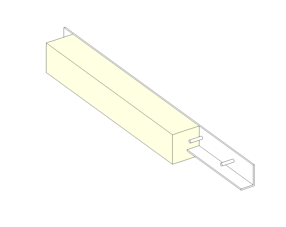

Russell griffiths Posted November 6, 2024 Posted November 6, 2024 In a former life I was a bricklayer, I remember doing a job to clad a concrete car park in brick, the brick continued over the openings in a soldier course. there was no catnic lintel instead a very thick 10-12mm stainless steel angle was used, this was bolted back to the concrete structure. the brick soldiers had a groove cut into them that fitted around the steel. This can probably be explained better by @Gus Potter ive recently done some stone cladding on my place and did something similar @GEO-PAR not sure if this is any help to you. large angle instead of a catnic recessed into the back of the stone. poor picture I’m afraid
jfb Posted November 7, 2024 Posted November 7, 2024 15 hours ago, GEO-PAR said: Not really sure what you mean - Are you able to sketch? Did you just cut the slot about an inch above the bottom of the brick? Correct. Though it was a little more tricky because the bricks had a slight arch to them

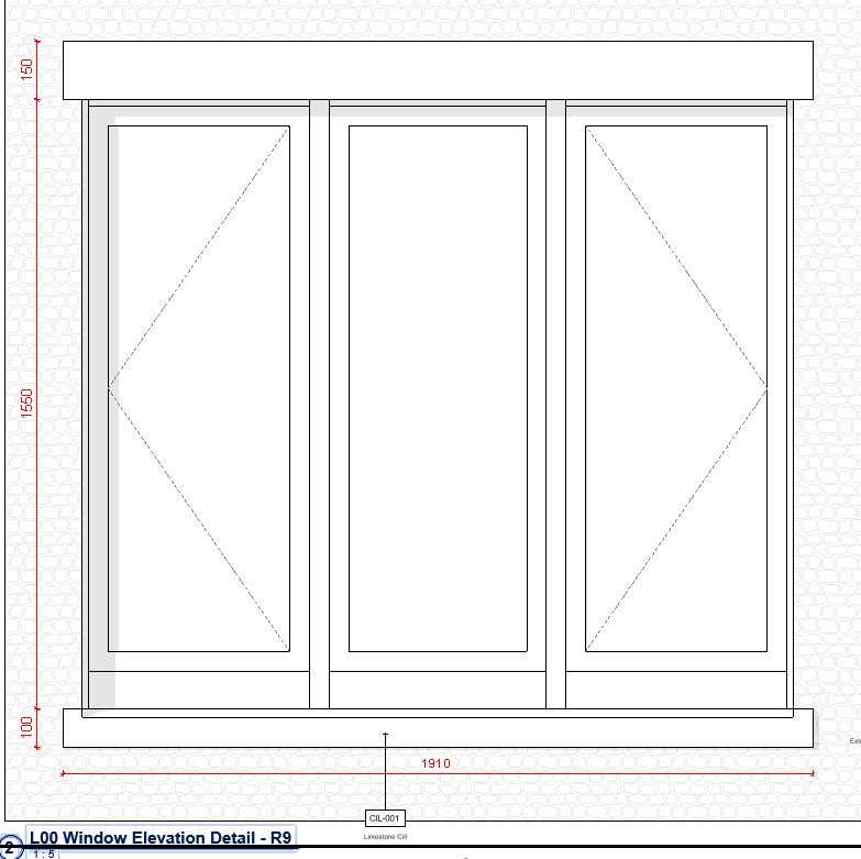

GEO-PAR Posted November 12, 2024 Author Posted November 12, 2024 Cheers for all the feedback guys. I don't know if this makes much difference to your suggestions above but my lintels are going to be chunky beasts (I want the traditional cottage look where you get very deep external reveals). For the doors, they're H210 x D325 and for the windows they're H210 x D230. I'm currently exploring two options: 01: Purchase stone in 50mm thickness to act as a veneer. There will be a joint to the underside but i'll need a drip detail anyway so I'm thinking I can obscure as the drip. We did this on a big commercial project I worked on where most of the facade was stone faced precast but we had traditional hand-set stone for the two entrances. They made timber moulds, placed the stones in the mould, and then pour concrete over the top. Unfortunately I'm too small fry for the company that did it to be interested but I have found a much smaller pre-caster that have said they'll price it up. Not 100 percent sure this is going to be the cheapest option but exploring it at the moment. It feels like the most robust option and will enable me to put lifting eyes in so I can telehandler them into position with less risk of damage to the stone. Option 02: This is based on your suggestion above: Metal angle that is cut into the stone. I'm thinking it might be a good idea to weld some rods to the angle and chem fix them to the stone to prevent any rotation or slipping (or am I over thinking / is this a bit daft?). It feels to me like this could be a much cheaper solution to be fair. Not sure what size angle I'll need for my size of lintels - Will have to ask the S.E I guess Cheers
GEO-PAR Posted November 28, 2024 Author Posted November 28, 2024 Had a quote come back on making the lintels into stone veneered pre cast - £6k! 🤦♂️ Spoke to my S.E about notching the back of the stone for a steel L Section and he thinks it won't be any different than the original method drawn at the top of this thread. He said if my steel deflects it will crack the stone regardless of whether it's notched in the back or above. He suggested instead sticking with the original plan at the top of this thread, but oversizing the steel catnik CN71A above the stone lintel (so it has like a 300mm bearing instead of 150) and keep about a 10-15mm gap above. I worry it might look a bit shit with my stone jointing being so tight but equally don't want cracked stone lintels with how much they cost! Am I over thinking this?

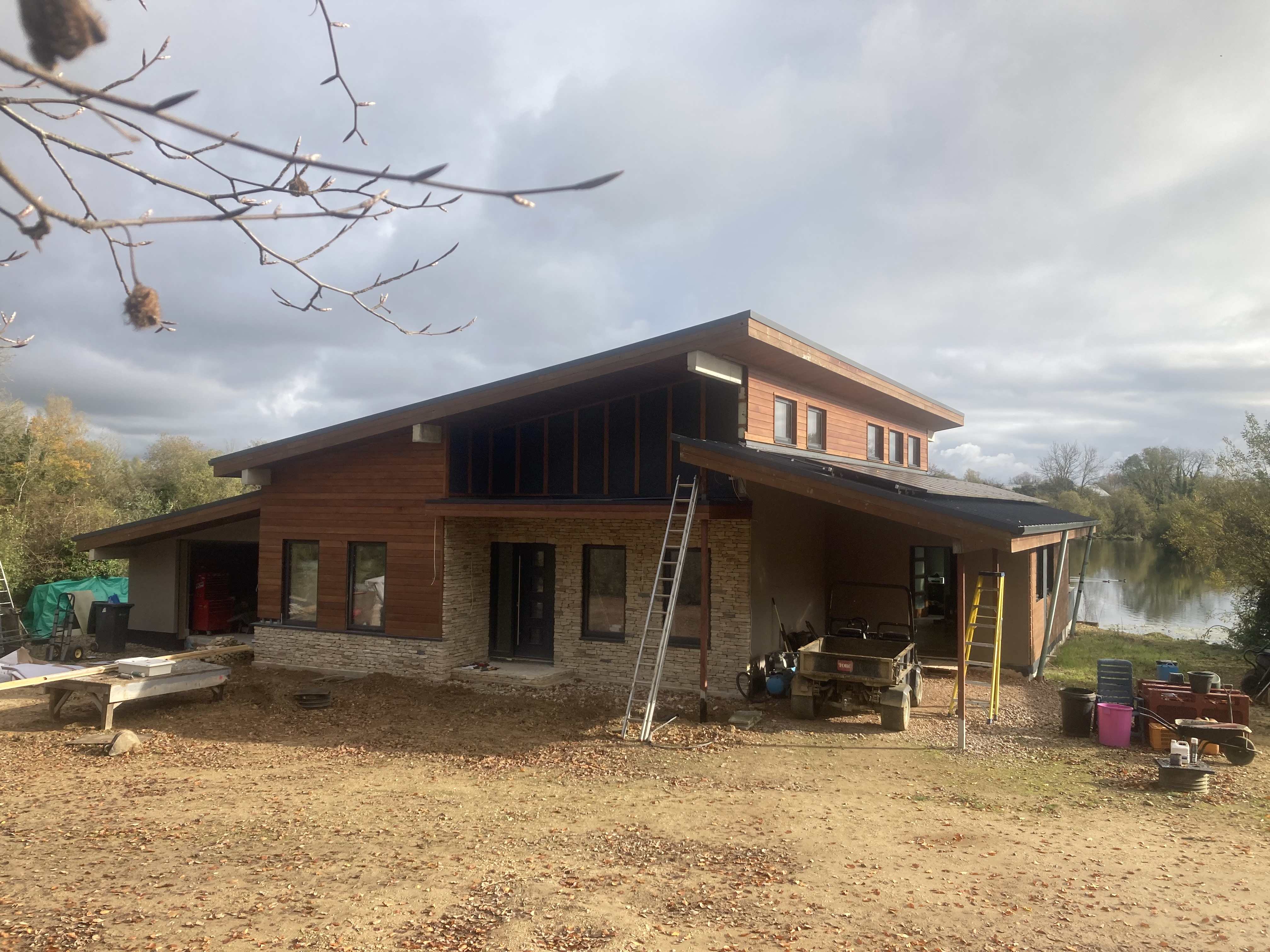

GEO-PAR Posted December 17, 2025 Author Posted December 17, 2025 For most of the lintels, I used a 200x200 bit of stone and then put a Birtly SBL200 above with a 10mm gap between the two for the Birtly to deflect. I have one huge lintel that couldn't be done in one piece of stone so I resin bolted 6 pieces to a huge box lintel. I'll try and find some photos on my phone later. 1
