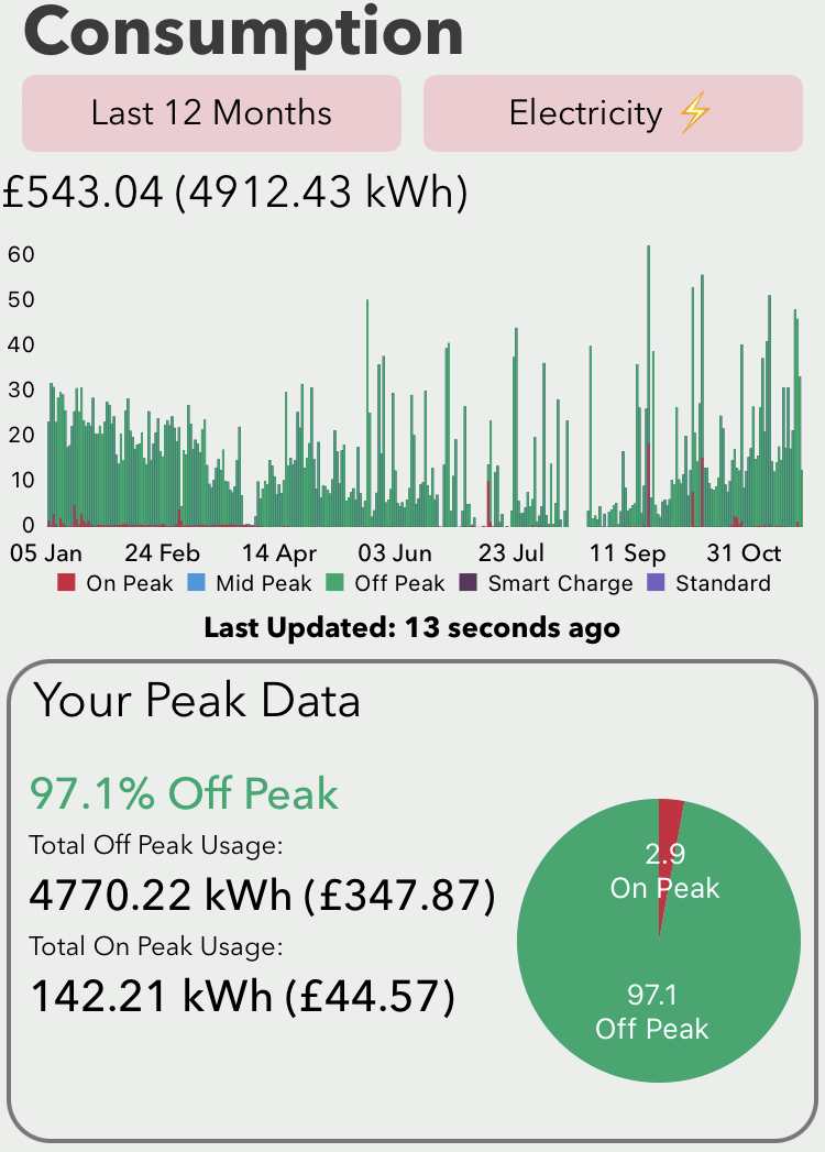

RobLe Posted December 3, 2024 Share Posted December 3, 2024 2 hours ago, Bramco said: True - and you'd need a helluva'n inverter for this but it's worth knowing what typical usage would be, so adding up the ASHP, base load etc. and also getting into the habit, if you can, of only using high usage appliances serially rather than all together. That way, it will only occasionally mean that you are drawing power from the grid at the expensive rates. We’ve never really bothered staggering loads to avoid peaks. I have however trimmed the inverter ‘zero’, and that makes a lot of difference. That is, the CT clamp feeding the inverter to tell it what the power draw is, that the inverter is trying to null, and gives a small signal that is easy to swamp with mains hum giving an offset. With most inverters this can be tweaked out such that the smart meter shows 0W or maybe slightly -ve (exporting) rather than slightly importing all the time - this simple change makes a significant difference to the daily peak import. I think I optimised this offset mid April, the pic below shows the peak consumption happening every day before that. There’s still sometimes a high daily peak import - I think that’s mostly the Ohme charging the car at odd times of the day - octo-aid doesn’t understand it’s actually octopus giving cheap hours. Link to comment Share on other sites More sharing options...
