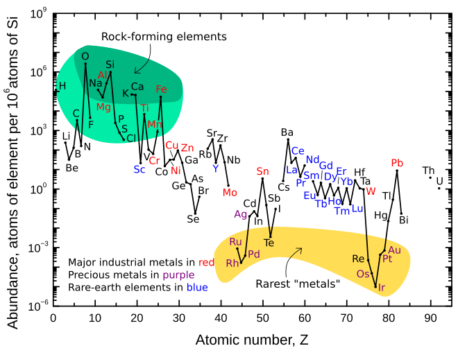

G and J Posted October 18, 2024 Share Posted October 18, 2024 So is it a good thing to evaluate battery purchase purely on financial payback? I have a nagging feeling that if we looked real hard at it all we might discover that the total number of tons of carbon who’s release into the atmosphere I’m responsible for between now and my demise will increase if I add a battery in. It might be that the world would be better served for those precious metals used in ‘my’ battery to be deployed in more electric vehicles. I’m going to cost building in the option of adding a battery in future by hubbing wiring to the key bits into my attached garage. If it’s not too much we’ll do it and thus maybe add a battery for power cut backup, rather than to save bills. When/if it’s proven that the new ecobatts (made from recycled pasta) actually reduce emissions overall including the battery production then it’ll be game on. But not until. Link to comment Share on other sites More sharing options...
SteamyTea Posted October 19, 2024 Share Posted October 19, 2024 (edited) 6 hours ago, G and J said: precious metals Not that precious https://www.bbc.co.uk/news/articles/cm28mg3zkmxo And the misnamed rare earths. They are 'rare' because they were hard to isolate because of the similar atomic sizes. Or for context, as rare as lead and copper. Edited October 19, 2024 by SteamyTea 1 Link to comment Share on other sites More sharing options...
gmarshall Posted October 19, 2024 Share Posted October 19, 2024 Cobalt is the only real issue rare elements (and geopolitics/human rights) wise, if you use LiFePo batteries (which most fixed systems are now- cheaper but heavier) then that issue goes away as they are cobalt free. For estimating costs I took an approach of considering a daily saving on a seasonal basis, i.e. 4 months of good solar generation, operating 95% off grid so effectively paying standing charge only, 4 months of poor generation load shifting cheap rate electric each day saving battery capacity x difference between the electric rates, and 4 months of shoulder season, which is a bit trickier to predict and probably depends on your generation and usage on the best model. For us, using that method I came up with about an 8 year payback for a self install 5 kWh system, with a 10 kWh offering no further benefit, and that is working as expected for us 6 months in. Link to comment Share on other sites More sharing options...
G and J Posted October 19, 2024 Share Posted October 19, 2024 (edited) For home use battery weight isn’t an issue, so it sounds like I don’t need to worry about the using up of rare commodities. But how about the carbon footprint of the battery with associated bits? I appreciate by using the tariffs they can save money but will that reduce emissions? Edited October 19, 2024 by G and J Fat finger typing correction. I’ve not had enough coffee yet. Link to comment Share on other sites More sharing options...

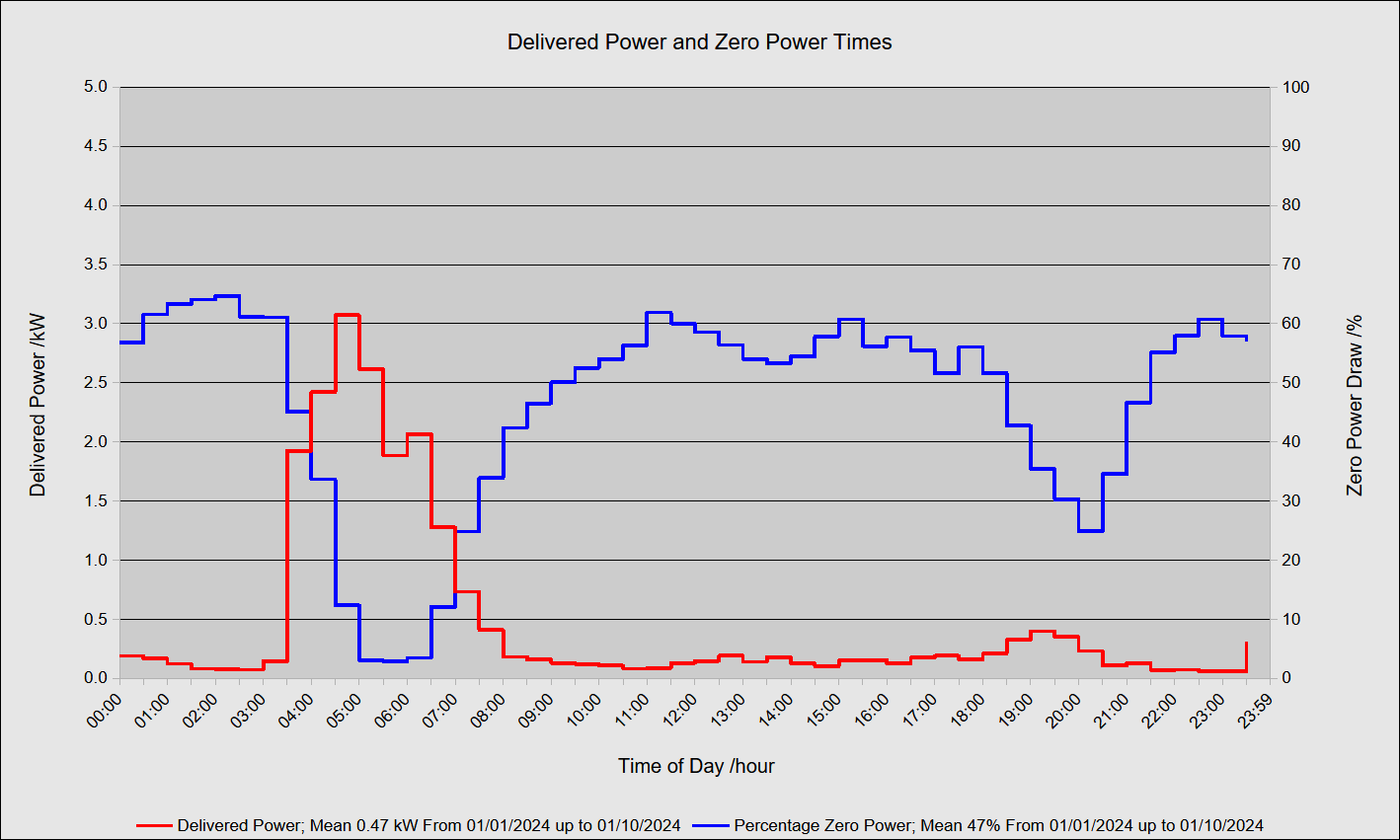

SteamyTea Posted October 19, 2024 Share Posted October 19, 2024 29 minutes ago, JamesPa said: It may be that ther optimum is just to charge my car, heat my water and do my dishwashing and clothes washing in the 'cheap' periods (which I presume are a reasonable proxy for carbon intensity) Not really for a couple of reasons. Generation capacity is set for a future date i.e. tomorrow at 3:00. Any demand is filled with gas generation, so the carbon intensity actually increased during times of low generation and demand i.e. 3:00 when nuclear and wind are doing the bulk of the work. It is a bit of a myth that the generation tracks demand, it is based on predicted demand and pre arranged generation capacity. When it goes wrong, you see huge price spikes for a short time. There was a radio show on about dynamic pricing, and how it is not like the old markets and bazaars. Rethink The 'carbon' price is around £40/tonne at the moment. Maybe that should be taken into account when costing out a system. Link to comment Share on other sites More sharing options...
JamesPa Posted October 19, 2024 Author Share Posted October 19, 2024 43 minutes ago, SteamyTea said: Not really for a couple of reasons. Generation capacity is set for a future date i.e. tomorrow at 3:00. Any demand is filled with gas generation, so the carbon intensity actually increased during times of low generation and demand i.e. 3:00 when nuclear and wind are doing the bulk of the work. It is a bit of a myth that the generation tracks demand, it is based on predicted demand and pre arranged generation capacity. When it goes wrong, you see huge price spikes for a short time. There was a radio show on about dynamic pricing, and how it is not like the old markets and bazaars. Rethink The 'carbon' price is around £40/tonne at the moment. Maybe that should be taken into account when costing out a system. If cheap electricity prices aren't a reasonable proxy for carbon intensity, then the battery environmental argument is further weakened. I was hoping someone would respond telling me why home batteries are good environmentally, perhaps they still will. Link to comment Share on other sites More sharing options...
