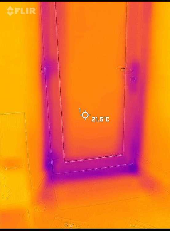

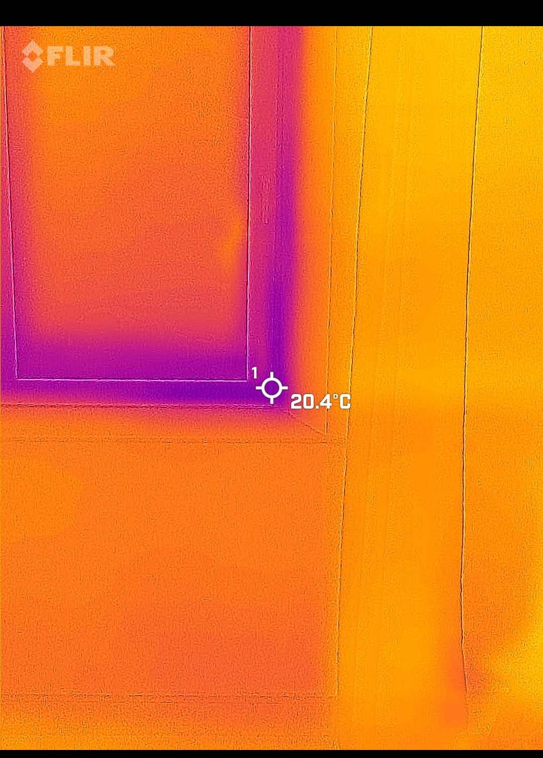

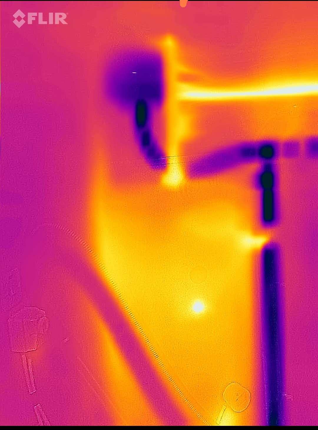

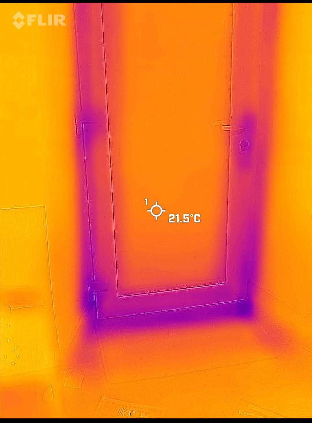

Iceverge Posted October 4 Share Posted October 4 Bought the USB C Flir for android. The resolution isn't mega but its good enough for DIY. Think it was about £150. Here's a pic of the UVC with the hot tap running. You can see the hotspots of the pipe going to the bathroom and the blanking plug. The dark blue line on the right is the cold inlet with the expansion vessel top left. The diagonal line is the vacuum cleaner! One of our windows from the inside. Our front door from the inside. It does a hybrid photo if you have lightning so appears better than it is resolution wise. You can see the thermal bridging at the locks, hinges and thresholds. 1 Link to comment Share on other sites More sharing options...
