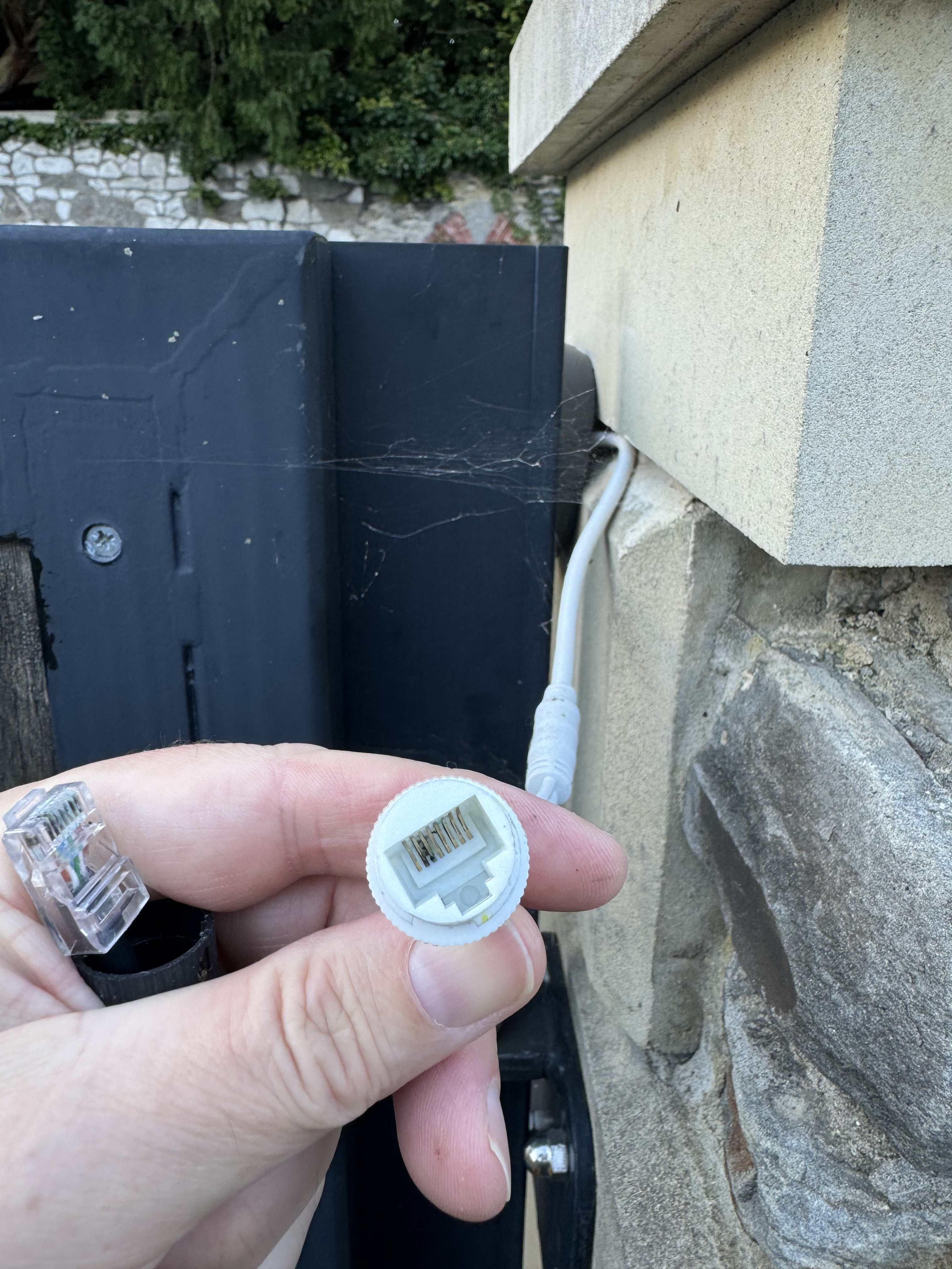

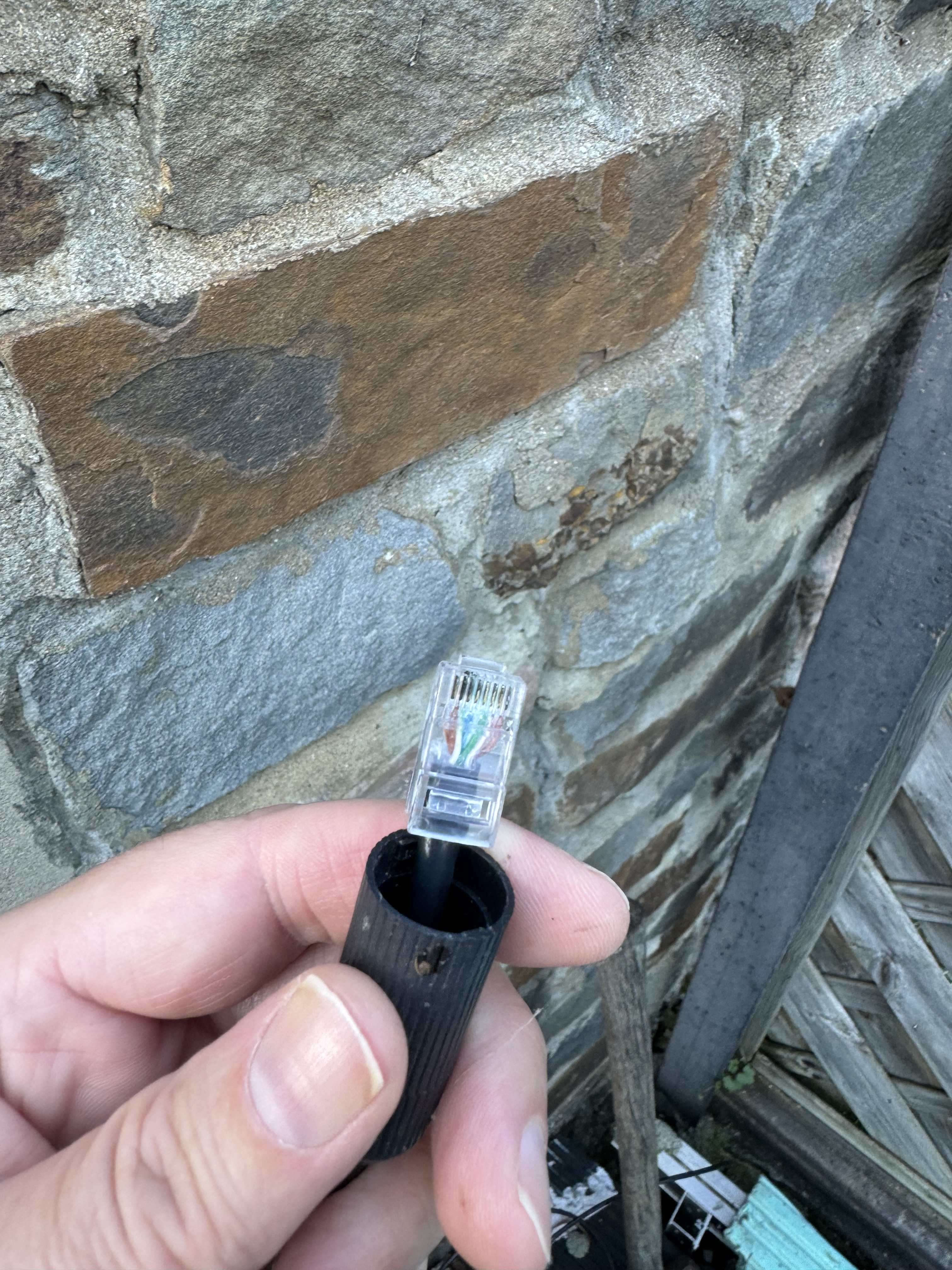

Pocster Posted October 3, 2024 Posted October 3, 2024 Got this outdoor camera on poe . Been fine . Today died . The water protection cover seems ok . But on the connector and in the camera connector can see black ( due to moisture ? ) . Best way to clean this off ? . Best way to prevent it ?

ProDave Posted October 3, 2024 Posted October 3, 2024 Looks like the cheap gold plating has failed. Wrap the replacement in self amalgamating tape, and honestly a bit of vaseline smeared on the connector pins before engaging keeps water out. (I do this on boat connections) 1

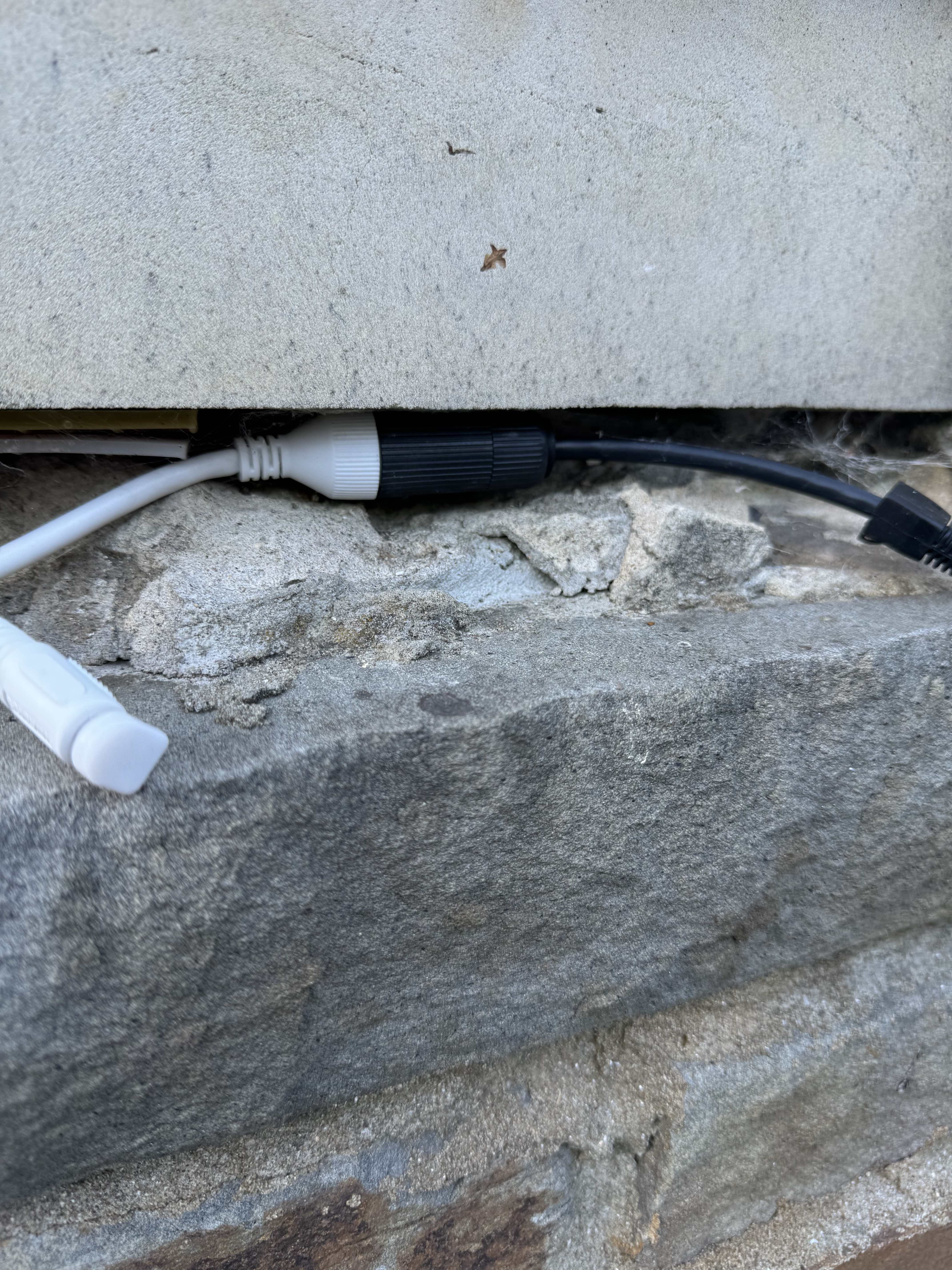

Pocster Posted October 3, 2024 Author Posted October 3, 2024 I’m not sure the gel crimps will work . Cat5 is long enough but camera lead is very short . By the time I cut it and expose the cables any junction box is going to be very near to the camera … I.e exposed and difficult to mount . If camera lead was longer probably not an issue …
dpmiller Posted October 4, 2024 Posted October 4, 2024 this is a problem with PoE, damp gets conductive at dc volts... Remake the plug, give the socket contacts a gentle scrub and try to remove some of the (conductive) black crap in behind them, then goop it up with vaseline or silicone grease as per @ProDave

Pocster Posted October 4, 2024 Author Posted October 4, 2024 2 hours ago, joth said: But my suggestion is also partially tongue in cheek, it's the cheap and quick potentially weatherproof fix (the gel is like vaseline in keeping water out) but clearly a bodge. Almost most of the BT copper wore telephone system runs on them... I did think your suggestion was rather tongue in cheek but tbh it would be easier to maintain if a wire failed at a later date . None of these rj45 “ waterproof” sleeves seem good enough - always fail relatively soon I.e in under a year . So I’m going to try this gel crimp solution . First though I need to find a box to put the cables and crimps in . Needs to be bomb proof and water proof . A tug on a cable will easily break those frail cat wires .
Pocster Posted October 4, 2024 Author Posted October 4, 2024 1 hour ago, Kelvin said: I used silicone gel and tape. But only just installed them so time will tell. Mine are behind the timber cladding so won’t get wet as such. I expect they will still fail due to moisture however. My original plan was to bring the Reolink cable into the house through a duct to avoid this but the cables aren’t long enough. My external cameras that are mounted literally on the house have their connector behind the cladding . Too date ( nearly 3 years ) no issues . Any connector / sleeve exposed to weather though always seems to perish .
