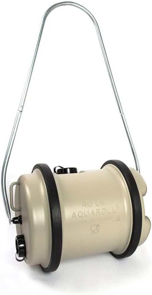

Amateur bob Posted October 3 Author Share Posted October 3 28 minutes ago, saveasteading said: If there is a sewer available then you can wheel the caravan waste tank to it, lift the cover, and discharge. OR dig a hole to empty it, well away from your works, let the liquid disappear and gradually fill in. Sawdust is a recognised bug killer too. New hole every 2 weeks or so. Do this until someone stops you, but it won't be harmful short term. OR make a composting toilet, again using sawdust. No chemicals needed. OR long drop, roman style. Don't fall in. Ive been looking online over £500 for effluent tanks, not cheap, how do u mean wheel the waste? A specialised carrier? The only issue with tipping it in a hole with a pail every day is risk of catching ecoli etc? Is this a high risk? Link to comment Share on other sites More sharing options...
saveasteading Posted October 3 Share Posted October 3 Link to comment Share on other sites More sharing options...
saveasteading Posted October 3 Share Posted October 3 4 minutes ago, Amateur bob said: risk of catching ecoli etc? Or simpler plastic tanks that need carrying. Just goohle for caravan waste drim. You won't catch anything off your own fresh waste. Gloves, hand sanitiser? But if the whole idea of drains worries you, best hire a commercial thunder box. £30 X 40 weeks? Link to comment Share on other sites More sharing options...
Amateur bob Posted October 3 Author Share Posted October 3 3 hours ago, saveasteading said: is that not for waste water? would it be suitable for sewage too? Link to comment Share on other sites More sharing options...
Amateur bob Posted October 3 Author Share Posted October 3 4 hours ago, saveasteading said: Or simpler plastic tanks that need carrying. Just goohle for caravan waste drim. You won't catch anything off your own fresh waste. Gloves, hand sanitiser? But if the whole idea of drains worries you, best hire a commercial thunder box. £30 X 40 weeks? howd u mean tanks that need carrying can i use waste water tanks for sewage? thats £1200, im trying to keep costs down just now or id just pay it Link to comment Share on other sites More sharing options...
ProDave Posted October 3 Share Posted October 3 24 minutes ago, Amateur bob said: is that not for waste water? would it be suitable for sewage too? That is an "aquaroll" other makes are available) for transporting fresh drinking water to a touring caravan. Nothing to to with waste. Link to comment Share on other sites More sharing options...

saveasteading Posted October 3 Share Posted October 3 1 hour ago, ProDave said: Nothing to to with waste OK. Accepted. Isn't there an equivalent for waste? This one says it is for grey waste. Nobody is checking. Or eat charcoal? Link to comment Share on other sites More sharing options...
ProDave Posted October 3 Share Posted October 3 This is the sort of thing most touring caravans use to collect their grey waste water and wheel it to the appropriate drain on a site. Link to comment Share on other sites More sharing options...
