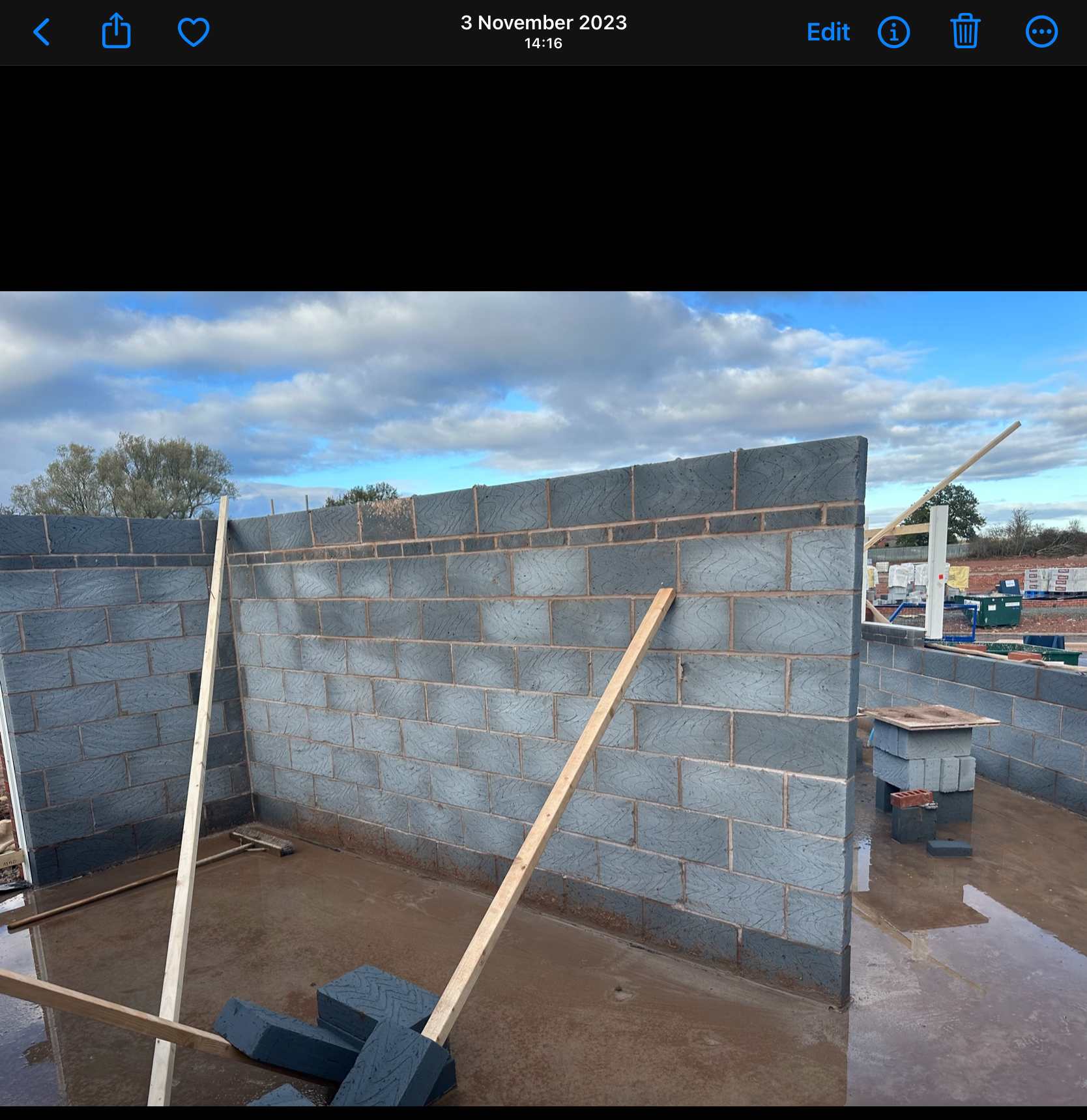

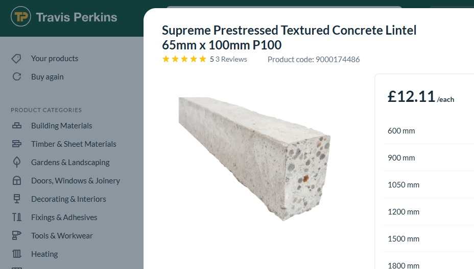

Mulberry View Posted November 14, 2024 Author Share Posted November 14, 2024 I'm still at it with these internal walls, I'll post some pics when I get a minute. But what lintels for the internal doorways now that I'm using medium-dense concrete blocks? My merchant has suggested the right-angled external ones like this... Link to comment Share on other sites More sharing options...

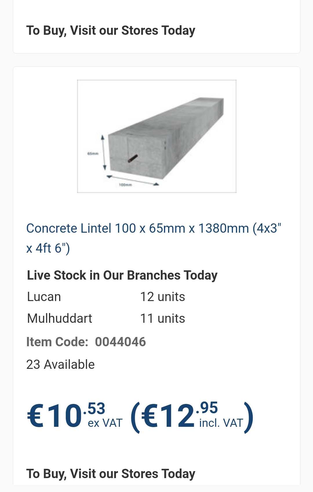

Iceverge Posted November 14, 2024 Share Posted November 14, 2024 Can you not get precast concrete lintels easily in the UK? 2 Link to comment Share on other sites More sharing options...
Mulberry View Posted November 14, 2024 Author Share Posted November 14, 2024 (edited) 4 minutes ago, Iceverge said: Can you not get precast concrete lintels easily in the UK? Ah, perhaps I can. I'll check. You think its definitely strong enough @Iceverge? Edited November 14, 2024 by Mulberry View Link to comment Share on other sites More sharing options...
Russell griffiths Posted November 14, 2024 Share Posted November 14, 2024 Concrete lintel, but go up a size they are about 150 deep. 1 Link to comment Share on other sites More sharing options...
Mulberry View Posted November 14, 2024 Author Share Posted November 14, 2024 1 minute ago, Russell griffiths said: Concrete lintel, but go up a size they are about 150 deep. So not this then? Link to comment Share on other sites More sharing options...
Russell griffiths Posted November 14, 2024 Share Posted November 14, 2024 Depends what it’s holding up if it’s just two courses of block until you hit ceiling level then your fine with those, if it’s a wall taking uppperfloor joists then go bigger, or consult your drawings. 1 Link to comment Share on other sites More sharing options...

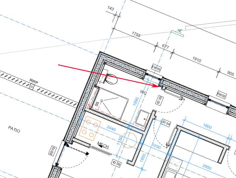

Mulberry View Posted December 8, 2024 Author Share Posted December 8, 2024 I'm still getting on with these internal walls and am on with this bit this week... How to construct the little bit that the arrow is pointing at? It's 100x100. Do I build the mains sections in block, then the lintel and the 100x100 bit out of timber? It feels like a bit of a mish-mash combining block and timber framing. Or is there a way to build that little 100mm section to allow the use of a normal concrete lintel over the door? If you lovely peeps can help with this, I'll post some pics of my blockwork so far, but be nice, it's my first time and I used medium-dense concrete blocks, which, as it turns out, are a bit scruffy. Link to comment Share on other sites More sharing options...
Iceverge Posted December 8, 2024 Share Posted December 8, 2024 We did both, Studded and block built the small bits. Studding is probably easier. Remember it significantly strengthens the outer wall of you tie it in correctly to it. Link to comment Share on other sites More sharing options...
