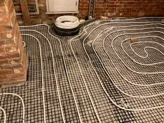

eros_poli Posted September 24, 2024 Posted September 24, 2024 Hi, I'm about to install a Glapor Geocell floor, provided by Mike Wye. On their guidance it recommends a compactor of between 85-120kg in weight (among other specs). The only compactors I can find for hire around me are 50kg in weight. Does anyone have any experience of compacting geocell with a lighter whacker plate? Ideally it’s electric as I don't want the house to stink of fumes for months..... Do I just need to use it for longer/slower to get the same compaction ratio? Or do I have to use a heavier unit? Here's the lighter weight electric one https://brandonhirestation.com/electric-plate-compactor-hire Thanks! J

sgt_woulds Posted September 25, 2024 Posted September 25, 2024 Geocell is an arse to compact. You will need the heaviest whacker you can get to achieve anything like the compaction rates that Mike Wye suggest when they work out how much product you need. Expect to have a lot left over. You won't find an electric whacker up to the job - at least I didn't - so unfortunately you will have to put up with petrol fume headaches and the one you'll get just from the noise... Plan for more labour than you expect. Geocell does not shovel easily because it binds together - moving it around before whacking is exhausting even for a very small area. If it's just for a living room I'd be less concerned than for a garage; use an electric whacker - but reduce the amount of geocell purchased by at least a quarter.

Adrian Walker Posted September 25, 2024 Posted September 25, 2024 You need a heavy wacker plate even if you reduce the thickness. An electric one won’t really cut it. Max 150mm per layer.

saveasteading Posted September 25, 2024 Posted September 25, 2024 On 25/09/2024 at 16:15, SteamyTea said: probably just crushing the solid part Expand I wonder. When we buy type 1, we are wanting the finished product to be as much like solid stone as possible. So we whack it but, importantly, also vibrate it so that the little bits fill the gaps between the big bits. No air is left. G9eocell seems to be single size with lots of gaps. Whacking it will break sandy shards off it (I assume) and you get the assessed performance. Doing it less, there will be more air. But presumably trapped within the finished product. I'd think working with 50 or 75mm layers will compact decently with a lesser compactor. Nobody will have tested it though. 1

Roger440 Posted November 12, 2024 Posted November 12, 2024 On 26/09/2024 at 02:25, Gus Potter said: Yes type one is aimed at good compaction and achieving density. Add a little cement content and you have a lean mix that forms a lot of the sub base of our motorways. I think Geocell is much more like a single size aggregate.. like railway ballast. Now as an SE I should be using some technical terms.. but my best answer is that for Geocell which is pretty much a single size material it just needs "shoogled" into place. Thrashing it to death with say a 10 tonne vibrating roller will just damage it. I've specified this stuff and the results (feed back) so far are good for the loads I want it to carry. Goecell is not new in terms of material composition. It's stable, not frost succeptiable for example. It is bulky and a bit of a shit to shovel apparently. The top of it is a bit rough so maybe needs a bit of blinding. I'll leave the last bit out as this is my IP property. Now @Alan Ambrose for example. The NHBC put a limit on hardcore fill for rafts foundations at 600mm.. and this would apply to say EPS and XPS material on hard core. I wonder if Goecell have ideas o how thick thierstuff can be? Their stuff is not heave prone, not frost prone and has insultating properties. This has got me thinking.. can we do rafts with lots of Geocell and little if no EPS or EPS where we need to go deep to avoid clay and tree root heave for example. Now Geocel is light weigth so on bad ground we dig out some crap stuff and replace with a lighter structural fill.. now we further reduce the soil loadings. I'm just chewing the fat here folks but BH is at the cutting edge of things. Expand Ive used it, and your description of "shoggled" is about right. Its nothing like whacking down type 1. Significant voids or gaps remain afterwards. A geotextile membrane was then laid before concrete/lime crete. If you didnt, the voids are such that the concrete would fall down into the voids, negating its insulating properties. The main reason i used it aside from being "breathable" (old house) if i can use that term is that it reduced excavation as it is both the sub base and insulating layer combined. Im not one for taking pics, heres a shot with geocell, membrane and heating pipes down 2
