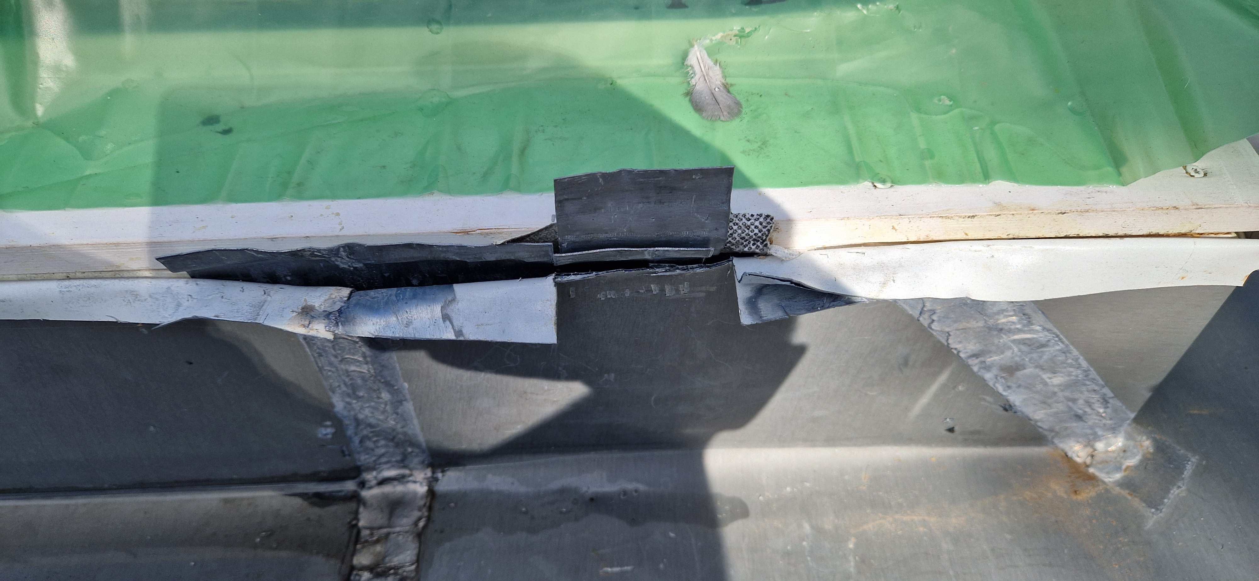

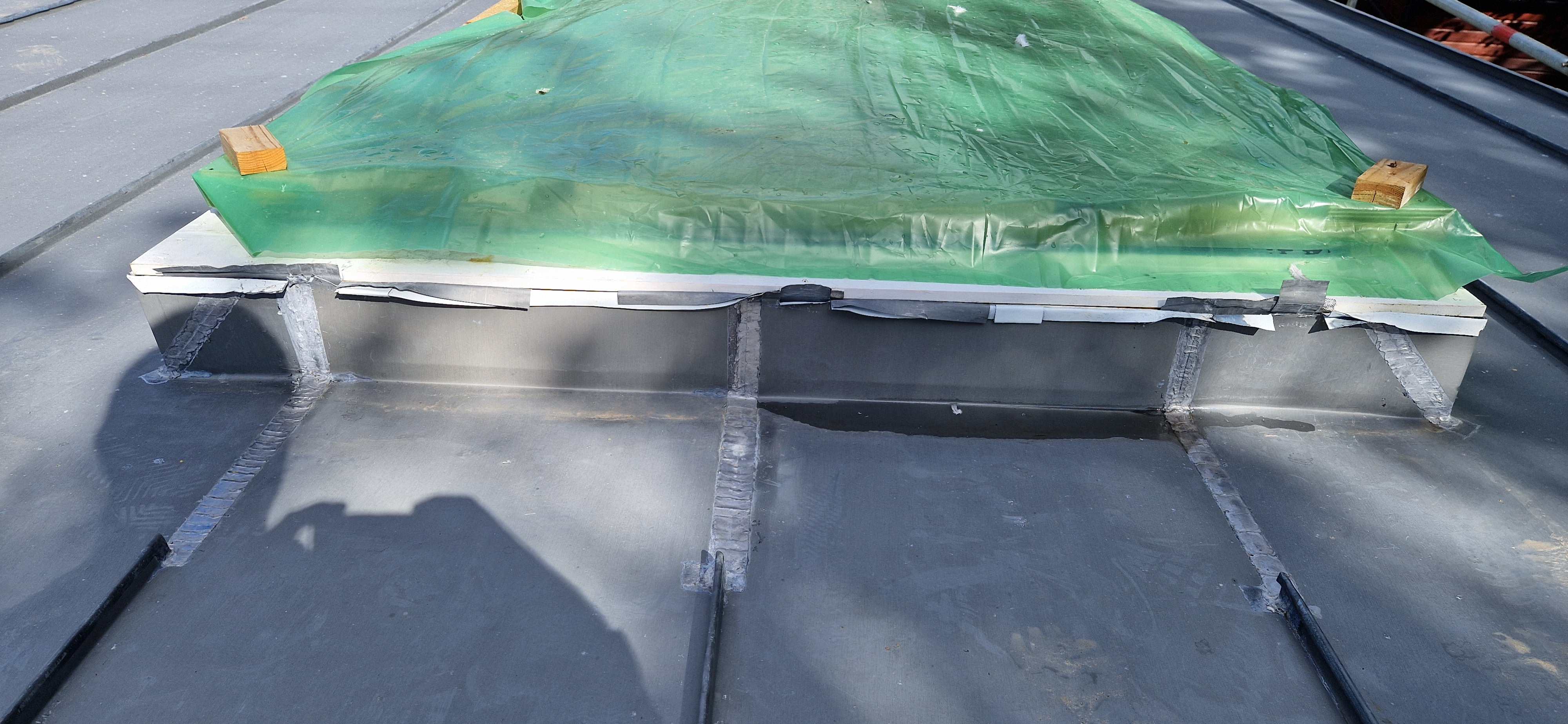

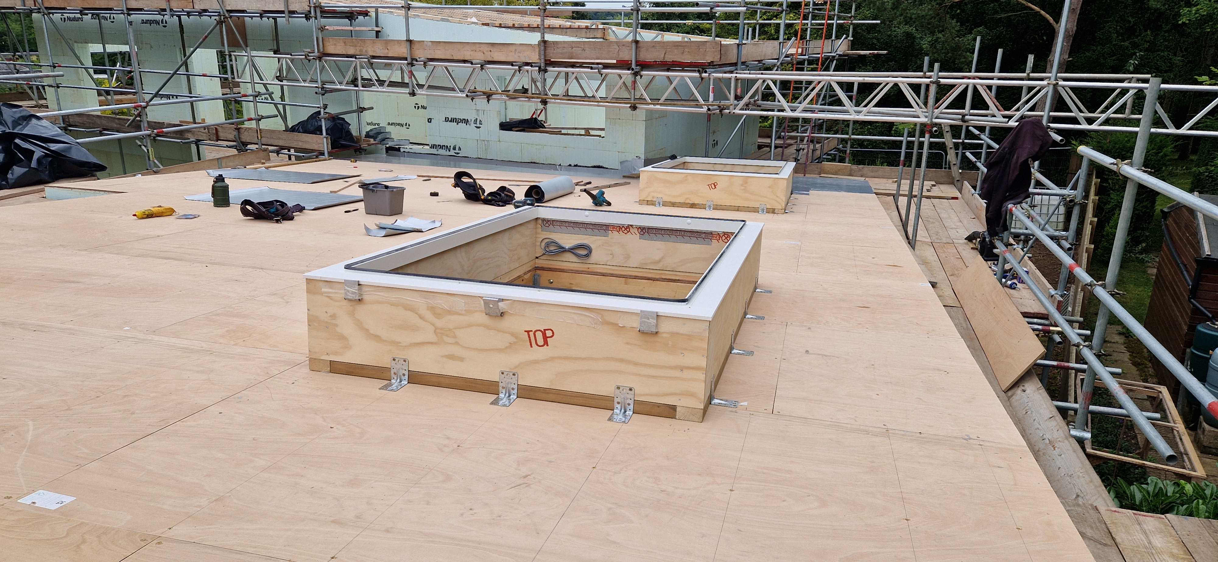

Mulberry View Posted September 21, 2024 Author Posted September 21, 2024 This is the issue... This is how I handed the Velux upstand over to them. Note the 3 hinges under the top rim, these are factory installed by Velux, they don't recommend removing them. The Zinc contractor wanted to run their back gutter detail up the upstand to the top and create a drip detail, all good so far. I believed I would be reinstalling the hinges over the top of a 0.8mm flat layer of Zinc, after cutter away the drip detail where the hinge would go... This is what they left me with. I have folded the drip up and started to cut it, but realised that there are multiple layers of Zinc, as many as 5 in places and the left-hand hinge falls directly on top of a soldered joint. Keep in mind that the hinges were removed by me (with the Zinc guy watching) and on the second window they removed them. Velux won't allow the hinges to be placed over more than one flat layer of Zinc, but if you cut the material out completely, you're left with a break in the upstand only about 50mm above the surface of the roof, which voids the VM Zinc warranty. The hinges pivot at the bottom, so this rules out a layer of material overlapping the hinges after installation. The only solution I have in mind at the moment is to cut all the Zinc out in the vicinity of the hinges and place a single flat piece of Zinc over the whole area, bonded down and screwed through, thus water-tighting the area and leaving only one layer beneath the hinges, but I need that agreed by VM Zinc if that's deemed to be a solution. I'm told that the Zinc roof needs to be able to expand and contract, so screwing it to the upstand seems counter-intuitive.
Mr Punter Posted September 21, 2024 Posted September 21, 2024 Would it work if you cut the zinc down a bit and dressed another material to act as a flashing, like a single ply membrane, over the top of the upstand and down over the zinc?
Mulberry View Posted September 25, 2024 Author Posted September 25, 2024 On 21/09/2024 at 16:39, Mr Punter said: Would it work if you cut the zinc down a bit and dressed another material to act as a flashing, like a single ply membrane, over the top of the upstand and down over the zinc? What I'm left with is voiding the Vario by Velux warranty if I install the rooflights over this finish, or voiding the VM Zinc warranty if I alter the roof. I'm literally over a barrel and now the Zinc installer is telling me that if I don't pay the completion balance he's going to start proceedings to recover the money, but surely the job isn't complete yet?!

Andeh Posted September 25, 2024 Posted September 25, 2024 So sorry OP,you have my sympathies! Every building has these moments, and If you've made it this far..... You've done well! I wonder if they could simply trim the entire top 5 inches off all the way round the roof light, then wrap a single layer of zone round each one over the top of the rest below. Almost like a sweat band going all the way round? Hinge then a req through it per single zinc layer?
Mulberry View Posted September 25, 2024 Author Posted September 25, 2024 37 minutes ago, Andehh said: So sorry OP,you have my sympathies! Every building has these moments, and If you've made it this far..... You've done well! I wonder if they could simply trim the entire top 5 inches off all the way round the roof light, then wrap a single layer of zone round each one over the top of the rest below. Almost like a sweat band going all the way round? Hinge then a req through it per single zinc layer? A detail rework is currently on the table, awaiting approval by VM Zinc and Vario by Velux (and us). Do I have any grounds for compensation from the contractor for the time wasted, money lost on scaffolding etc? He has even not ruled out charging us to rectify the detail as he still thinks this is my fault. I am baffled.
