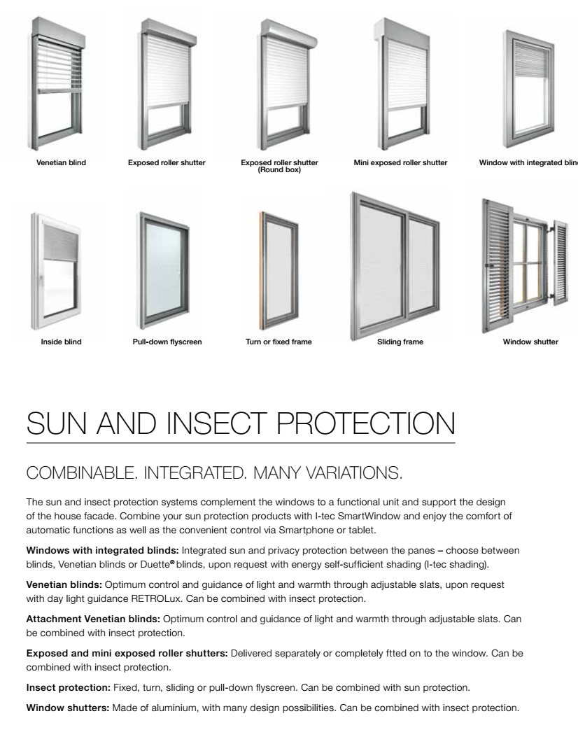

le-cerveau Posted November 6, 2017 Share Posted November 6, 2017 Internorm do fixed, turn, sliding and pull down bug screens! 1 Link to comment Share on other sites More sharing options...

Russell griffiths Posted November 6, 2017 Author Share Posted November 6, 2017 9 minutes ago, jack said: You also have to consider whether your windows open in or out. If they're inward opening, you really need an external screen setup, and vice versa. aha. You hit the nail on the head. This is where I get my dislike for all the fancy European windows the opening configuration seems crazy (to me) does anybody make a good sliding window. All our previous windows where sliders so allowing external fly screens which also double as a security screen so a window can be left ajar a bit if needed. Link to comment Share on other sites More sharing options...
le-cerveau Posted November 6, 2017 Share Posted November 6, 2017 If you have European Tilt and turn (inwards) then external screens are not an issue, and the fact that hen whole pain tilts/turns gives you access to the screen. Below is a page out of the current Internorm catalog showing various options, yes they are nor cheep but worth it. I would question how well sealed you could get sliding windows like the ones they have in the USA! Link to comment Share on other sites More sharing options...
