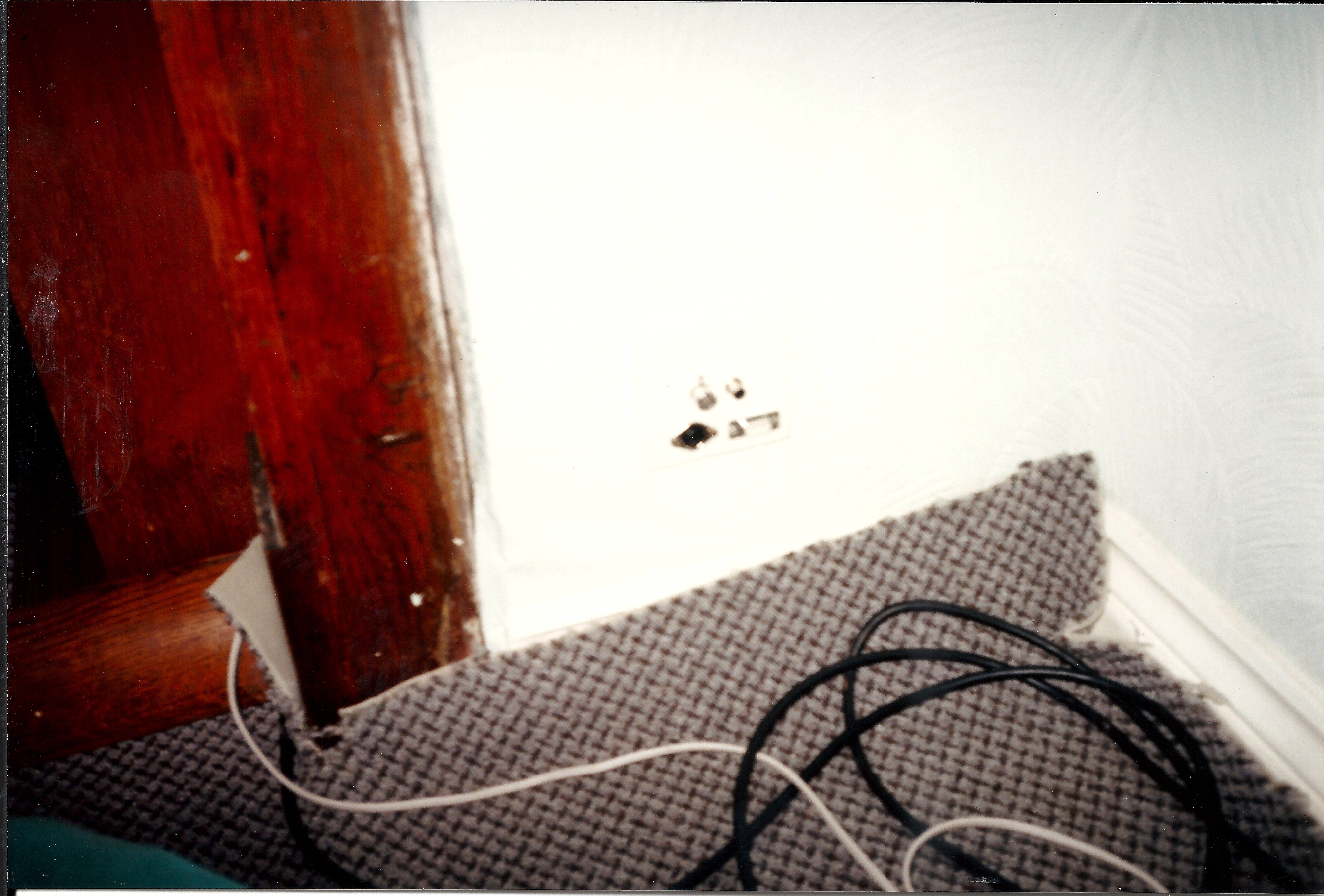

Onoff Posted December 29, 2017 Share Posted December 29, 2017 (edited) Not what you're after but similar to what I did all those years back: http://cpc.farnell.com/unbranded/sg194-metal-plate-only/wall-plate-2g-cutouts-usb/dp/AV16630?CMP=KNC-GUK-CPC-GEN-SHOPPING-UNBRANDED-AV16630&gross_price=true&mckv=skeuL1FSh_dc|pcrid|224635168920|kword||match||plid||pid|AV16630|&gclid=EAIaIQobChMItanQsKav2AIV6rDtCh25cABbEAQYBSABEgIjo_D_BwE Found these "hotel" media plates, their other media plates are interesting: https://www.nexxia.co.uk/product-category/audio-wall-plates/hotel-media-wall-plates?gclid=EAIaIQobChMI2uyx46av2AIVYbvtCh0ptAV7EAAYAyAAEgIHQ_D_BwE Edited December 29, 2017 by Onoff Link to comment Share on other sites More sharing options...
