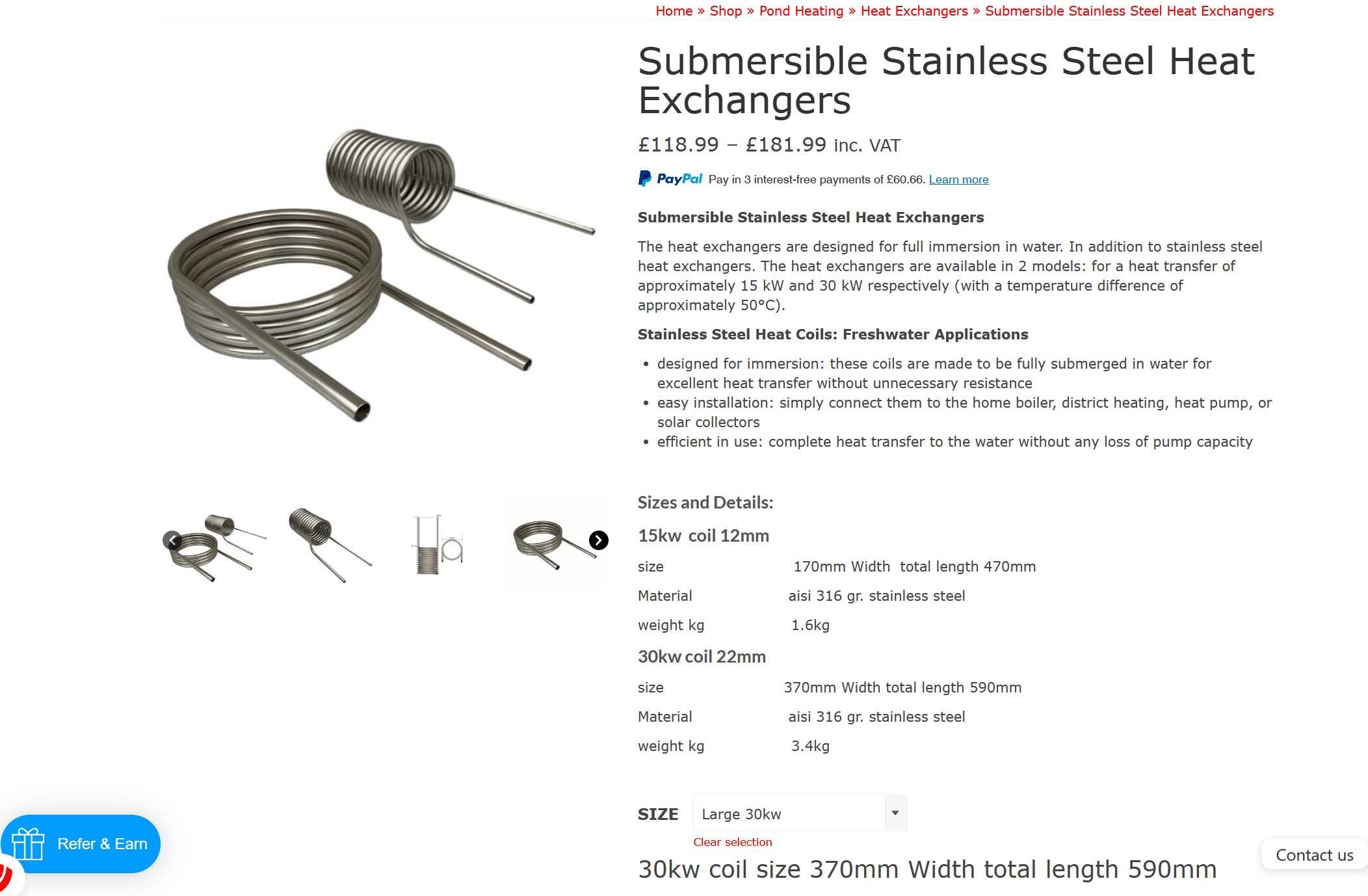

AllenCherry Posted September 11, 2024 Author Posted September 11, 2024 Wow! THANK YOU everyone for all the help! A bit more information - the house is in the countryside of Japan (Myoko), and has no 'central heating' at all - heating during the winter is by a few paraffin heaters, gas and electricity in each room. The hot spring water flows into a 'holding tank' before filling the hot spring bath (a Japanese 'onsen'), and I was considering using a stainless steel heat exchanger immersed into the 'holding tank' - something like: https://www.cotswoldkoi.co.uk/product/submersible-stainless-steel-heat-exchangers/?attribute_size=Large+30kw&gad_source=1&gclid=CjwKCAjwufq2BhAmEiwAnZqw8hz-OZ0nZzfeIwPXz-Yf88Oxf4soCF1pnL5h-Lfiwm6P1luhYeXrJRoC9yUQAvD_BwE The spring water does have some sulphur content, but is not very corrosive - so the stainless steel for the heat exchanger should be OK. Given that the water circulating around the radiators will obviously be less than 50 deg C, how do I work out the size of the radiators for the room size? The house is well insulated - the Japanese do things correctly! Another problem is the mains power is 100 volts 50Hz AC - so pump selection may be difficult. Can anyone give some ideas on the piping to use - will plastic be OK? Presumably an expansion tank will be required for the circulating central heating water, and the water will have to have anti-freeze added. Is a 'header tank' required, or can it be a closed-loop system? I really am appreciative of all the help - and yes, it is an exciting project, but I am an electronics engineer, not a central heating engineer!! Thank you, Allen
sharpener Posted September 11, 2024 Posted September 11, 2024 On 11/09/2024 at 06:33, AllenCherry said: Given that the water circulating around the radiators will obviously be less than 50 deg C, how do I work out the size of the radiators for the room size? Expand You would need to do a proper heat loss calculation using e.g. the free Heatpunk app from Midsummer Wholesale. It will then guide you to correct rad sizes for the flow temp. (If you had got radiators already then upsize them by 1.9x for 50C flow). On 11/09/2024 at 06:33, AllenCherry said: I am an electronics engineer, not a central heating engineer!! Expand I am too, you will be in good company here. Electronics Engineers seem to have a better grasp of pressure, flow, thermal resistance, heat transfer etc than most plumbers bc all quantities have analogues in electrical engineering. On 11/09/2024 at 06:33, AllenCherry said: I was considering using a stainless steel heat exchanger immersed into the 'holding tank' Expand With a limited heat source (max 8.4 kW as above assuming you could transfer it all to the target rooms) I think you will only get half of that into the load (think load matching/load lines). So as an inspired/informed guess you will be best off picking a heating flow temp midway between the two i.e. 35 deg. The larger model is rated at 30kW with "approximately" 50K delta T, so 4.5kW at 15K which is v close to what you want. This might just be enough for a small well-insulated house but will require very big rads. You might be better off piping the hot water into a conventional HX bc then you could have a proper counterflow arrangement which will be more efficient from the thermodynamic point of view. The secondary flow temp will then be closer to the source temp, and the waste spring water will be closer to the return temp from the rads, so you harvest more of the heat available from the spring. @JamesPa has done quite a lot of modelling of this kind of thing so may have some more insights (or may be able to demonstrate I am completely wrong!) Fascinating project, ATB with it.
AllenCherry Posted September 11, 2024 Author Posted September 11, 2024 Hi Sharpener, Many thanks for your comments! You mention: >> conventional HX << What do you suggest as a 'conventional heat exchanger'? From what I see, all other heat exchangers appear to need a pump for both the primary and the secondary circuits - would the pump on the primary side need to be 'rather special' to withstand the slightly acidic nature of the hot spring water? Thanks for your help, Best wishes, Allen
sharpener Posted September 11, 2024 Posted September 11, 2024 On 11/09/2024 at 14:06, AllenCherry said: What do you suggest as a 'conventional heat exchanger' Expand Flat multiplate HX like these, have heard good reports of inhouse SWEP brand by these people. Quite widely used in UK domestic HP installations so stocked by some plumbers' merchants here. On 11/09/2024 at 14:06, AllenCherry said: would the pump on the primary side need to be 'rather special' to withstand the slightly acidic nature of the hot spring water? Expand Note their pH 7.5 to 10 limits for ordinary copper brazing, and get water properly analysed for sulphur content and other things as well. I have found test strips are not reliable (especially for pH measurement) on naturally occuring waters e.g. my harvested rainwater. Universal Indicator drops like these are OK and more sensitive. Check with pump mfr but an all stainless steel/plastic construction would probably be OK as no intermetallic effects. My rainwater is slightly acidic even after treatment but s/s pump shows no corrosion. (However 2 have failed for other reasons, cracked plastic impeller shroud and failed shaft gland, don't buy Stuart Turner! They consider them non-repairable so no spares available, but I have built one good one out of the bits from two. A bit like the old joke about why you need two Hasselblad cameras. /rant) Of course if you have enough head available from the spring then ideally you would not need a primary side pump at all. Forgot to add theory link earlier. Explanation here of why only half heat transferred, coil in holding tank will be an approximation to this. HTH.
