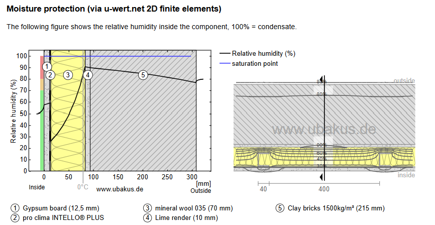

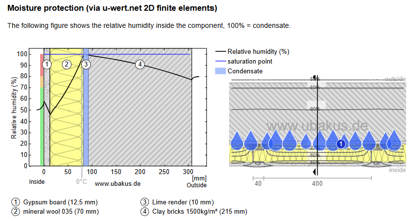

Annker Posted 3 hours ago Author Share Posted 3 hours ago I'm unsure if an Open Vapour buildup should be modelled in Ubakus, but when it is it shows a condensation risk. Is that what we should expect and accept on the proviso that been vapour open the condensation can dry to the inside? Same buildup but with the inclusion of Intello Plus VCL. @Redbeard I believe you were suggesting the inclusion of a VCL? Link to comment Share on other sites More sharing options...

Redbeard Posted 3 hours ago Share Posted 3 hours ago 24 minutes ago, Annker said: Same buildup but with the inclusion of Intello Plus VCL. @Redbeard I believe you were suggesting the inclusion of a VCL? Yes, I was, on the basis if mineral wool potentially being less moisture-buffering than wood-fibre. I like (expensive!) Intello as it's good for pessimists (tends to become more vapour-open in warmer weather so that *if* any moisture has got in during the winter it may be able to 'breathe' back out). 1 Link to comment Share on other sites More sharing options...
Annker Posted 3 hours ago Author Share Posted 3 hours ago 1 minute ago, Redbeard said: Yes, I was, on the basis if mineral wool potentially being less moisture-buffering than wood-fibre. I like (expensive!) Intello as it's good for pessimists (tends to become more vapour-open in warmer weather so that *if* any moisture has got in during the winter it may be able to 'breathe' back out). Yes its pricey but anything done at this stage will certainly be cheaper than rectifying works after decoration is done, its along that line of thinking that I'm happy to sell on my already purchased PIR at a loss. WRT to using RK38. Do you use it neat by its self or with sand as a replacement for the lime in the parge coat. Link to comment Share on other sites More sharing options...
