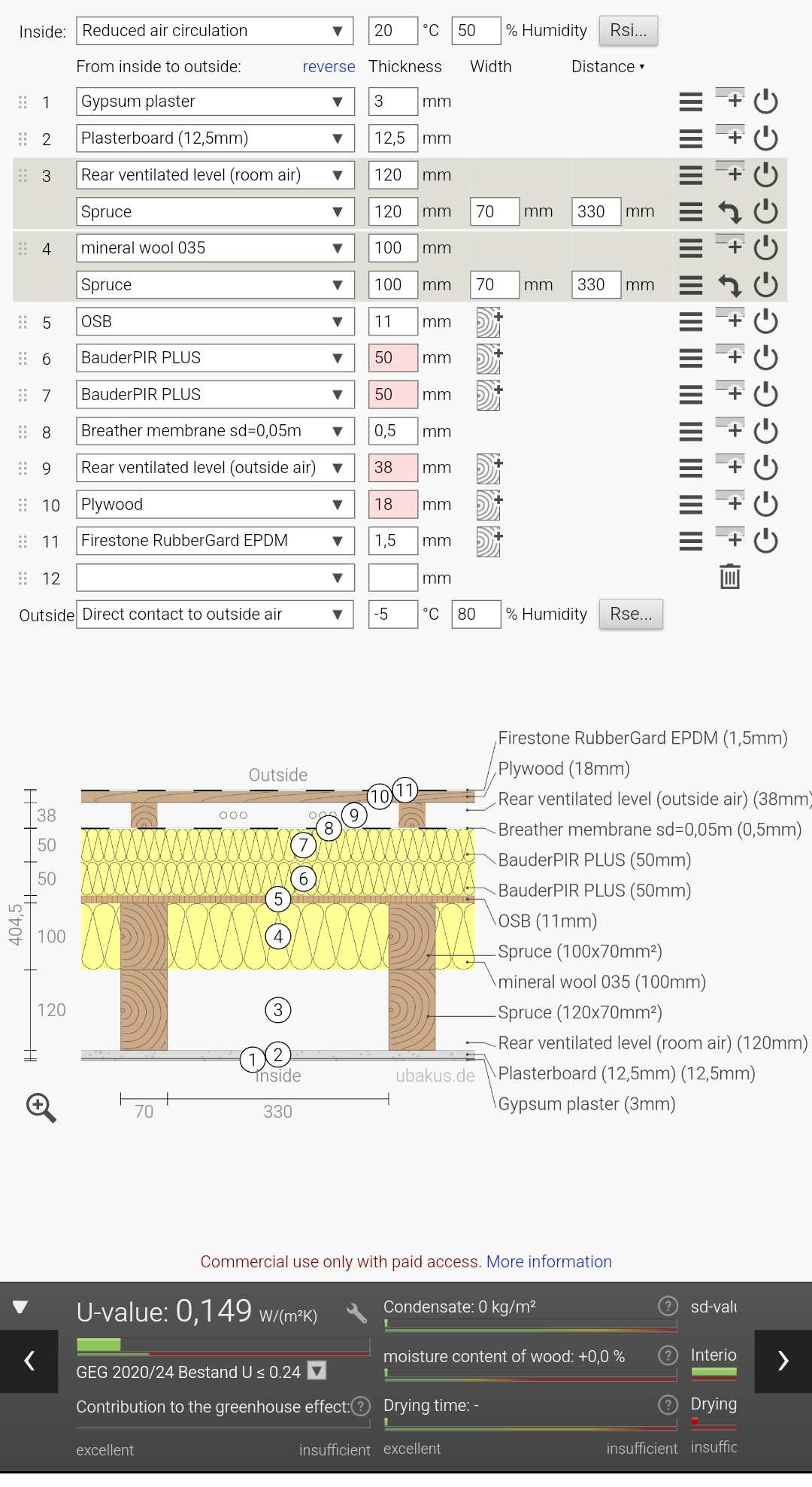

Iceverge Posted October 5, 2024 Share Posted October 5, 2024 (edited) Sorry no sketch. My family dragged me off before I got my drawing finished. As ever durability, cost and buildability are top of my agenda. Couple of points to discuss with your designer. 1. The steel looks like a 305*102 UB of some description. I would try to get it swapped out for 2 x C24 300*75mm timbers or maybe a Gluelam. For a TF building they would be far easier to fix to and present less thermal bridging issues and be about half the steel price. 2. Those pozi joists look to be only about 180-200mm which really isn't the best application of them in my opinion. You are gaining little of the potential strength of them by having such a thin depth . If you were to replace them with 225*75 solid joists you'd save a ton of cash and be able to collect them from any builders merchant. They'd be simpler to trim and adjust on site for chippies too. 3. To get the desired slope I would just rip a 100x75 timber onto a wedge and hammer it on top of the gable walls and use them to slope all the joists. Accept a 2 degree fall in the ceiling inside too. It'll be imperceptible. No need to source tapered insulation or multiple fitting strips. Here's my proposal. 225*75 joists in lieu of posijoists. Cheaper and easier to source. 100mm mineral wool batts between joists. Easily sourced and cheap. 11mm OSB layer returned to internal airtighess layer at perimeter with strips of membrane. Joints all taped externally for ease of construction. 2 X 50 mm layers of PIR staggered taped.and foamed joints, to mitigate gas migration and board shrinkage. Breather membrane. 38 x 50 mm battens at 90 Deg to joists for ventilation/drainage plane to be continuous with wall ventilated cavity 18mm ply deck to support EDPM or GRP. Build the parapet on top of this layer of ply allowing the ventilation to go under it and down the wall cavity. Edited October 5, 2024 by Iceverge Link to comment Share on other sites More sharing options...
Iceverge Posted October 5, 2024 Share Posted October 5, 2024 One key point about warm deck roof construction that I dislike is that plywood gets trapped between multiple layers of impermeable material with no opportunity to dry through ventilation. If there's any excess moisture or construction moisture it can't go anywhere, potentially storing issues for freeze thaw action or organic matter decay. In the above diagram every piece of timber has the chance to dry to air. Link to comment Share on other sites More sharing options...

Annker Posted December 19, 2024 Share Posted December 19, 2024 On 05/10/2024 at 22:10, Iceverge said: Sorry no sketch. My family dragged me off before I got my drawing finished. As ever durability, cost and buildability are top of my agenda. Couple of points to discuss with your designer. 1. The steel looks like a 305*102 UB of some description. I would try to get it swapped out for 2 x C24 300*75mm timbers or maybe a Gluelam. For a TF building they would be far easier to fix to and present less thermal bridging issues and be about half the steel price. 2. Those pozi joists look to be only about 180-200mm which really isn't the best application of them in my opinion. You are gaining little of the potential strength of them by having such a thin depth . If you were to replace them with 225*75 solid joists you'd save a ton of cash and be able to collect them from any builders merchant. They'd be simpler to trim and adjust on site for chippies too. 3. To get the desired slope I would just rip a 100x75 timber onto a wedge and hammer it on top of the gable walls and use them to slope all the joists. Accept a 2 degree fall in the ceiling inside too. It'll be imperceptible. No need to source tapered insulation or multiple fitting strips. Here's my proposal. 225*75 joists in lieu of posijoists. Cheaper and easier to source. 100mm mineral wool batts between joists. Easily sourced and cheap. 11mm OSB layer returned to internal airtighess layer at perimeter with strips of membrane. Joints all taped externally for ease of construction. 2 X 50 mm layers of PIR staggered taped.and foamed joints, to mitigate gas migration and board shrinkage. Breather membrane. 38 x 50 mm battens at 90 Deg to joists for ventilation/drainage plane to be continuous with wall ventilated cavity 18mm ply deck to support EDPM or GRP. Build the parapet on top of this layer of ply allowing the ventilation to go under it and down the wall cavity. @Iceverge interested to know what the purpose of the breather membrane is here? I've just completed a warm roof, I would describe it as the conventional build-up. Roof covering (liquid in my case) 18mm osb (Thermally broken fixed into joists) 150mm pir Alutrix vcl 18mm osb Roof Joist Plasterboard and skim (Yet to be completed) I did reasonable research before opting for this build-up but after going through the process of assembling it together a number of drawbacks/shortcomings became evident I will not use this particular design again. I'll post a full critique when I get a moment. Link to comment Share on other sites More sharing options...
mjc55 Posted December 19, 2024 Share Posted December 19, 2024 6 minutes ago, Annker said: @Iceverge interested to know what the purpose of the breather membrane is here? I've just completed a warm roof, I would describe it as the conventional build-up. Roof covering (liquid in my case) 18mm osb (Thermally broken fixed into joists) 150mm pir Alutrix vcl 18mm osb Roof Joist Plasterboard and skim (Yet to be completed) I did reasonable research before opting for this build-up but after going through the process of assembling it together a number of drawbacks/shortcomings became evident I will not use this particular design again. I'll post a full critique when I get a moment. Liquid roof covering ???? Tell us more? Link to comment Share on other sites More sharing options...
Annker Posted December 19, 2024 Share Posted December 19, 2024 @mjc55 I'm just referring to a liquid applied roof covering. I used Restec Flexitec 2020, it is a flexible grp membrane @IcevergeJust came to mind that the breather membrane is probably there to catch any drips that pass the primary covering, its position directly over the PIR which serves as a VCL threw me. Link to comment Share on other sites More sharing options...
Iceverge Posted December 19, 2024 Share Posted December 19, 2024 2 hours ago, Annker said: Alutrix vcl Not crazy about this. You're sandwiching layers of very low permeability. AKA foil faced PIR and the VCL. 2 hours ago, Annker said: IcevergeJust came to mind that the breather membrane is probably there to catch any drips that pass the primary covering, its position directly over the PIR which serves as a VCL threw me. Yes in my preferred flat roof makeup with ventilation above the insulation. Any cheap breather/felt will do to throw any drips off the PIR. 2 Link to comment Share on other sites More sharing options...
