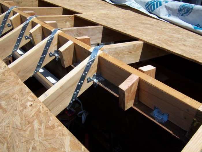

Temp Posted August 23, 2024 Posted August 23, 2024 (edited) Im not an SE but my understanding is that a ridge beam (as distinct from a ridge board) is intended to support a lot of the weight of the roof when it can't be triangulated to stop the walls being pushed out. The roof partly "hangs" from the beam. To make that work you tie the two rafters together above the beam with metal plates. Google found this image but I would check with your designer. Edited August 23, 2024 by Temp

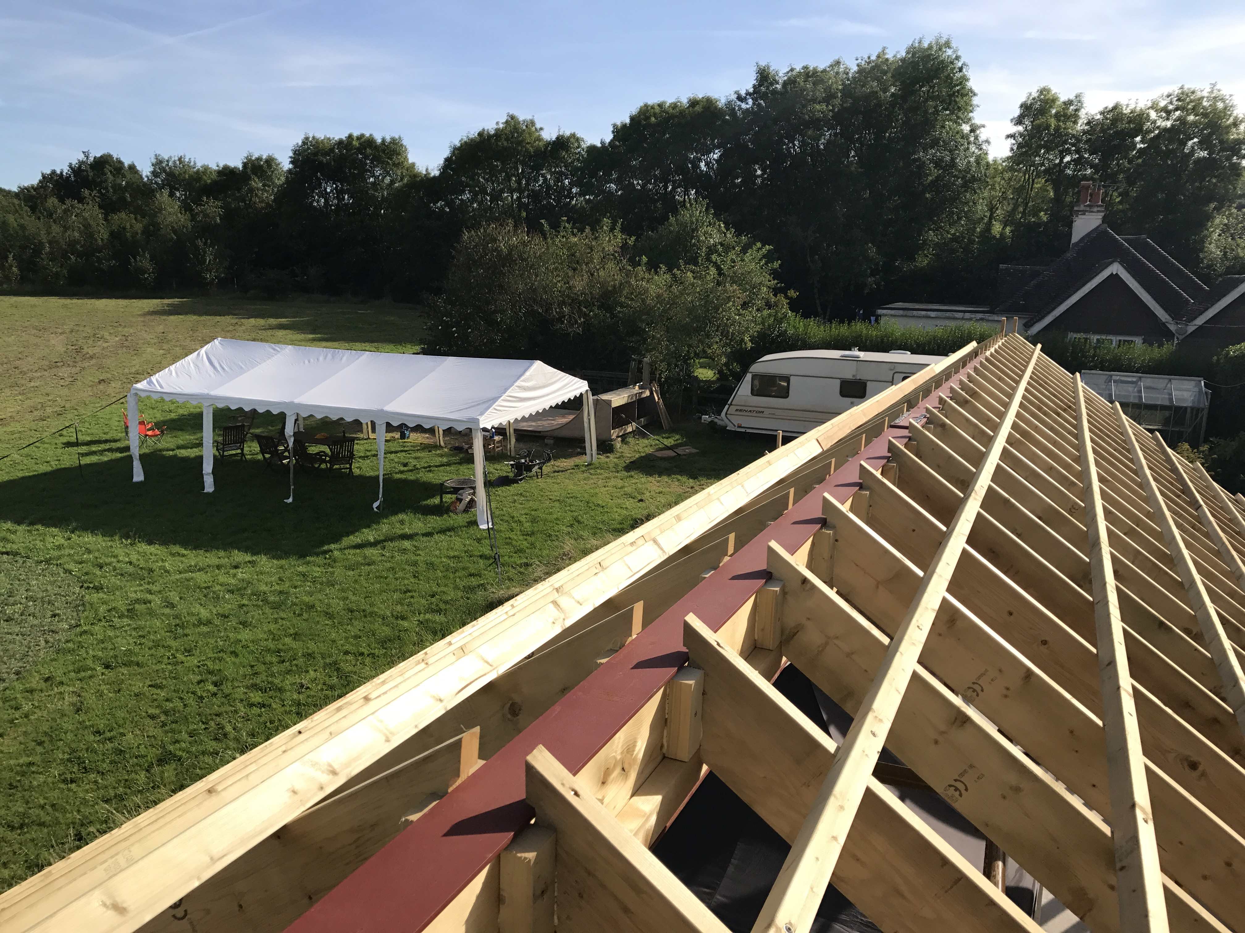

Nestor Posted August 23, 2024 Posted August 23, 2024 This is a detail from our vaulted ceiling. As specified by Structural Engineer.
