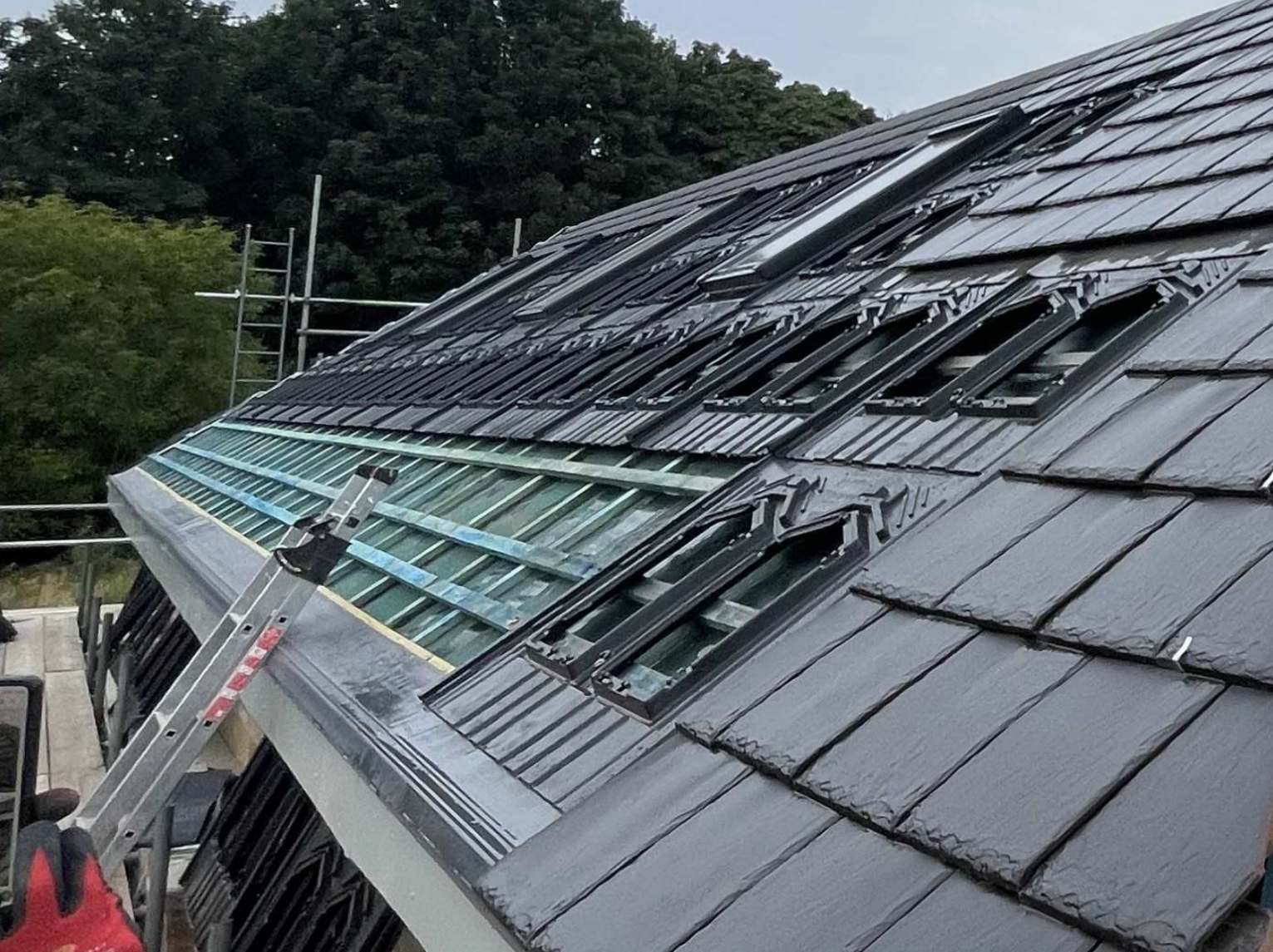

LiamJones Posted August 18, 2024 Posted August 18, 2024 I’ve just done this I used two eaves trays. Yeah they’re not 380mm like to instructions, but enough I was comfortable with. I will do a full write up at some point 1
LiamJones Posted August 18, 2024 Posted August 18, 2024 Osb over rafter memvrane counter batten and at the fascia.. fascia kicked up 70mm above rafter legs eaves tray mebrane 25mm ventilation eaves tray Gse tray solar

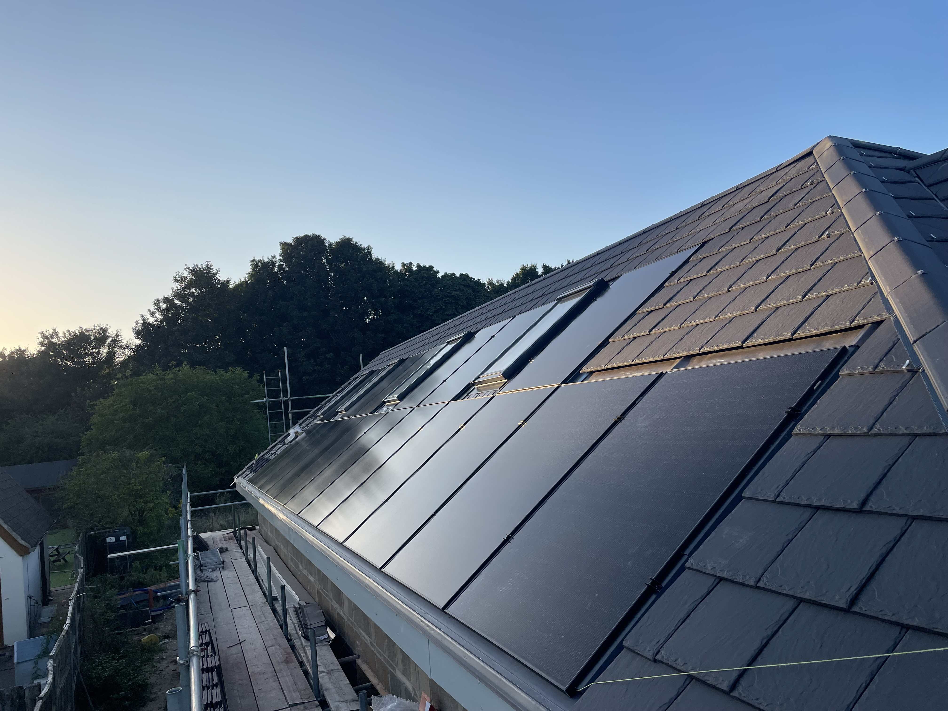

LiamJones Posted August 20, 2024 Posted August 20, 2024 20 hours ago, LnP said: Nice tiles. What are they? Thanks sandtoft rivius antique slate (interlocking clay). Best price I could get was £1.99+vat about 3 months ago 1 1

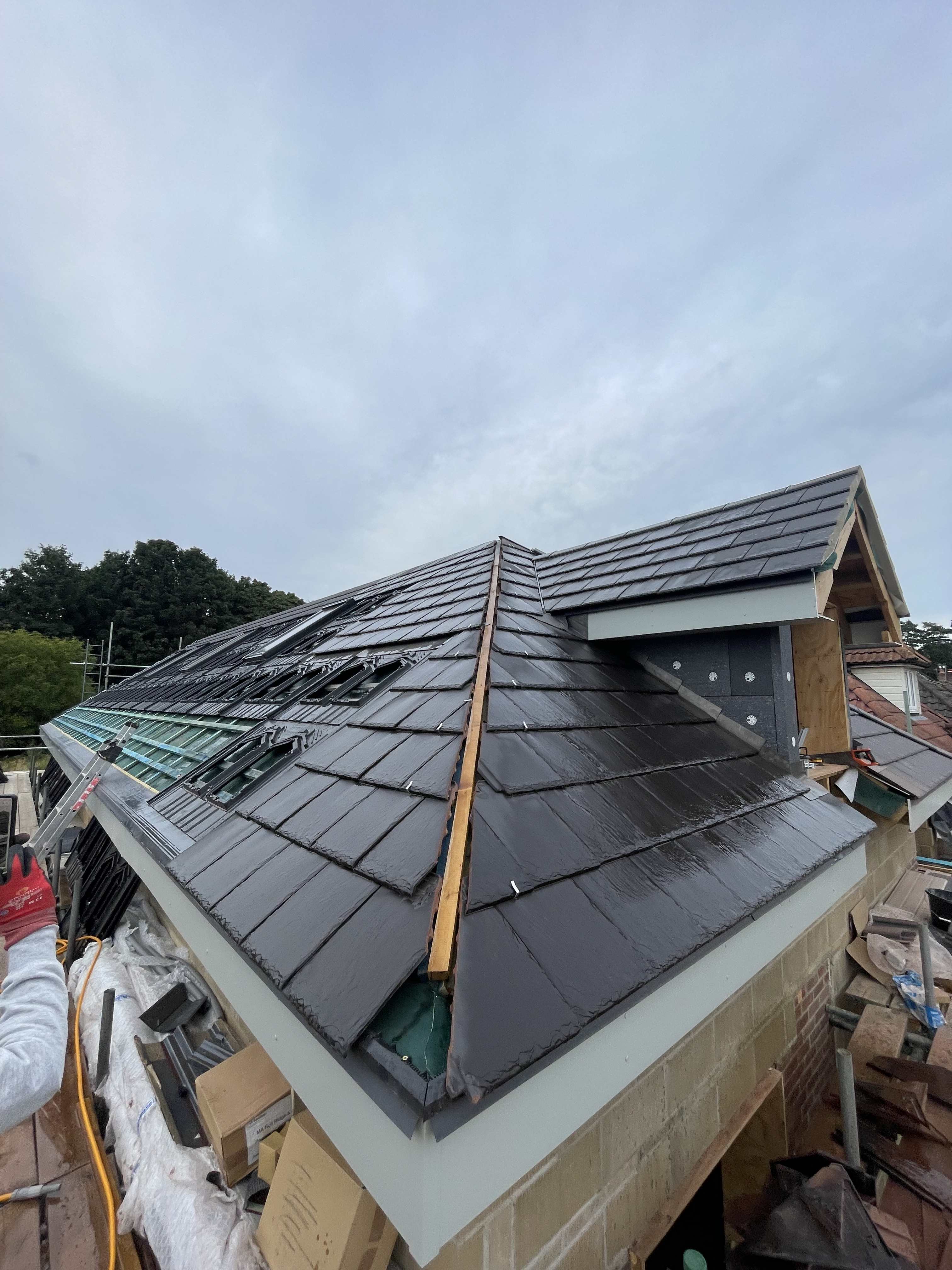

LiamJones Posted March 19, 2025 Posted March 19, 2025 I didn’t have a kick, just bought the fascia up to keep the fall of the tiles consistent all the way down.
LiamJones Posted March 19, 2025 Posted March 19, 2025 Maybe this photo helps? I fitted another eaves tray over the top of the vent and under the gse trays before fitting the panels. This additional eaves tray only spanned the gse trays. At the tiles I had just the one eaves tray. The fascia/vent height was consistent all the way along, however

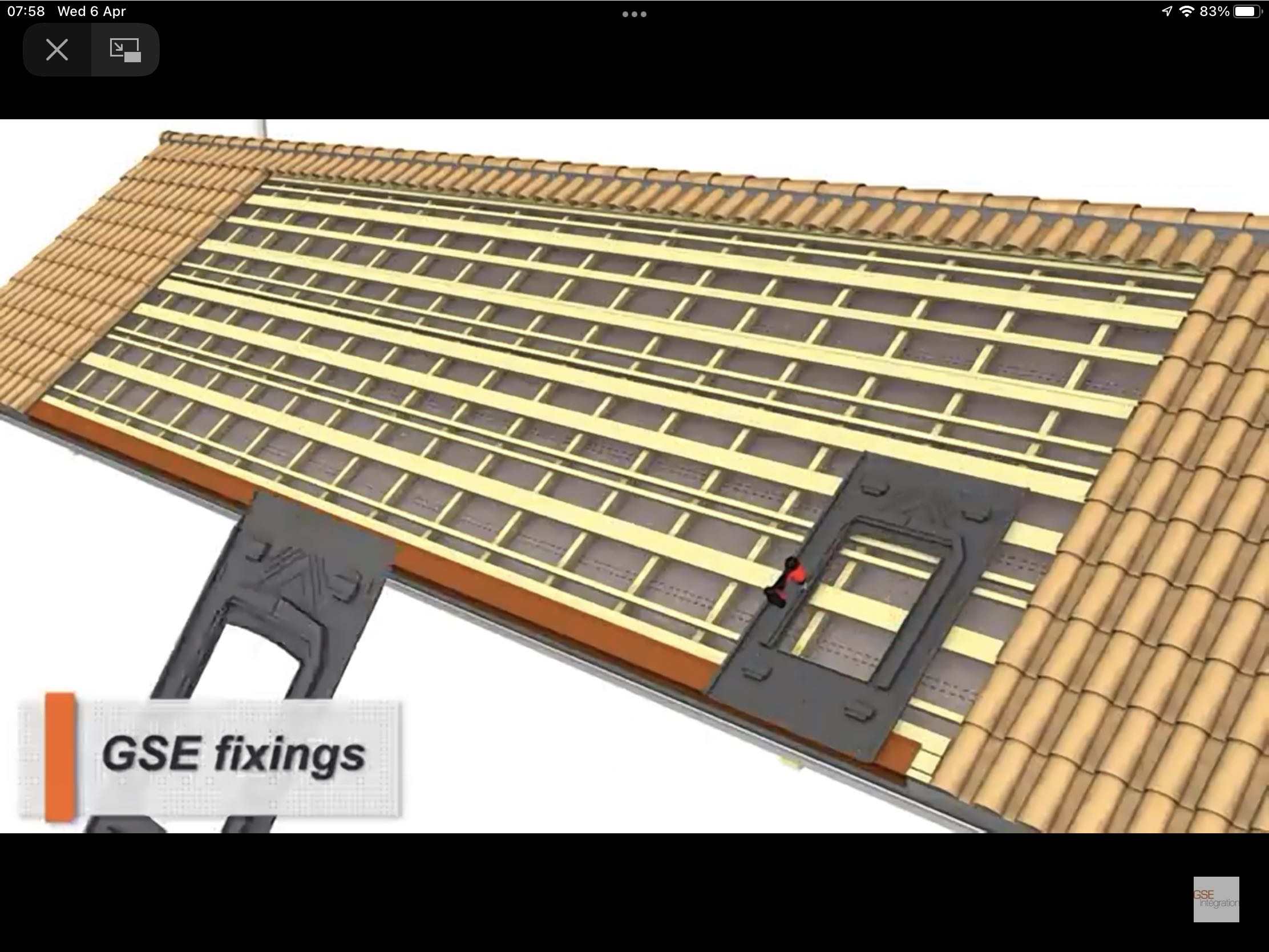

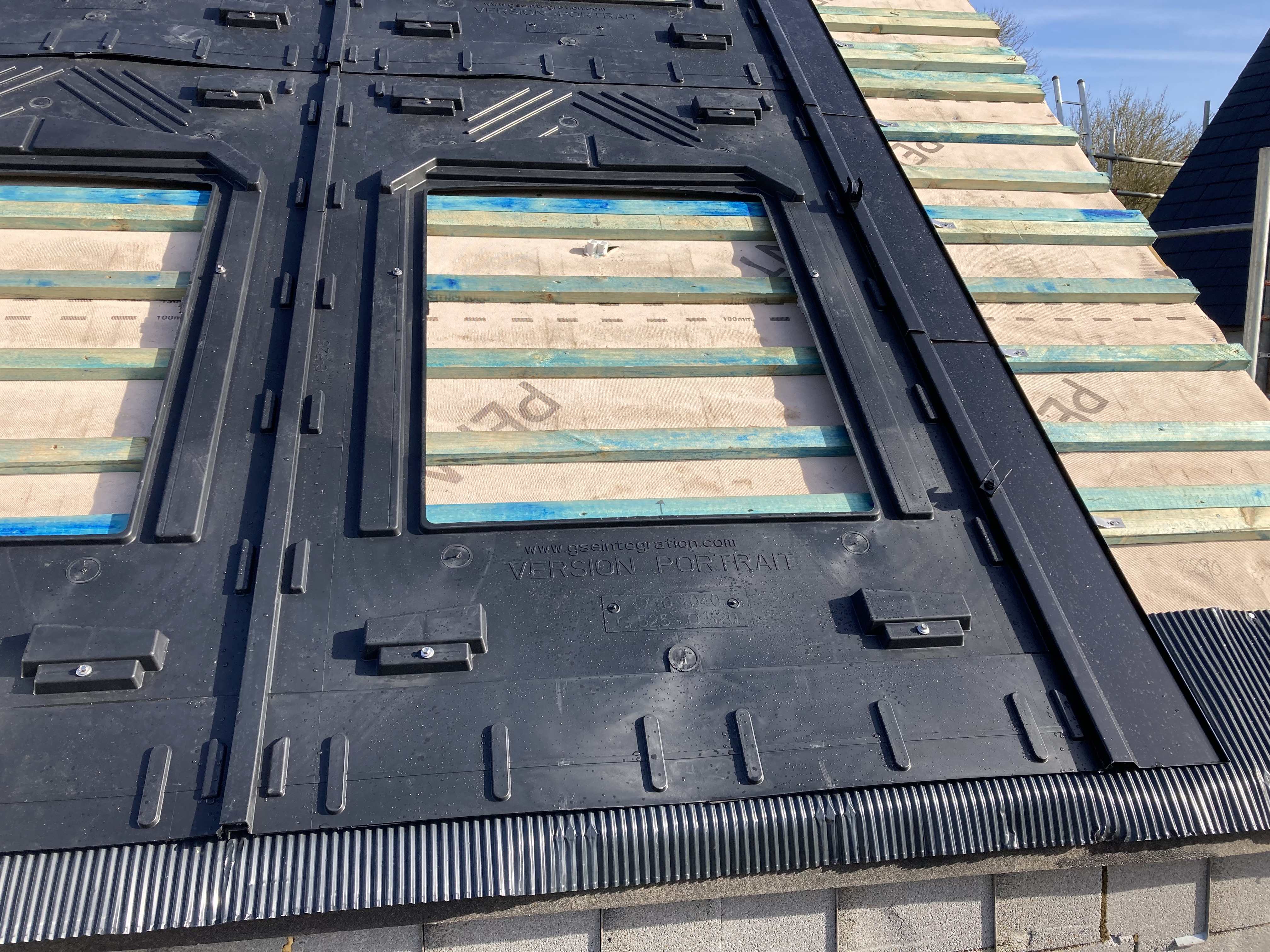

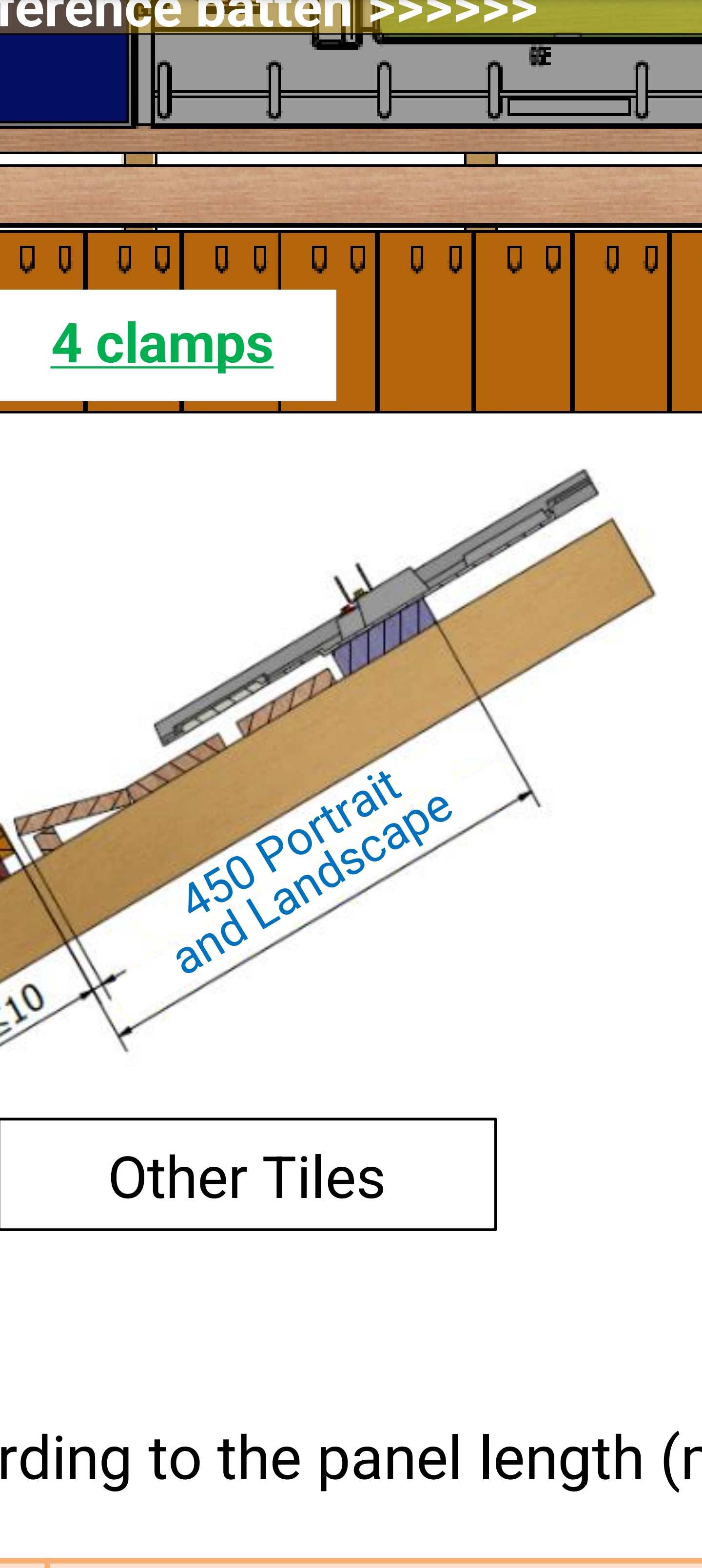

Nick Laslett Posted March 19, 2025 Posted March 19, 2025 (edited) Screenshot from GSE YouTube video. It shows the support to the bottom of roof. The GSE tray on my install. The flashing hides the batten, but you can see the tray is supported. Edited March 19, 2025 by Nick Laslett

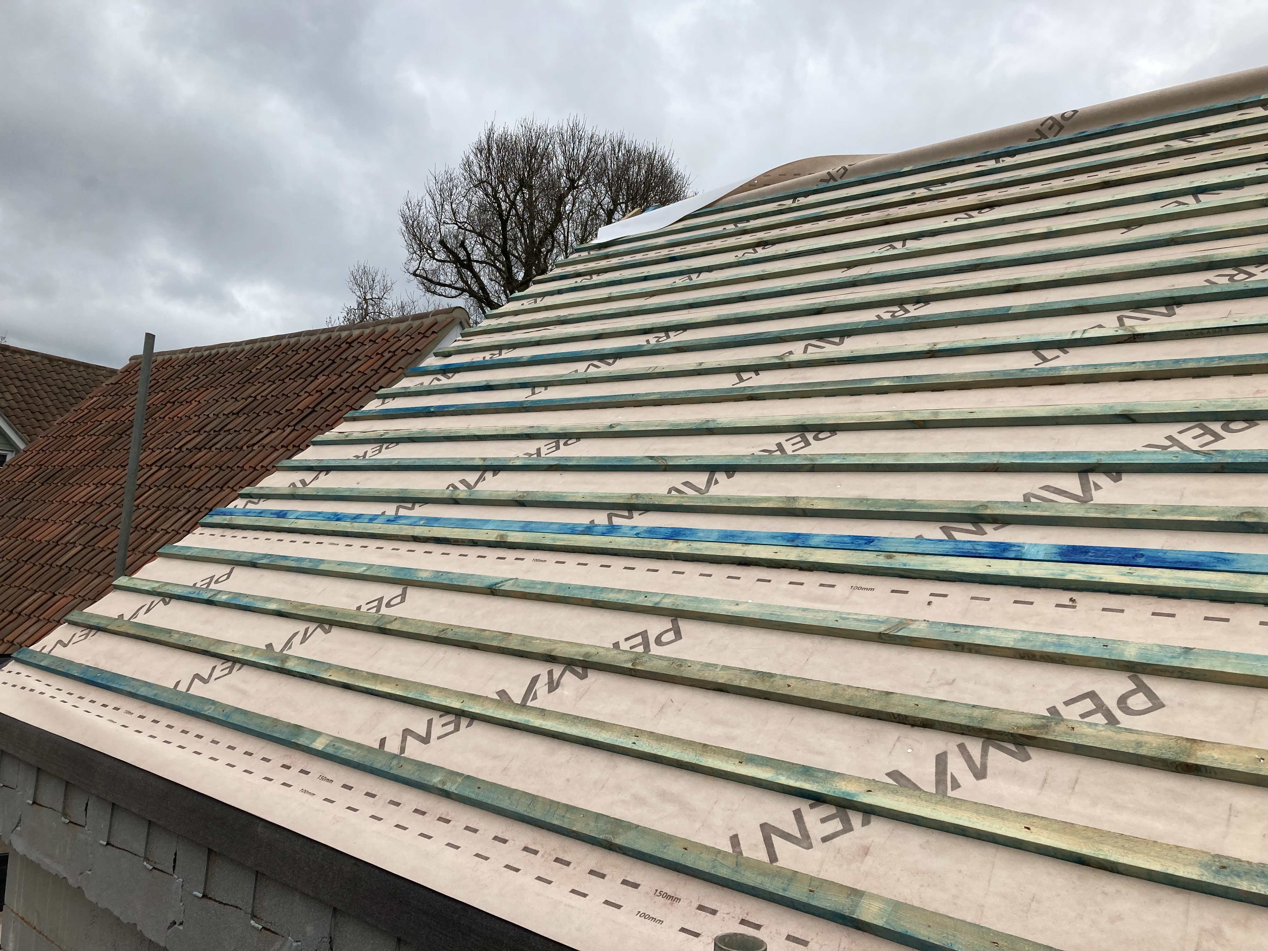

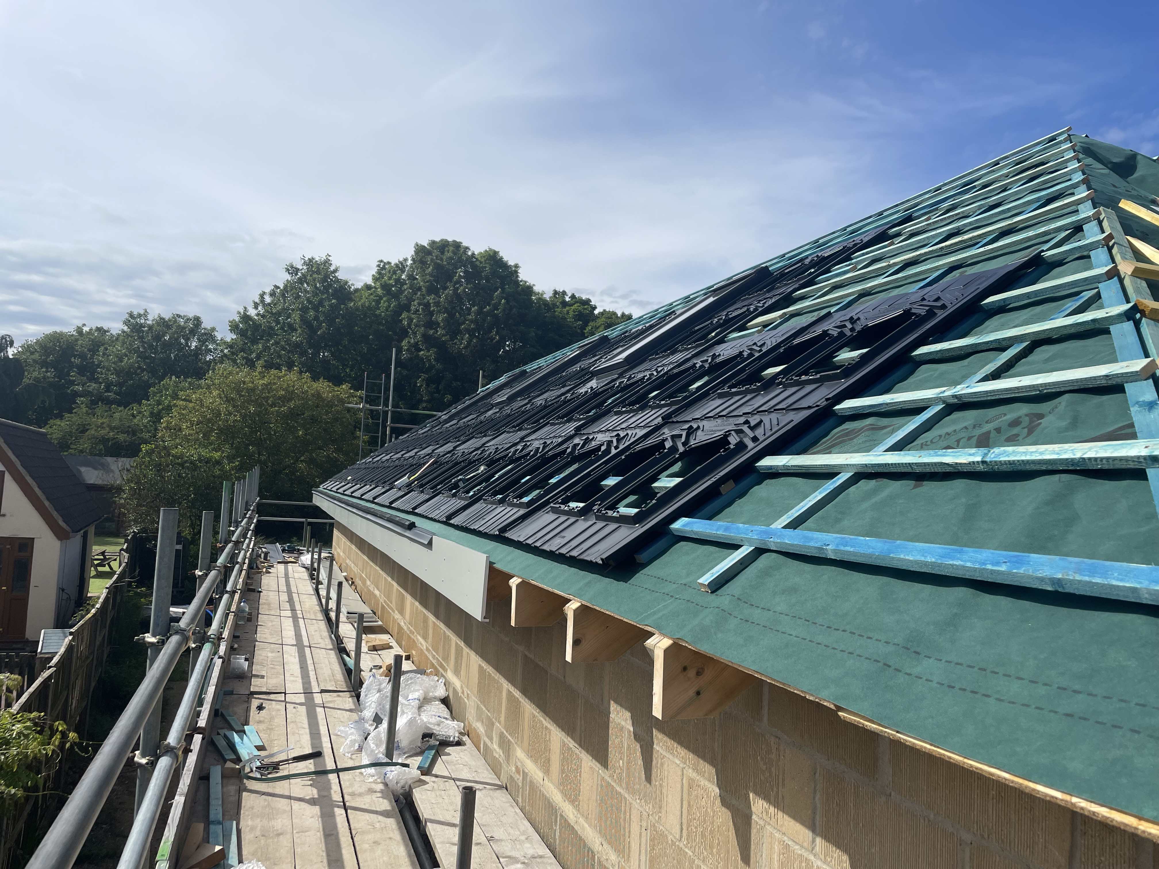

Nick Laslett Posted March 19, 2025 Posted March 19, 2025 (edited) This photo is how the roofers left the roof before I started adding battens and installing the GSE trays. It is hard to see, you will need to zoom in, but there is a piece of roofing felt and roof membrane covering the bottom batten, creating the kick at the end of the roof line, the “tilting fillet”. Edited March 19, 2025 by Nick Laslett
LiamJones Posted March 19, 2025 Posted March 19, 2025 10 hours ago, Mattg4321 said: Didn’t you have any battens supporting the bottom of the GSE trays? There is a gold batten added towards the end of the roofing work, once I was confident of how the eaves detail would work. If you look back at the first photo I posted, you’ll see it 1
