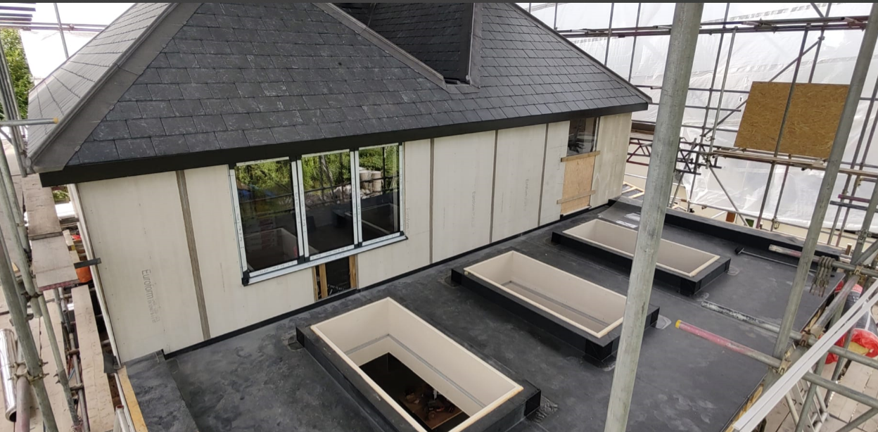

Tetrarch Posted July 13, 2024 Posted July 13, 2024 On 11/07/2024 at 22:14, Jeffb said: Hi what would recommend, I have a 8.6x6.3 flat roof fall 6.3m direction. Having spoken to various installers and suppliers most professionals are recommending Torch on felt as the best product. They say EDPM can become unstuck delaminate wrinkle etc due to expansion and contraction it’s more of a diy product? Does anyone have any experience of these problems with EDPM . I was considering the Thicker Firestone product . any thoughts or experiences much appreciated. thanks Jeff Expand I am a huge EPDM fanboy. I absolutely recognise your situation. I installed my own EPDM loose lay rubber roof in my previous house in 2003 and sold it in 2021. It's still there and I never experienced a single issue. I have insisted on EPDM for our new extension and am delighted with it installed, but, my god, did I have problems finding an installer. Every installer wants to put in the thing that they do and finding a genuine EPDM specialist is very difficult. I don't want felt - it DOES crack eventually and it DOES leak eventually and it does need replacing. In my opinion it's a liability I don't need. I also hate GRP. I had a small GRP roof put over an external fireplace and it barely lasted two years before cracking and losing it's waterproofing abilities. I have no direct experience of the polymer paint stuff, a repair done with this in a commercial property that I help with has also failed, though this was 5 years after the repair I used the thicker Firestone EPDM in my new extension and it is very much tougher than the normal stuff. I'm planning on a green roof at some point, so the thicker membrane seemed like the way to go. Here's a pic of the finished EPDM Good luck and regards Tet 1
