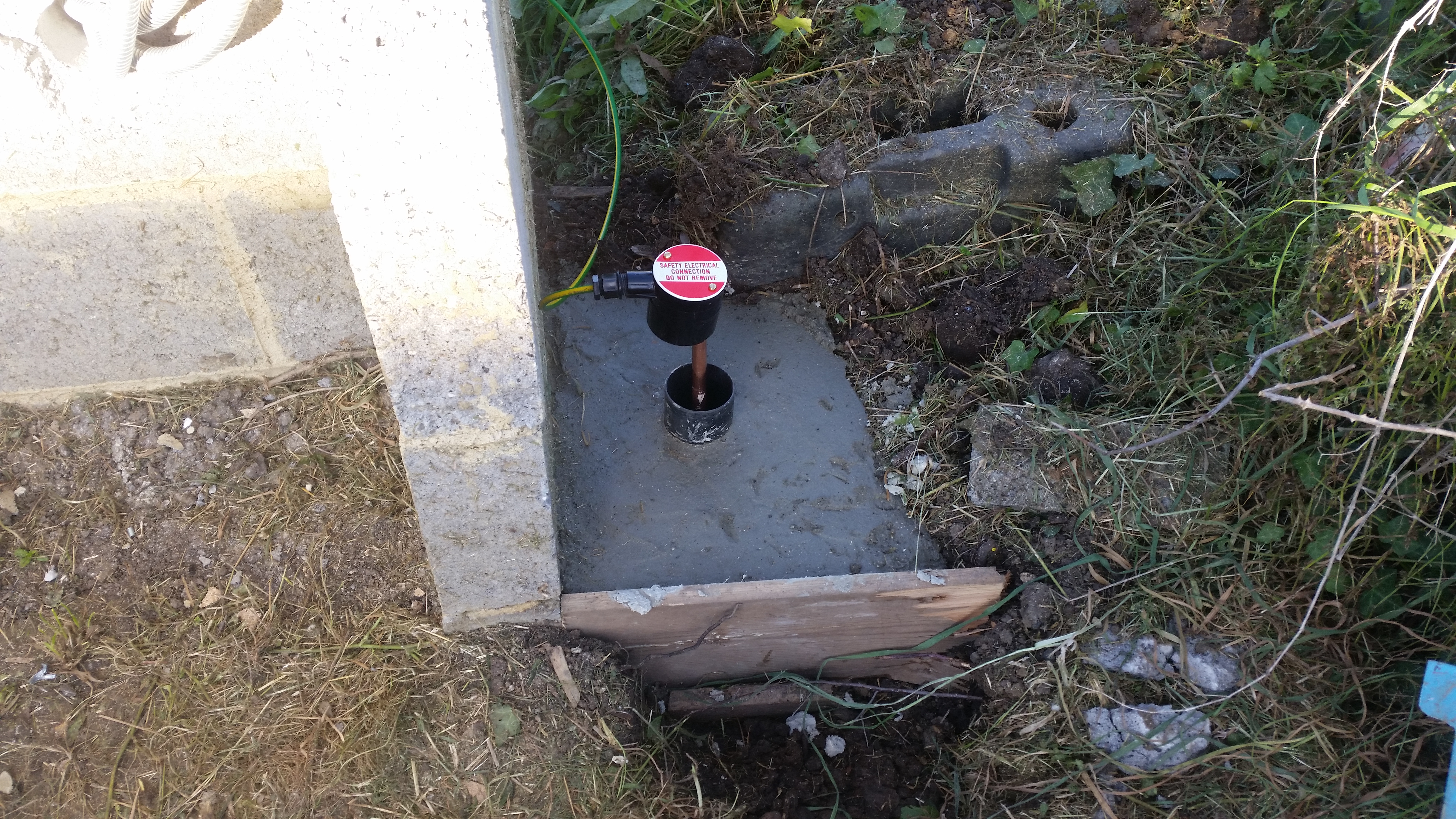

MikeSharp01 Posted October 25, 2017 Author Posted October 25, 2017 (edited) Is THIS the perfect test device for my new earth rod driven in today? It's the trip device in the old house. Although it has a weakness, it basically protects nothing much, the trip is based on leakage to the earth wire and the test button does not work of you remove the earth and behave very carefully. I connected it to the new earth rod and it works perfectly so the new rod must be working at a basic level. No certificate though! Won't UKPN have a test device I can blag a test from / with? Edited October 25, 2017 by MikeSharp01 Typo
Jeremy Harris Posted October 25, 2017 Posted October 25, 2017 Your electrician will have a loop impedance tester, probably built in to a multi test machine, and the measured value of Ze will have to be recorded with the paperwork.

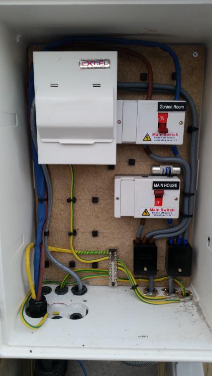

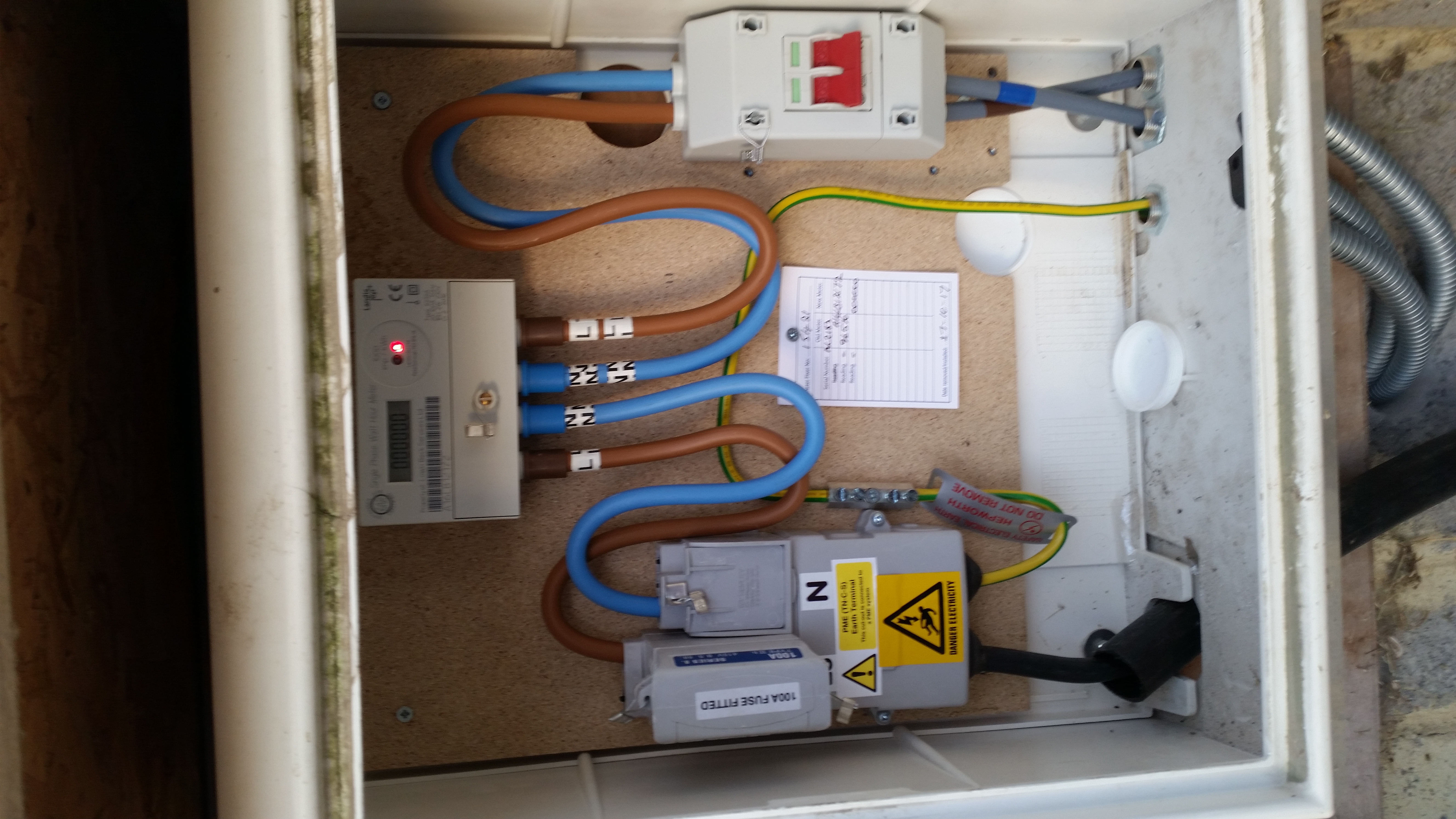

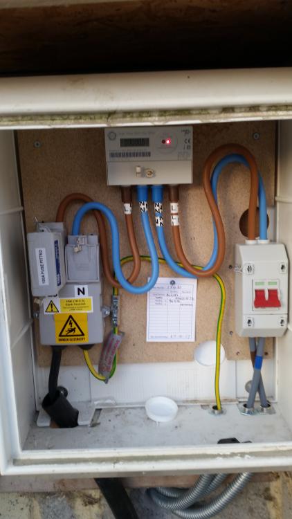

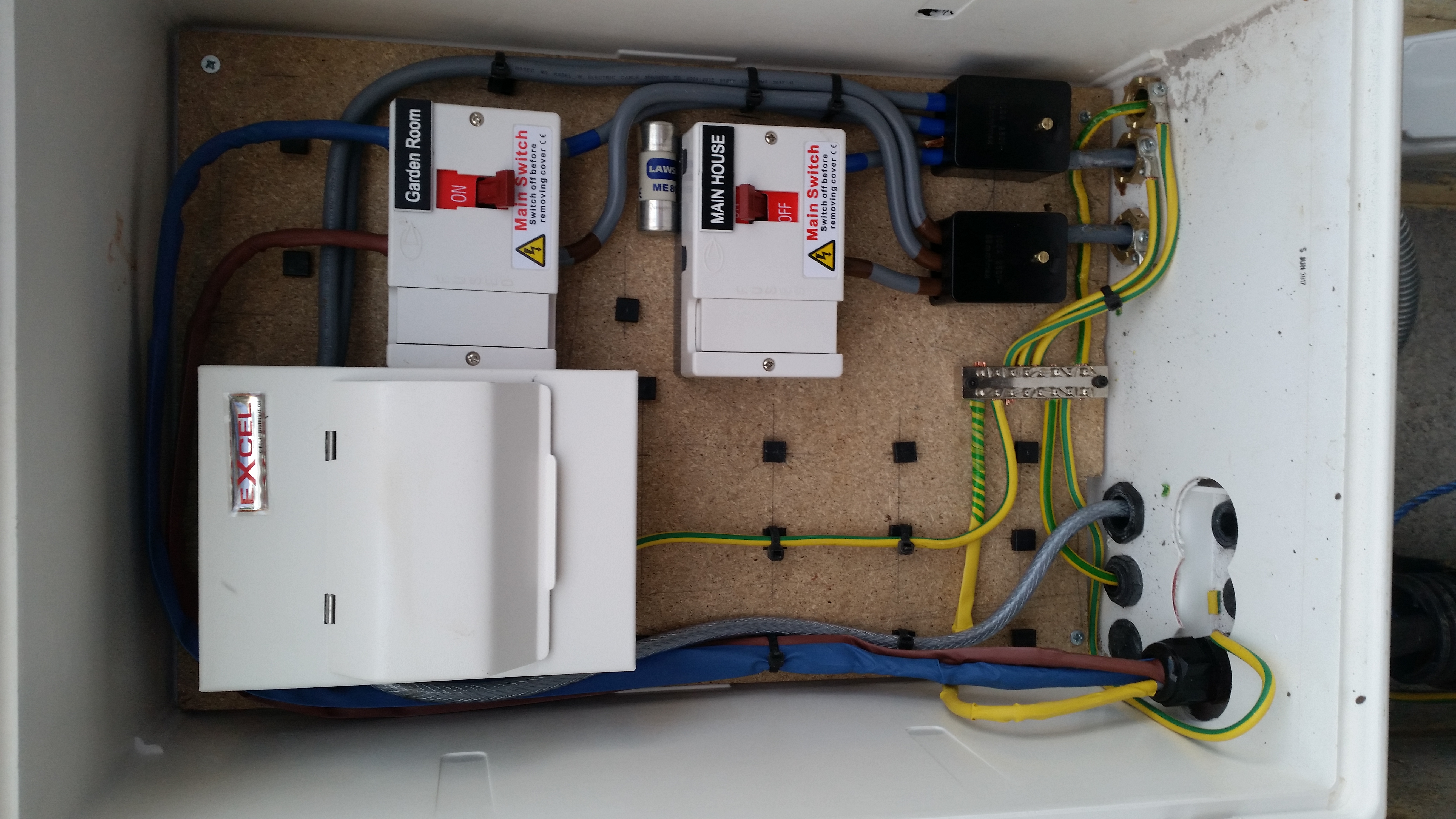

MikeSharp01 Posted October 27, 2017 Author Posted October 27, 2017 Ok its all done, installed and connected. Just thought I would update with a few pics and the test results. The panel as finally complete, rewired to remove all vestiges of single insulation as suggested by @ProDave with split Henly blocks and using the piranha nuts as suggested by @JSHarris and others. All the earths are connected together here both the PME supplied earth and the rod earth I installed. The gland, lower left is screwed into the top of the piranha nut and allows me to shrink wrap (still to be shrunk ) the three cores of the SWA feeding the Garden room and maintain the double insulation, inside the gland, while allowing them to split out. Installed - the earth rod for the utilities centre (This will eventually be inside the building once it gets its frame and cladding): The rather fetching main meter cabinet with the new meter (reading 000000) installed and connected to our main isolator: Interesting to report the readings: Ze for the earth rod was 4.1 Ohm, while Zs was 0.3 Ohms, prospective Fault current 811A and Sort Circuit current of 1324A Down at the Garden room CU (without the local earth rod connected, still to run the cable) the figures were: Ze 0.25 Ohms (Not sure I understood this immediately but think I do now - why is it so much lower than the 4.5 Ohms of the earth rod down the 45m of cable at the utilities centre) Zs 0.37 Prospective fault 693A and short circuit of 928 I am told these reasonable to good!
ProDave Posted October 28, 2017 Posted October 28, 2017 10 hours ago, MikeSharp01 said: Interesting to report the readings: Ze for the earth rod was 4.1 Ohm, while Zs was 0.3 Ohms, prospective Fault current 811A and Sort Circuit current of 1324A Down at the Garden room CU (without the local earth rod connected, still to run the cable) the figures were: Ze 0.25 Ohms (Not sure I understood this immediately but think I do now - why is it so much lower than the 4.5 Ohms of the earth rod down the 45m of cable at the utilities centre) Zs 0.37 Prospective fault 693A and short circuit of 928 I am told these reasonable to good! Ze is the earth loop impedance at the origin , Zs is the earth loop impedance of a particular circuit. So you have Ze 0.3 ohm from the PME earth and 4.1 ohm from the rod. These are both connected in parallel. So your actual Ze at the origin will be a bit under 0.3 Ze at the sun room will be Ze at the origin plus the impedance of the cable, so 0.25 sounds suspiciously low.
MikeSharp01 Posted October 28, 2017 Author Posted October 28, 2017 (edited) 3 hours ago, ProDave said: Ze at the sun room will be Ze at the origin plus the impedance of the cable, so 0.25 sounds suspiciously low. Yes, as I said I was not sure I understood this at the outset - when he did the test in the Garden room I mentioned that I did not understand why it was so low, he said that is can vary and repeated the test but the max reading was 0.27 the electric board people gave Ze (They called it Earth Loop Impedance) at the PME junction box as 0.1 Ohm so maybe the 0.3 at the distribution panel (350mm of 16mm2 earth tail away from the PME earth) was out because 4.1 and 0.1 can get to 0.25 I suspect even down 45m of 16mm2 cable. Edited October 28, 2017 by MikeSharp01 Typo
