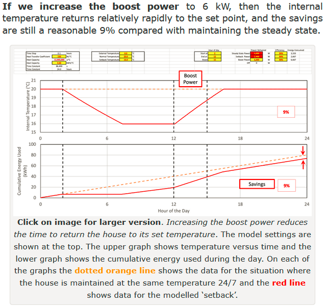

DamonHD Posted July 15, 2024 Author Posted July 15, 2024 (edited) A key point which only became clear to me from a throw-away remark from one of the peer reviewers: the bad setback effect is forced by having rads only just large enough for the no-setback state. This suggests always at least slightly oversizing rads if you can. Edited July 15, 2024 by DamonHD
JohnMo Posted July 15, 2024 Posted July 15, 2024 48 minutes ago, DamonHD said: A key point which only became clear to me from a throw-away remark from one of the peer reviewers: the bad setback effect is forced by having rads only just large enough for the no-setback state. This suggests always at least slightly oversizing rads if you can. So question is do you need a higher flow temp to allow you play catch-up, once out of setback? if so how is this managed? Also do you allow in the calculations the heat pump running a full or increased load for a few hours to to recover from a set back. Obvious question is why would you bother, with the added complexity, cost to install other stuff and then have to fine tune for steady state, setback and recovery from steady state.
sharpener Posted July 15, 2024 Posted July 15, 2024 40 minutes ago, DamonHD said: the bad setback effect is forced by having rads only just large enough for the no-setback state Ah, so ideally you need rads which are big enough to cope also with the heat leaks to the setback rooms. Yes we are getting 6 rads changed for bigger ones, required uplift factor 1.9x. In one of the study/bedrooms this is not quite achievable bc of furniture but fitting foil and having it plumbed TBOE will help a bit. Your paper concludes Using common open-loop weather compensation (radiator flow temperature driven by external temperature only) eliminates the bad setback effect, and indeed saves a little extra energy. This is in return for a small sag in temperature for A rooms, though likely well within tolerable bounds. But this doesn't really eliminate the bad setback effect. If the "small sag in temperature" is "tolerable" then you could turn the setpoint/WC slope down by a corresponding amount all the time and make even greater savings! To respond to what @JohnMo has just posted, we have already got the wireless TRV setup so it is a question of optimising how to use it. I certainly wouldn't be fitting it from new when installing the heat pump. But it does allow flexible zoning by time and temperature and this will I think be useful. As a specific example I envisage using the UFH to heat the living room 18/24 to a setback temp of say 16C, there are also rads which will quickly bring it up to 20C at 1700 using off-peak heat from the thermal store. The ceiling is very leaky so this will provide the two bedrooms above with background heat as well. Only when they are in use for guests will they be heated to 18C, I cannot think that heating them all the time will save money. Verifying all this experimentally will be very complex when I also pose the question Will Octopus Cosy with its 3 periods at 10p/kWh be better than Octopus Intelligent Go with a single 6 hours at 7p plus whatever is achievable by gaming their algorithm by playing with the EV charging times?

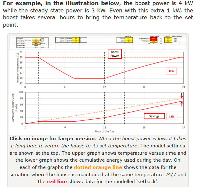

sharpener Posted July 15, 2024 Posted July 15, 2024 In the article linked to above Michael Podesta shows that without a boost phase you might save 12% but the recovery time is impossibly long. He suggests that you need 6kW boost power (where the steady-state is 3kW) to get a recovery time of 3 hrs and this reduces the savings to 9%. Also if the CoP falls from 3.0 to 2.5 then the savings are more than wiped out. Clearly if the OAT is such that you do not have 100% overcapacity to play with you cannot do this, and in the limit you dare not have any setback at all or you can never recover. Otherwise you will have to choose which rooms you can heat at any one time.
