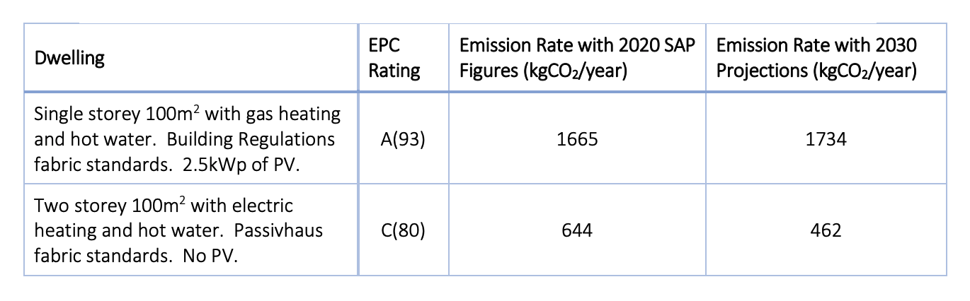

garrymartin Posted July 6, 2024 Posted July 6, 2024 EPC is severely flawed and can be "gamed" very easily. See the below for just one example from https://www.passivhaustrust.org.uk/UserFiles/File/research papers/EPCs/2020.04.17-EPCs as efficiency targets-v9.pdf 1

JohnMo Posted July 6, 2024 Posted July 6, 2024 2 minutes ago, garrymartin said: EPC is severely flawed Are they not using the 2020 EPC yet which account for the changes in electricity CO2.

saveasteading Posted July 6, 2024 Posted July 6, 2024 1 minute ago, garrymartin said: EPC is severely flawed and can be "gamed" very easily. See the below for just one example Yes it can, but not significantly. My business rented the programme for a year and we played with it a lot. It had lots of flaws, which i hope have been sorted. And nonsense such as assuming that heat pumps were used for cooling regardless of the setup, and a bad thing altogether. But you need something so it needs to be this.

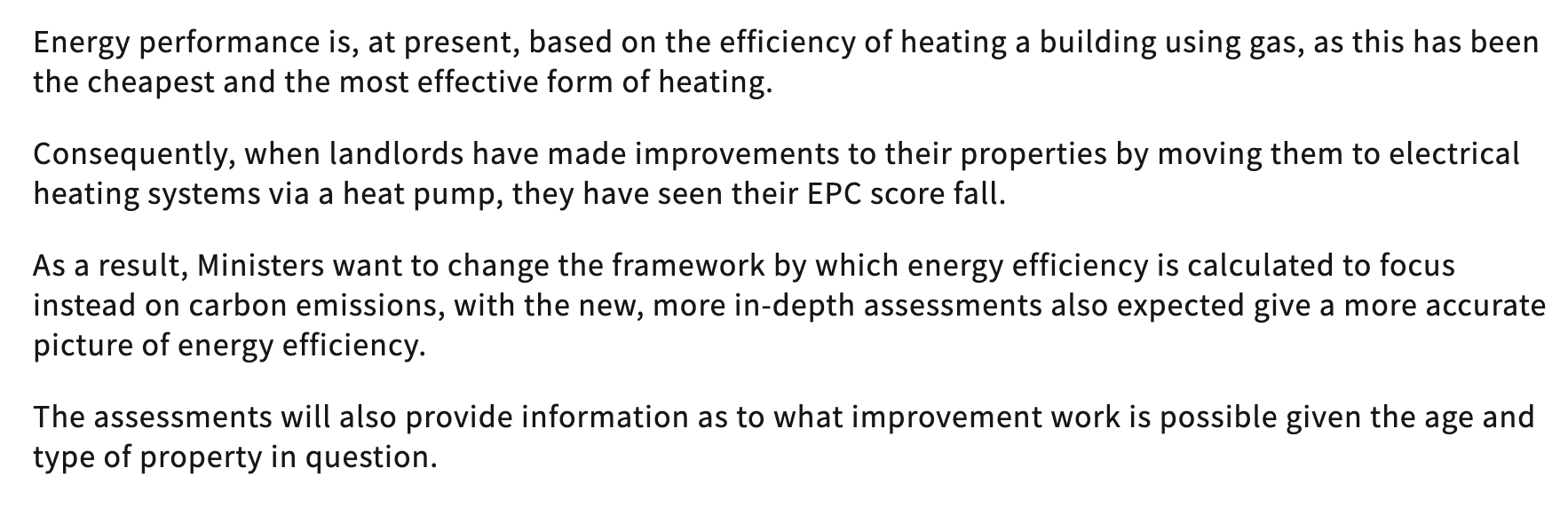

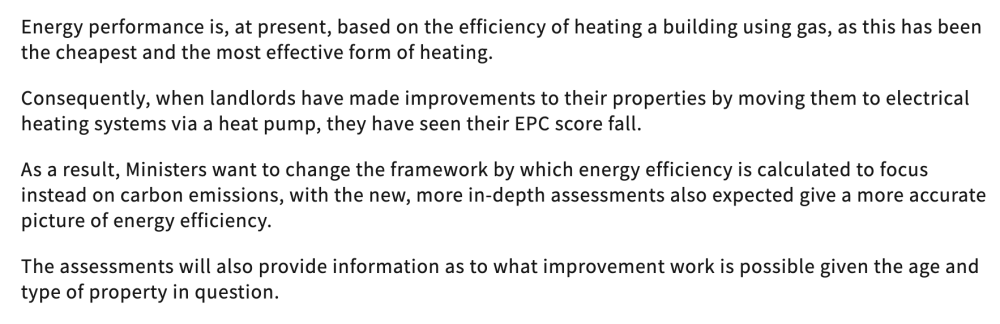

garrymartin Posted July 6, 2024 Posted July 6, 2024 5 minutes ago, JohnMo said: Are they not using the 2020 EPC yet which account for the changes in electricity CO2. No idea. To be honest though, I thought it was recognised that EPC was flawed. At least before the changes this week, the government was consulting on a new Home Energy Model...
