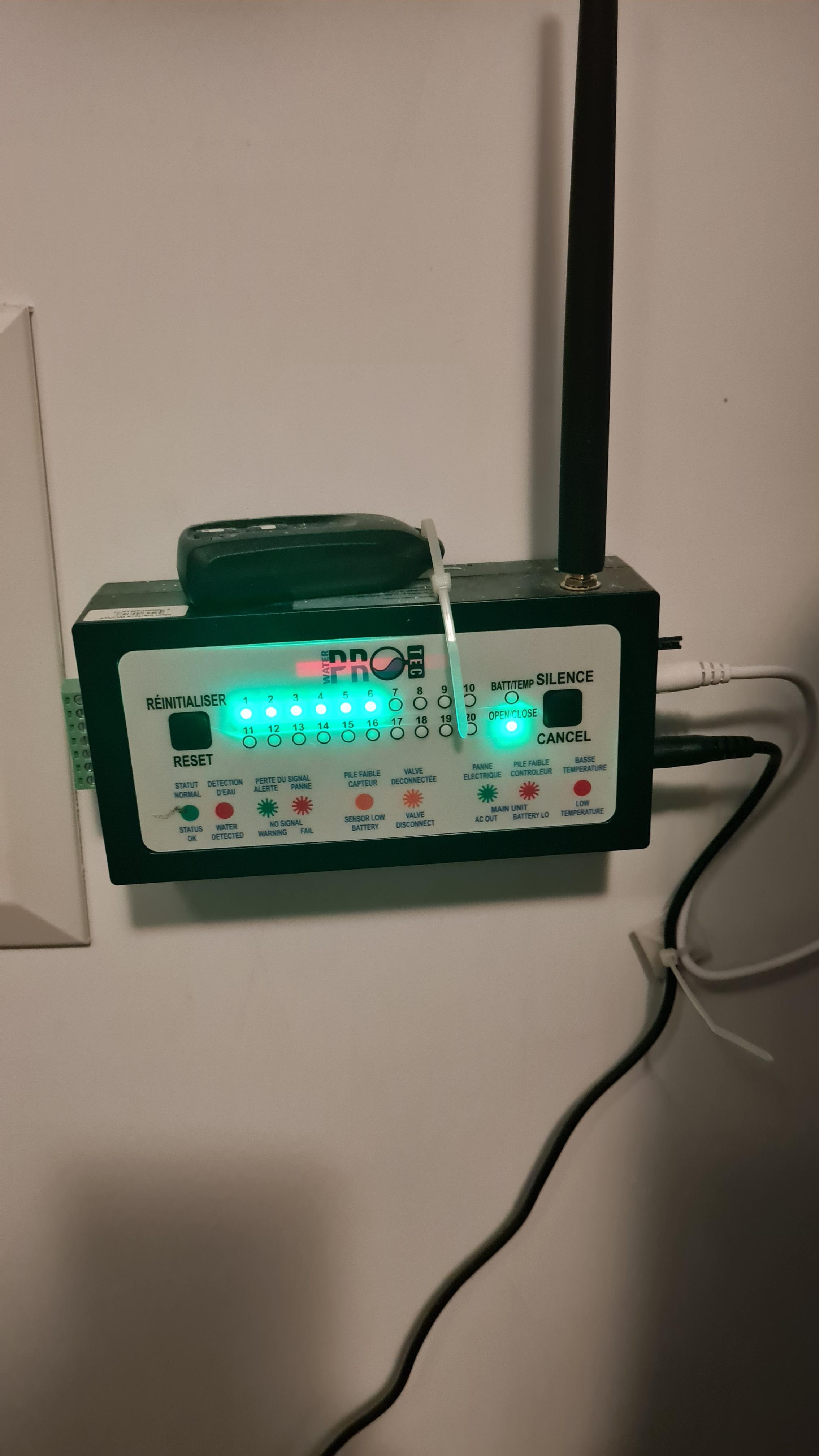

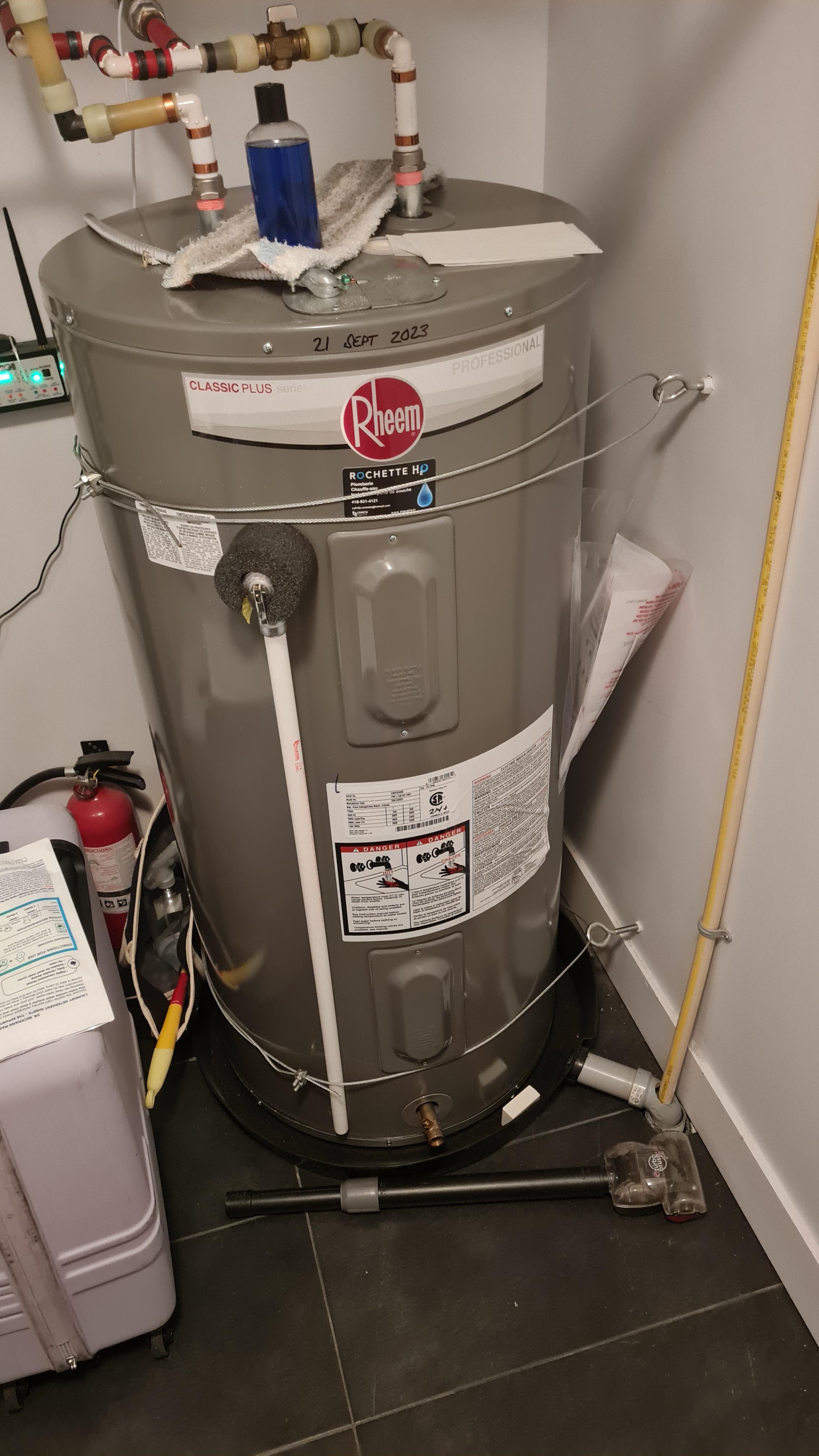

Tennentslager Posted July 4, 2024 Share Posted July 4, 2024 I'm currently in a rental in Quebec and the tank is in a tray, with a drain. Also the wee white thing is a sensor which turns off the water in event of a leak.T Link to comment Share on other sites More sharing options...
