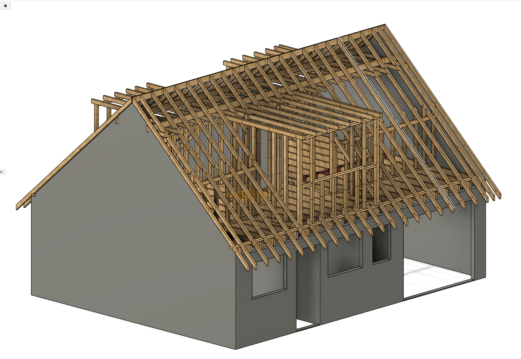

Del-inquent Posted June 29, 2024 Posted June 29, 2024 I'm trying to get an extension to our dormer sorted. 2 SE's I've spoken to so far have said it can only be done by inserting a steel. This is despite several neighbours having done the same thing with no steels involved. One SE has said we'll have to put all new joists in because we're converting a bungalow to living space in the roof. He couldn't seem to grasp that as a chalet the house was built to have living space up there and it already has joists large enough for the span. Question is - how would steels totalling 9m long be fitted inside a chalet bunglaow roof, without taking the entire roof off? Can't put in in from the sides outside as we have neighbours either side, and I don't think either would be too happy about me punching a hole through their house so I could stick a steel in mine... Both SE's have just said "your builder will know how to do it". Well I was planning on doing the whole thing myself when I thought it could be done in timber. Now I've been told it has to have a steel I've asked a couple of roofers. Both have said "how does the SE propose we get a steel in without taking the roof off". With an explanation that they can't take out the collars and ties because they are linked to the existing dormers, so they can't "angle it up in there". Am I just talking to the wrong people? Is there a way to do it? 1

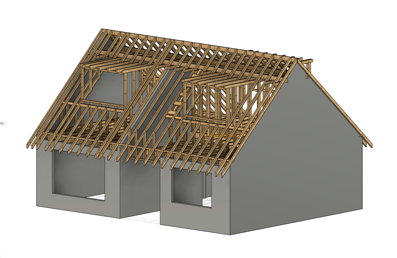

Del-inquent Posted July 1, 2024 Author Posted July 1, 2024 8 hours ago, joe90 said: Yes, so what are you altering within the roof structure that makes the beam necessary? At the moment there are two dormer windows on the front, one full room dormer on the back which covers just over 1/3rd of the length of the roof. I want to extend the rear dormer on either side so that I can move the current bedroom along a bit and get a bathroom in beside it.
joe90 Posted July 1, 2024 Posted July 1, 2024 Ah I see, if the large dormer is flat roofed it’s normal to instal a ridge beam which is usually steel.
Del-inquent Posted July 1, 2024 Author Posted July 1, 2024 4 minutes ago, joe90 said: Ah I see, if the large dormer is flat roofed it’s normal to instal a ridge beam which is usually steel. That's what one of the SE's suggested. The other wanted two steel purlins. None of the neighbours I've spoken to have either, but they were done a long time ago. If one has to go in, it has to go in, but I cannot work out how it could be done without taking the entire roof off. The SE's just say that "the builder will be able to do it" when I ask how. When I speak to roofers for quotes, they ask me to ask the SE's how it's supposed to be done 😅 I have had an issue with a SE in the past on a renovation / extension. They wanted about £6k worth of steels put in. Another looked at it, took all the steel out and put in two 8 inch wooden posts instead. Which is what the roofer had suggested when he saw the plans. I guess I've become a little wary of SE's since.

joe90 Posted July 1, 2024 Posted July 1, 2024 @Del-inquent I really think we need some drawings, even pencil sketches to understand your house make up and what you propose.
Del-inquent Posted July 1, 2024 Author Posted July 1, 2024 8 minutes ago, joe90 said: @Del-inquent I really think we need some drawings, even pencil sketches to understand your house make up and what you propose. This is the rear dormer I want to make wider first (external leaf removed) and the current front dormer windows. Accurate to 5mm
ProDave Posted July 1, 2024 Posted July 1, 2024 And where in those views does your SE think a steel is needed?
