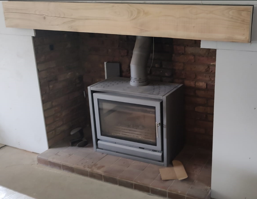

Nickfromwales Posted Tuesday at 15:26 Share Posted Tuesday at 15:26 On 01/07/2024 at 07:48, saveasteading said: In a sealed circuit wbs there is no air intake from the room. Yes, my point is relevant to the OP who hasn't installed a RS appliance. 1 Link to comment Share on other sites More sharing options...

JohnMo Posted Tuesday at 15:35 Share Posted Tuesday at 15:35 On 01/07/2024 at 14:04, Tetrarch said: Is it possible to use something like this as a manual vent Doesn't comply with building regs. Link to comment Share on other sites More sharing options...

Mike Posted Tuesday at 18:27 Share Posted Tuesday at 18:27 A fully room-sealed stove is undoubtedly the way to go, but also worth knowing that some MVHR units - those from Zehnder, at least - include an optional 'chimney' mode that can reduce the risk of air being pulled back from a chimney. Presumably it maintains a positive pressure in the house. Link to comment Share on other sites More sharing options...
