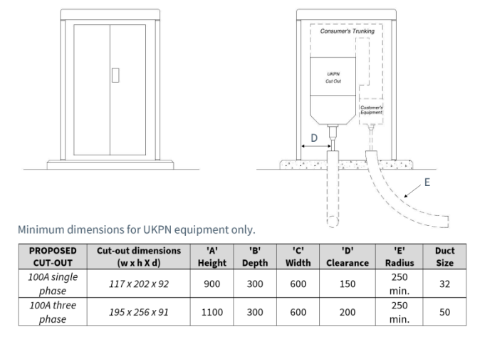

saveasteading Posted June 23, 2024 Posted June 23, 2024 Having a precise specification from UK Power for a new 3 phase supply, I was surprised to see so many different sizes being available, and it is not easy or quick to compare sources. Many are slightly smaller which seems very odd. w600 xH1100 X d300 is the requirement and here is one such. It seems expensive for what it is, and such a standard unit. Any suggestions please? Free Standing GRP Electric Meter Box Green – W600 x H1100 x D300mm, GRP Cabinet , GRP Kiosk £691.20 Incl. VAT

saveasteading Posted June 24, 2024 Author Posted June 24, 2024 6 hours ago, Mr Punter said: these people: GRP ELECTRIC METER BOX W605 X H1150 X D320 MM , NEW ELECTRICITY CONNECTION £618 incl VAT so that is the right direction thanks. 5 hours ago, Kelvin said: it fell off quickly after installing it Ahhh. I will bear that in mind. Also re the size. For interest , why do they make 72 variations? I was starting to think the box might be too small. We are going to have a 60m cable onward from there to the house. The location is to stay within 25m of the pole, and keep it as 'minor' works. The box and connection is going in earlier than we wanted, but to please the neighbour/ vendor.
saveasteading Posted June 24, 2024 Author Posted June 24, 2024 3 hours ago, Alan Ambrose said: are you allowed to put a CU and say a router inside too? Good question. I will accept any and all advice on this subject please. I don't have an electrician yet , hence needing early advice. such as.... are these radius ducts standard things? do they have to point one to the rear and one to the side as shown? Chuckle. I was thinking of going all diy and amateur and buying 3 bags of ready-mix to make the base. I saw reviews of it, and at first thought they were wind-ups... *when you buy a bag of "Concrete" you don't expect half of it to be chippings! no mention of this in description just a waste of money *Absolutely crap and useless stuff!!!! Most of it are stones! The rest is runny water based- cement colour water!!!! Avoid! Waste of money I wish I would just buy bag of cement and sand. This amount of stones is only half bag of 20kg total bag!!!! And grey water. Disgusting. I have a feeling they both added too much water. 1

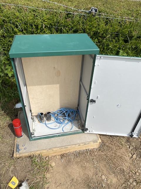

Kelvin Posted June 25, 2024 Posted June 25, 2024 You can point the ducting any direction you like obviously. I used 3 x 38mm diameter hockey sticks. One in one out and one spare just in case. However that was a mistake as it made getting the thick unwieldy cables in chuffing hard. I should have used corrugated smooth wall stuff so don’t do what I did. I also just used 3 bags of readymix concrete. It’s perfectly fine and made a really nice base. They never followed the instructions as you say. 1

saveasteading Posted June 26, 2024 Author Posted June 26, 2024 I've just had a plastic box for a temporary supply. Its horrible, wobbly, difficult to shut and open. It was bought by the electrician from an electrics merchant. and was cheap. It will have to do. I'm hoping that any grp ones for the mains will be subject to some minimum standards.

flanagaj Posted September 16, 2025 Posted September 16, 2025 On 25/06/2024 at 19:02, Kelvin said: You can point the ducting any direction you like obviously. I used 3 x 38mm diameter hockey sticks. One in one out and one spare just in case. However that was a mistake as it made getting the thick unwieldy cables in chuffing hard. I should have used corrugated smooth wall stuff so don’t do what I did. I also just used 3 bags of readymix concrete. It’s perfectly fine and made a really nice base. They never followed the instructions as you say. Do you have to use hockey sticks into the cabinet. Can you instead just use the 100mm twin wall ducting straight into the chamber?
Kelvin Posted September 17, 2025 Posted September 17, 2025 (edited) 10 hours ago, flanagaj said: Do you have to use hockey sticks into the cabinet. Can you instead just use the 100mm twin wall ducting straight into the chamber? You can. I ought to have done for the house mains as it would have made things easier. The SSEN guidelines were really specific about the ducting to use in the trench which I couldn’t get. I called them about it and they said go with the guidelines. I spoke to my sparkie son in law and he said as long as it’s black the linesmen won’t care (and they didn’t). Edited September 17, 2025 by Kelvin
saveasteading Posted September 17, 2025 Author Posted September 17, 2025 55 minutes ago, Kelvin said: as long as it’s black And yet the one i bought with the kiosk was white on the long leg and red on the short leg. It was too narrow for the big cable so I used a bigger black pipe without issues.
Kelvin Posted September 17, 2025 Posted September 17, 2025 36 minutes ago, saveasteading said: And yet the one i bought with the kiosk was white on the long leg and red on the short leg. It was too narrow for the big cable so I used a bigger black pipe without issues. What he meant was the stuff they specifically specified was black and had to meet certain standards. He said the linesmen won’t look at the specification stamped on the ducting. The slightly annoying thing was they brought ducting with them as they thought they were putting it in the trench I dug and it was the same stuff I used 😂
