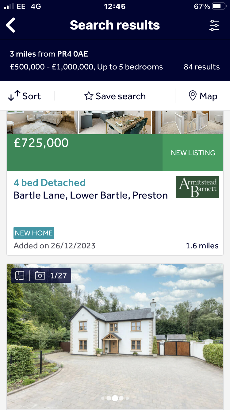

nod Posted June 20 Share Posted June 20 We laid just over 400m2 on our previous build No maintenance 5 years on 3 Link to comment Share on other sites More sharing options...
richo106 Posted June 20 Author Share Posted June 20 5 minutes ago, nod said: We laid just over 400m2 on our previous build No maintenance 5 years on They look good! Love the raised kerbs/edging stones Link to comment Share on other sites More sharing options...
