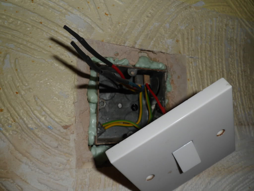

Onoff Posted February 12, 2018 Share Posted February 12, 2018 I was kidding about the foam! Link to comment Share on other sites More sharing options...
Construction Channel Posted February 12, 2018 Share Posted February 12, 2018 25 minutes ago, Onoff said: I was kidding about the foam! I was just waiting for someone to suggest lining paper ? Link to comment Share on other sites More sharing options...

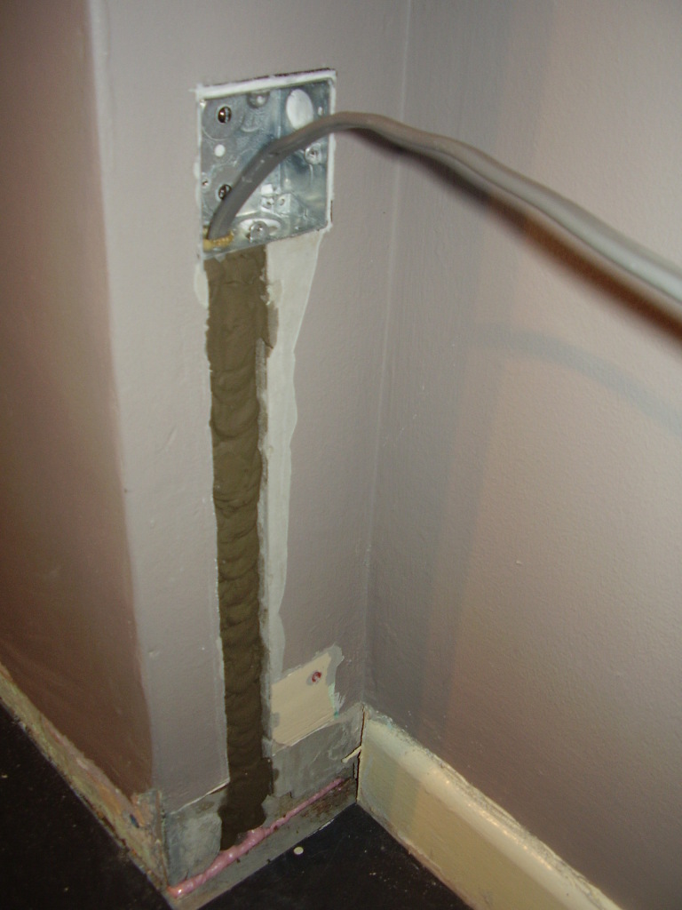

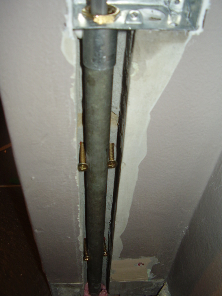

Onoff Posted February 12, 2018 Share Posted February 12, 2018 Mortar gun works a treat for pumping muck into a chase. Leaves a nice ribbed finish for the plaster to key to. Tbh this whole corner block, render & plaster was so live the conduit served to keep it there! Chased with a multitool. Link to comment Share on other sites More sharing options...
ToughButterCup Posted February 12, 2018 Author Share Posted February 12, 2018 5 minutes ago, Onoff said: Mortar gun works a treat for pumping muck into a chase. [...] Oh, the delicious irony. Just bought one and found I didn't need it. But I do now. Link to comment Share on other sites More sharing options...
Onoff Posted February 12, 2018 Share Posted February 12, 2018 27 minutes ago, recoveringacademic said: Oh, the delicious irony. Just bought one and found I didn't need it. But I do now. A bit ott for one short chase in your case but why not! Small trowel I'd use. Just make sure you wash the gun out scrupulously afterwards. Link to comment Share on other sites More sharing options...
ToughButterCup Posted February 12, 2018 Author Share Posted February 12, 2018 1 hour ago, Onoff said: [...] Just make sure you wash the gun out scrupulously afterwards. I may not get around to that, ....if you know what I mean Link to comment Share on other sites More sharing options...
Onoff Posted February 12, 2018 Share Posted February 12, 2018 29 minutes ago, recoveringacademic said: I may not get around to that, ....if you know what I mean Euphemism? Link to comment Share on other sites More sharing options...
Nickfromwales Posted February 12, 2018 Share Posted February 12, 2018 4 hours ago, Onoff said: I was kidding about the foam! Yea yea........ Link to comment Share on other sites More sharing options...

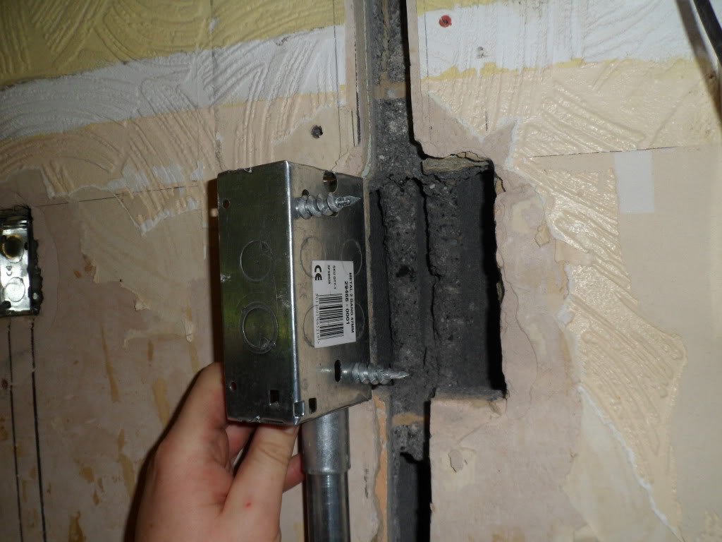

Onoff Posted February 12, 2018 Share Posted February 12, 2018 53 minutes ago, Nickfromwales said: Yea yea........ I will admit to using it on occasion as a quick fix... This was mid kitchen refit and this original switch position is long gone anyway. Weird breeze blocks in the walls that have huge "hollows" in them. For the 47mm back box here I just pumped in mortar and cheated with curly wurlys! Needs must... Link to comment Share on other sites More sharing options...
