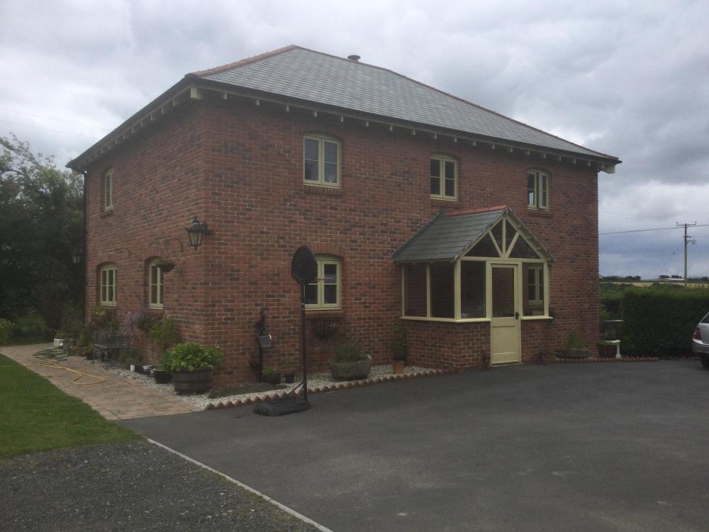

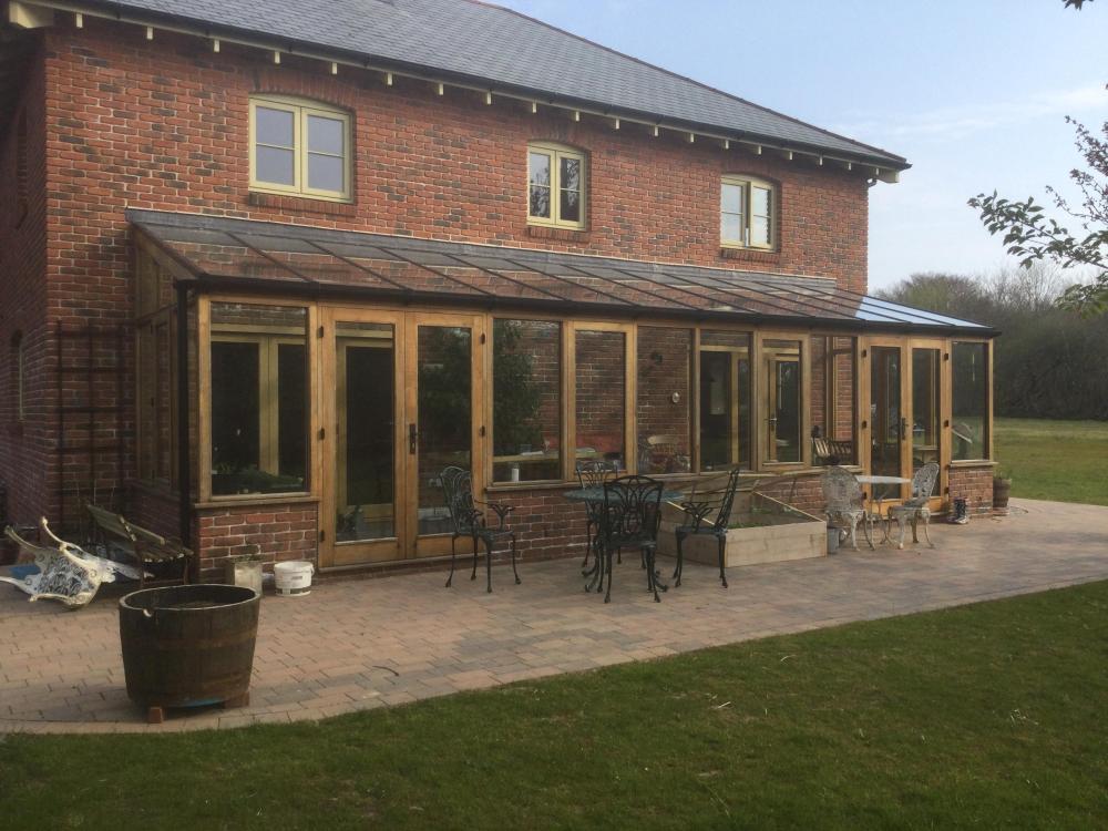

2 minutes ago, JohnMo said:
A simple cube is the most efficient from a building perspective you need way less insulation, you have less area to make airtight etc.
I agree, mine was 10m x 12m, longest side facing South with bifolds and conservatory, North side smaller windows, not quite passive but close, needed very little heat input and easy to build.

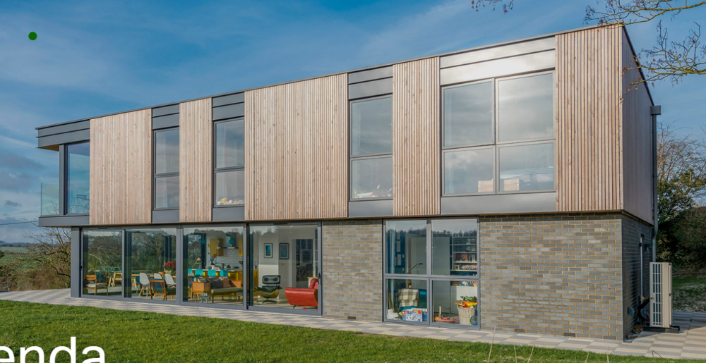

Nothing wrong with simple forms 😉 Extra points for simple forms and Passivhaus 🤣
There’s a balance to strike between building a square box with few windows and building a completely curved building full of glass. I don’t watch Grand Designs much but I was also impressed with the folk that built really interesting looking buildings that broke convention.
