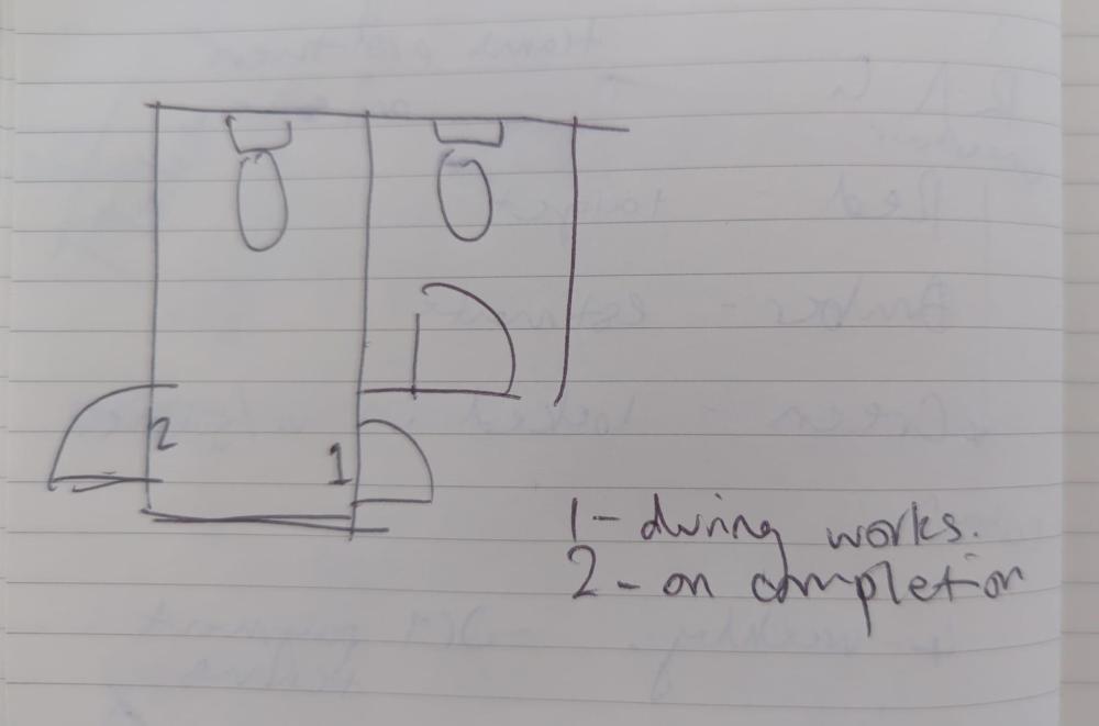

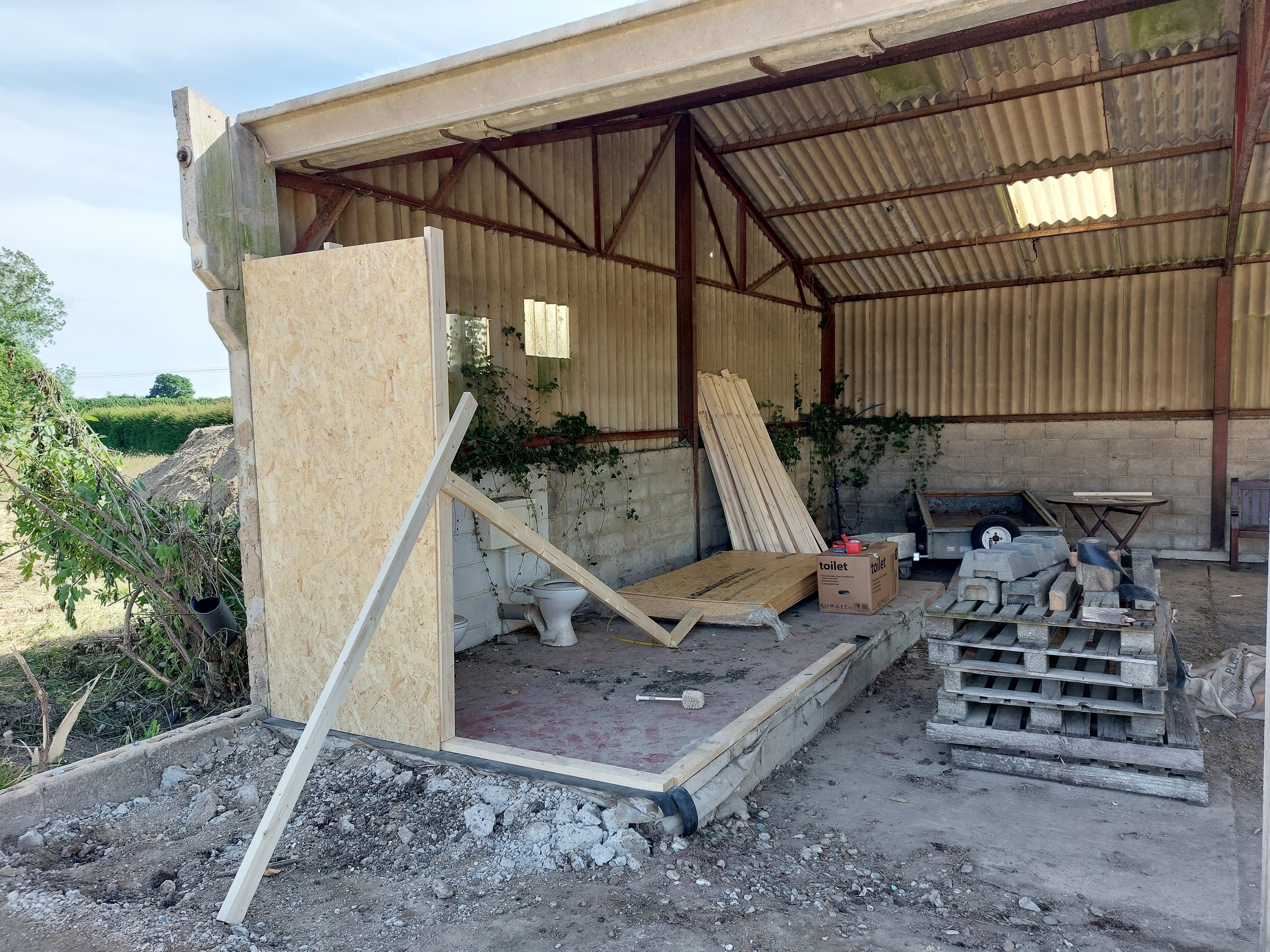

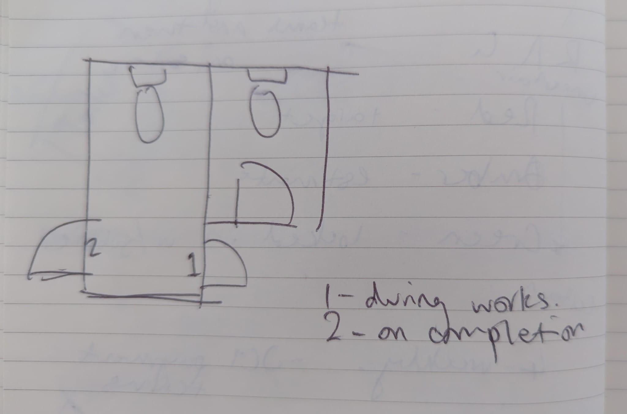

saveasteading Posted June 17, 2024 Posted June 17, 2024 (edited) There are 2 redundant toilets in a steel shed, from a previous use. They drain to a septic tank but are in need of replacement. the enclosure was previously removed for reasons of yuckiness. I'm making up 2 new wc's to be used during the construction process rather than hiring a chemical one. M and F. Then on completion, one will become a workshop/garage wc and the other have garden access. The roof is 3m plus away so these won't reach it, and won't have ceilings ( ventilation). I have successfully fixed the sole plate to the concrete floor. Then I started putting up studs but gravity is winning. I could make up panels on the floor but they would be too heavy. There must be a technique for a solo person doing this. I using 80 x 40 stud, and 11mm osb ( which is rather fragile and screws want to go right through. I have a nail gun, but little experience with one. So I have been putting up a stick at a time with a sturdy angled screw, then hoping to get in noggin before it falls over. The nail gun then helps to stiffen the joint. overnight I've put up a couple of braces. I am working to this detailed drawing. Edited June 17, 2024 by saveasteading Photo added
Alan Ambrose Posted June 17, 2024 Posted June 17, 2024 Maybe use some temporary struts at 45 degrees to the floor to hold uprights on a temporary basis. In two planes at right angles to each other if its a single stick pointing at the sun.
joe90 Posted June 17, 2024 Posted June 17, 2024 (edited) It’s usually easier to make a panel flat on the floor then lift it up into position, angled temp brace, fix to concrete, next panel…nail panels together… Edited June 17, 2024 by joe90 1

saveasteading Posted June 17, 2024 Author Posted June 17, 2024 1 hour ago, joe90 said: angled temp brace There are 2 of them in this film and one holds it up while the other does fixings. These concrete screws look useful. And the soft concrete helps too...no flints in that. And its not windy. Maybe I'm doing ok considering. The joiners / carpenters (acc to location,) are chuckling and saying nothing, i feel. 1

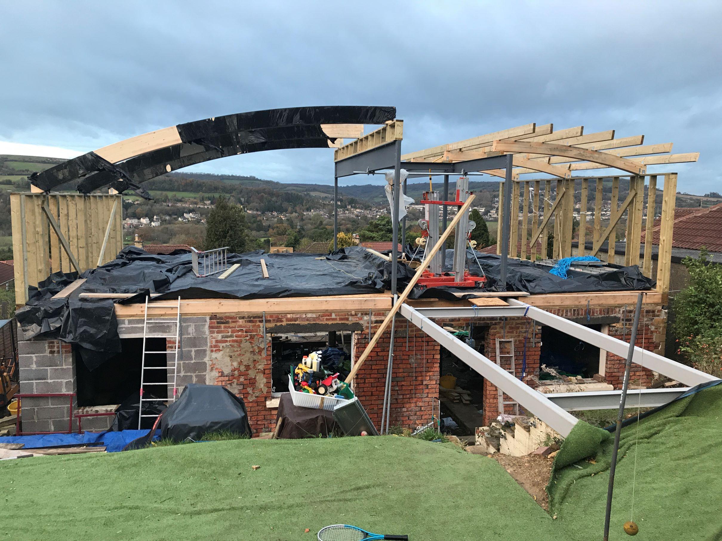

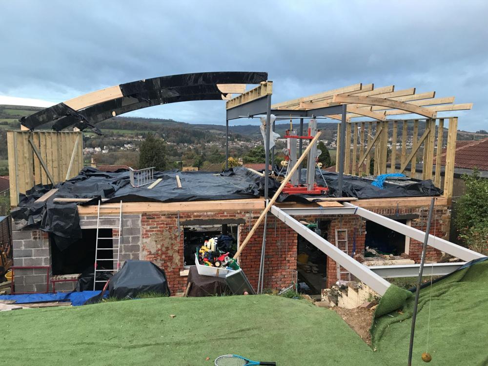

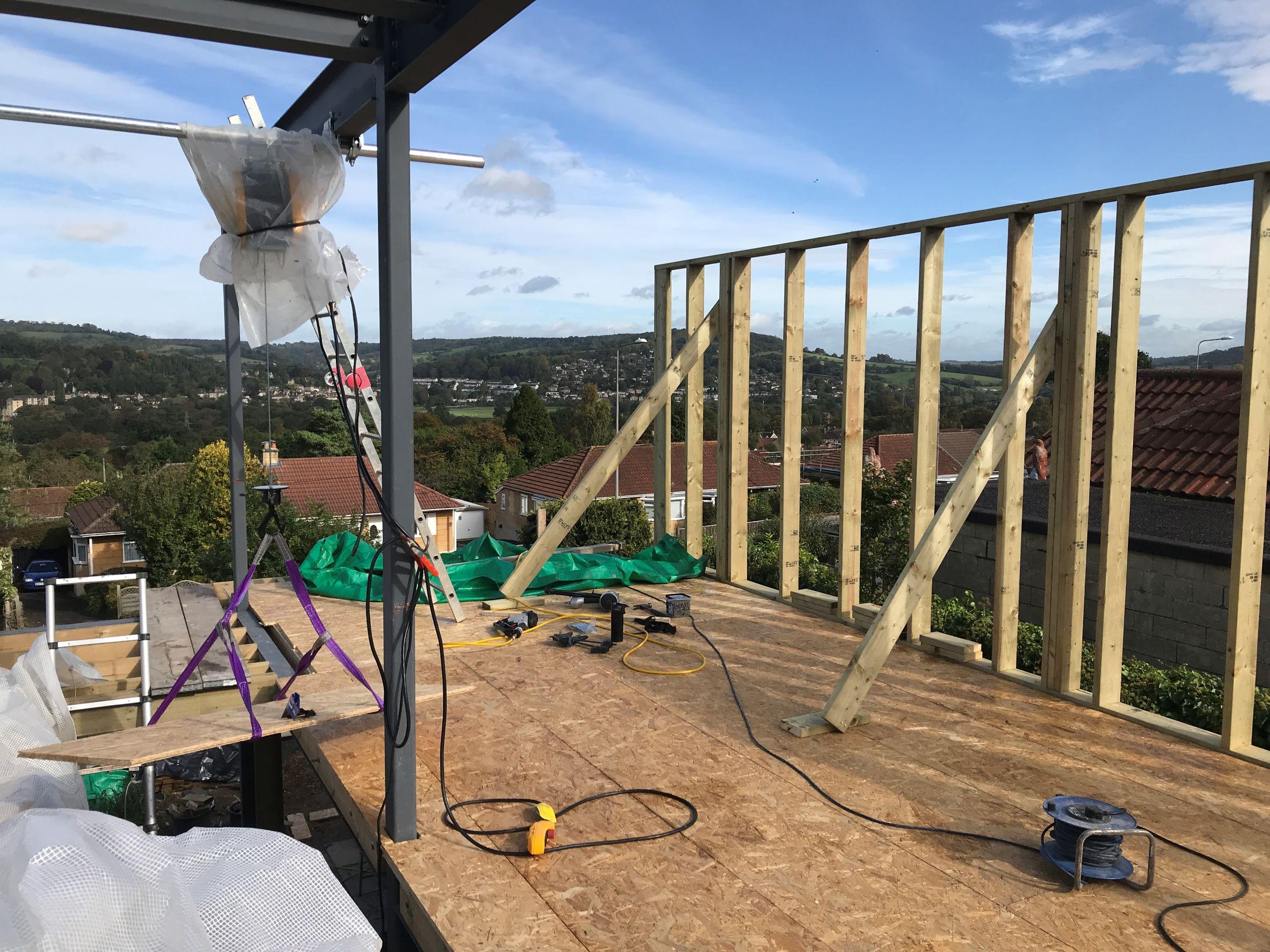

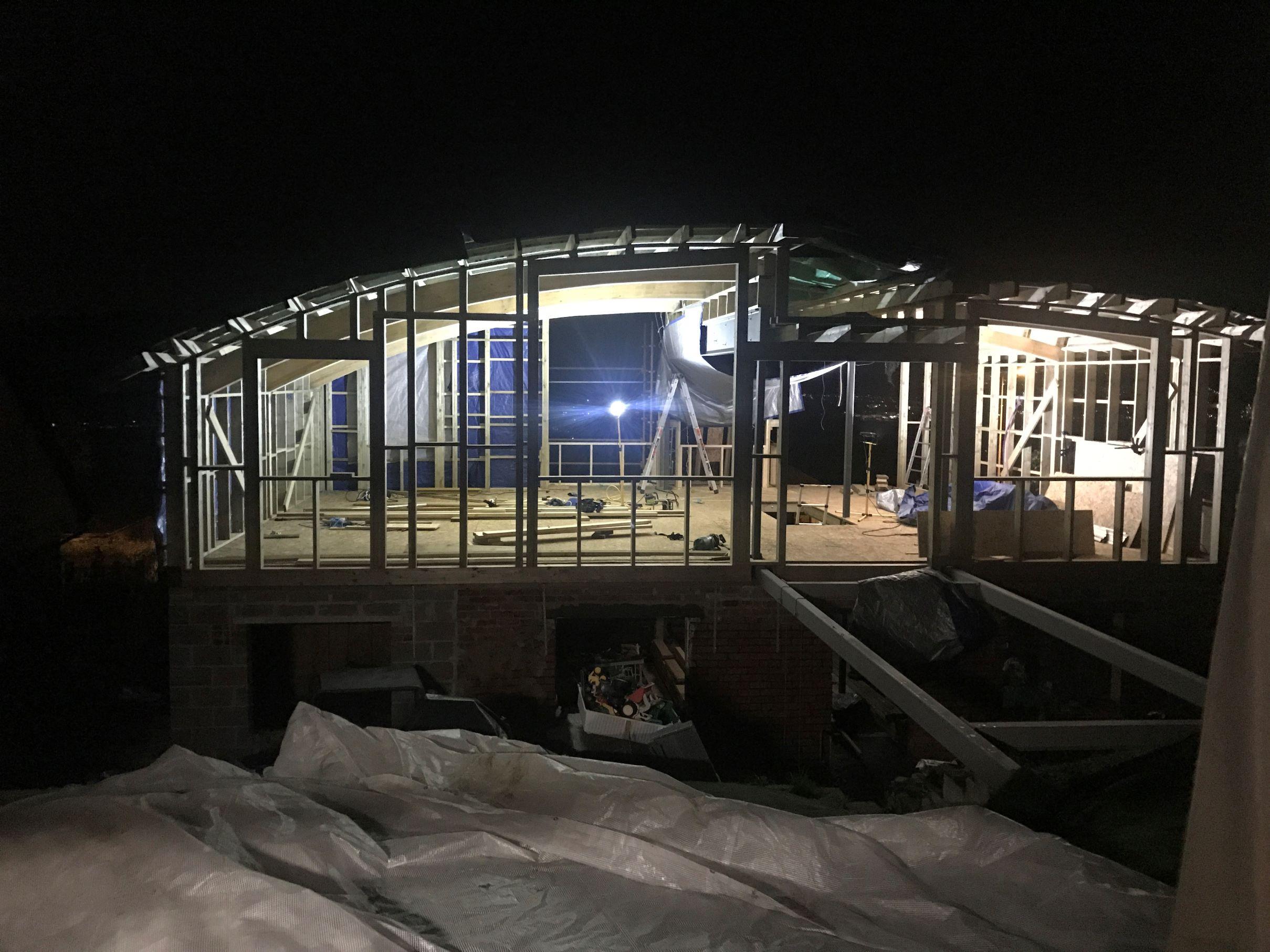

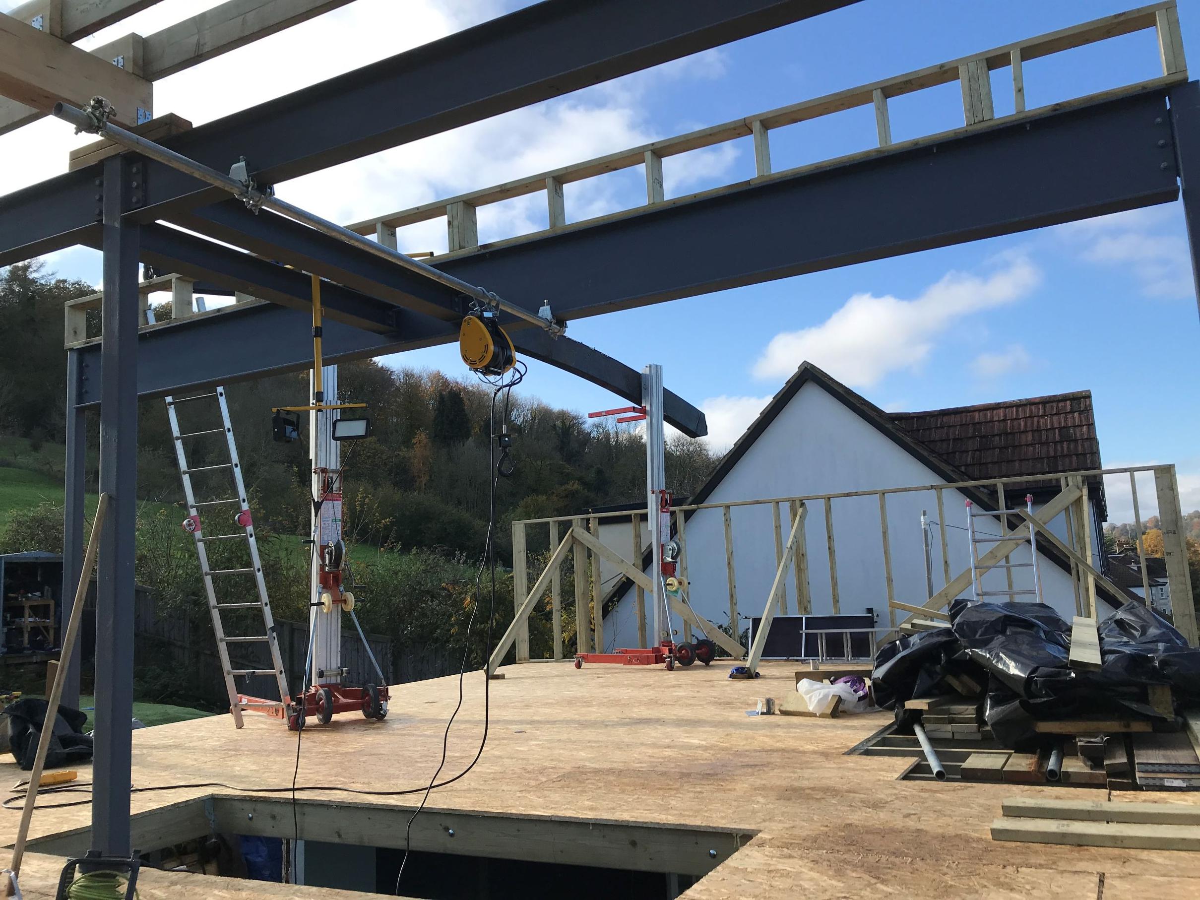

SimonD Posted June 18, 2024 Posted June 18, 2024 Make the stud wall on the floor without fixing the osb. Then lift in place. All you need to start are some braces to keep the wall upright. Then once upright can you brace for square, straight and plumb. My advice is build the whole stud wall structure without the osb, that way it's easy to attach temp bracing and only once all sections are in place can you take the brace off. Start like this: To this: To this: To this: Then osb. All one man job (with 16 year old nephew to help get the glulams from the driveway... 😉 Then use nails for the stud walls. 4
