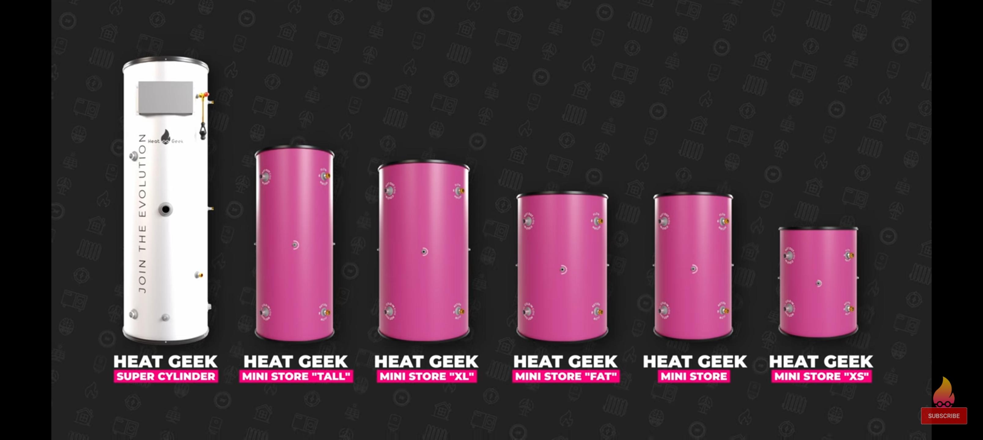

JohnMo Posted June 17, 2024 Posted June 17, 2024 On 17/06/2024 at 20:24, JamesPa said: just a bit disappointing that they have conflated small size with a new cylinder configuration, as it would help immensely to tease out the effects of these factors individually (particularly the latter). Expand They do several sizes

JamesPa Posted June 18, 2024 Posted June 18, 2024 (edited) On 17/06/2024 at 20:59, JohnMo said: They do several sizes Expand True, but so far we don't have any comparative performance figures relative to a uvc of the same size. What I really want to know is, if I need (eg) a 150l uvc to deliver x amount of dhw at y l/s, how big would this arrangement need to be? If the answer is 150l or less, then the only remaining argument for a uvc might be heat pump efficiency (which may or may not differ between the two). If the answer is within 10-20 % of 150l then I would say that in most cases, unless space was extremely tight, you would choose this over a uvc to avoid g3. If it's more than 20% larger to get the same yield, then the hg mini is only for situations where the g3 arrangements are much more difficult than accommodating a larger cylinder, and the solution for smallest volume (which seems to be what they are targeting) is actually a small uvc not the hg mini! Hopefully this detail will come. Edited June 18, 2024 by JamesPa

sharpener Posted June 18, 2024 Posted June 18, 2024 On 18/06/2024 at 07:37, JamesPa said: What I really want to know is, if I need (eg) a 150l uvc to deliver x amount of dhw at y l/s, how big would this arrangement need to be? Expand A further thought about the flow regime in the tank (assuming normal vertical mounting). The concept relies on the coil surface area being big enough to transfer the heat to the flowing DHW at a fast enough rate (50kW is mentioned at one point). This will rapidly cool the body of water in the tank in the immediate vicinity of the coil. So if this cooler water stays put it will soon reduce the effectiveness of the heat transfer, if it mixes it will reduce the effectiveness in a different way, if it falls to the bottom of the tank it will displace the warmer water towards the top which is the desirable outcome. But after the 3 mins has elapsed the HP will start up so we do not need to worry about natural convection any more. With a flow rate of ~3 l/min per kW of output it will push re-heated water into the top of the tank and move it downwards. This will improve the heat transfer and is OK if the HP can reheat the water fast enough. But if the heat being abstracted is greater, then the return temp to the HP will steadily fall so the flow temp will fall too. Then the water surrounding the top of the coil will not be hot enough to give the desired output temp. So I am not sure how this concept will perform against the normal DHW cyl where stratification is quite good and the water for your shower stays very hot until quite suddenly it isn't. The video picks a scenario where the HP meets the entire heat requirement which does not place any real demand on the store at all. In real life I forsee a steady decline in flow temp from quite early on - so in practice you will need to heat the water to well above the shower temp you want and the efficiency gains will then not be achieved.
JamesPa Posted June 18, 2024 Posted June 18, 2024 (edited) On 18/06/2024 at 09:24, sharpener said: The video picks a scenario where the HP meets the entire heat requirement which does not place any real demand on the store at all. In real life I forsee a steady decline in flow temp from quite early on - so in practice you will need to heat the water to well above the shower temp you want and the efficiency gains will then not be achieved. Expand The hp in the video doesn't meet the demand to heat water from mains temp to dhw temp, we know that because the dhw eventually falls below temperature. However I think it does (and probably generally will) meet the demand required to restore the return from the tank to the tank temperature, just not at the (flow) rate sufficient to restore all the heat lost from the tank to the dhw. So what I think happens in a perfectly stratified tank is that the thermocline moves upwards at a rate slower than would be the case without reheat, eventually to the point where the thermocline is high enough in the tank that the dhw coil can't extract enough energy to heat the incoming mains to the desired temperature. I don't think they are particularly claiming efficiency gains and are I think heating the store to 50/55 (I can't remember which) which is not an uncommon flow temp for dhw, bearing in mind that there is typically a 5C offset between the flow temp to a uvc and the actual water temperature unlike the mini where the offset is zero. Obviously some run it cooler to maximise efficiency at the expense of capacity, this is a design trade off with any cylinder!. It all comes back imho to, how does the yield of dhw compare to a uvc of the same volume and at the same heat pump ft. Answering that question alone tells us the circumstances in which this is useful and any efficiency matters. Unfortunately it's not answered! Edited June 18, 2024 by JamesPa
sharpener Posted June 18, 2024 Posted June 18, 2024 On 18/06/2024 at 09:57, JamesPa said: So what I think happens in a perfectly stratified tank is that the thermocline moves upwards at a rate slower than would be the case without reheat Expand Yes, ideally. My concern would be that with say a 5kW hp that gives a flow through the tank of 15l/min, and this may actually be faster than you want, as in 10 mins you are turning over the entire contents of a small tank. Moving the thermocline downwards by adding less hot water at the top is not going to help the dhw ft. Time for one of your spreadsheet models @JamesPa? (They don't seem either to claim any of the features you sometimes see aimed at preserving stratification, such as baffle plates or curved or tangential-flow inlet pipes.) On 18/06/2024 at 09:57, JamesPa said: It all comes back imho to, how does the yield of dhw compare to a uvc of the same volume and at the same ft. Expand At best it would be the same but for the reasons we have been discussing I think it will be more difficult to achieve than in a well-stratified conventional cylinder.
JamesPa Posted June 18, 2024 Posted June 18, 2024 (edited) On 18/06/2024 at 10:23, sharpener said: Yes, ideally. My concern would be that with say a 5kW hp that gives a flow through the tank of 15l/min, and this may actually be faster than you want, as in 10 mins you are turning over the entire contents of a small tank. Moving the thermocline downwards by adding less hot water at the top is not going to help the dhw ft. Expand Somewhere in the video the hp was operating at way less than max output. However only some hps are set up to modulate the water pump and, as you say, the turnover may be too large. Need to think about how the control loops work to understand this. On 18/06/2024 at 10:23, sharpener said: (They don't seem either to claim any of the features you sometimes see aimed at preserving stratification, such as baffle plates or curved or tangential-flow inlet pipes.) Expand I'm pretty certain one of the diagrams showed a diffuser at the flow inlet. On 18/06/2024 at 10:23, sharpener said: At best it would be the same but for the reasons we have been discussing I think it will be more difficult to achieve than in a well-stratified conventional cylinder. Expand Agree unless there is some efficiency advantage because the flow from the hp directly feeds the tank. All of the above is, in my view, an engineering unknown. And all of the above can be answered if we get the answer to the question about the comparison with a uvc of same size and operated at same ft (except some of the pump control questions which may be ho dependent). I wonder if they have thought about all if this or are just throwing it at the market following some basic experiments, to see what happens? Edited June 18, 2024 by JamesPa

JamesPa Posted August 5, 2024 Posted August 5, 2024 Full spec and pricelist now published https://newarkcylinders.co.uk/heatgeekministore/ 1
JohnMo Posted August 5, 2024 Posted August 5, 2024 The tables make interest reading. If you have a coldish 10 Deg fill water from the mains, and a decent shower flow, they just don't work well, even at elevated storage temps that a R32 ASHP really wouldn't manage. So unless you really had to I wouldn't bother.
JamesPa Posted August 5, 2024 Posted August 5, 2024 On 05/08/2024 at 10:18, JohnMo said: So unless you really had to I wouldn't bother. Expand In fairness that's pretty much what the Newark literature says. Unless someone beats me to it I intend to do some like for like comparisons to to see what efficiency penalty you pay (because you need to heat to a higher temperature) to get the same amount of water at 40C from a given size tank. If it works out less than about £100-£150 per year it would still be cheaper to pay the efficiency penalty than to pay for the annual uvc inspection. Just from eyeballing the numbers quickly I don't think it will work out this way for a high design dhw flow rate, but might for a low design dhw flow rate. However this needs a spreadsheet!
JamesPa Posted August 5, 2024 Posted August 5, 2024 By way of comparison, below is a table of yield in litres of the mini store (with reheat at the rate shown), according to the Newark data, and a conventional cylinder of the same size (no real time reheat). I am assuming 10l/min draw off, the figures for the mini store improve at lower draw off rate and get worse at higher draw off rate. For the conventional cylinder I am assuming that the flow temperature is 5C higher than the cylinder temperature and that there is 10l of dead space at the top which cant be drained at the charge temperature. Bear in mind that the product is aimed principally at smaller properties which would previously have a combi, so the maximum yield is relatively modest compared to that for a more demanding property/family. If I take the example of an 8kW heat pump then the mini store yield is poorer, but this can be compensated in quite a few cases by raising the flow temperature by about 10C. That will incur a performance penalty of perhaps 30%, but the cost of the extra electricity would be significantly less than the cost of an annual inspection for a UVC. My own case (if my LPA ever gives me permission) would be an 8kW pump. My current cylinder is 140l and I run the current boiler at FT55 or FT50. I get enough DHW. Obviously efficiency (with a heat pump) would be better if I fitted a bigger cylinder than I have at present so I can run at a lower temperature, but there is only so much space in the airing cupboard, which is used for airing. With a 130l mini store and an 8kW heat pump I could get the same amount of DHW as I currently get by running at an FT of 65. The mini store clearly doesn't give the most efficient heat pump performance, but the running cost taking into account the annual inspection may be less or similar. The main attraction is circumventing G3. I could install it myself, wouldn't gave to get a plumber to certify and wouldn't have to get an annual inspection. Of course I could alternatively get the G3 qualification myself, but not requiring G3 also means that I wouldn't have to feed a 28mm pipe that will probably never get used in earnest through an awkward route in the house. I must say Im tempted, perhaps more so once they launch one with an immersion boss (which they say is coming in V2). In circumstances of relatively modest demand I don't think the trade-off is crystal clear. Obviously if you want to run showers at 20l/min or several showers in quick succession, then a large UVC is the only practical choice. But in this case you quite possibly aren't replacing a combi, which is one of the use cases at which the product is aimed. My feeling based on this analysis is that it has a place amongst the range of DHW solutions that is needed. It will be interesting to see how the market reacts. Draw off (l/min) 10 Inlet water temp 10 10l/min/10C Mini Cylinder + Conventional Store Temperature 4 kW 6 kW 8 KW 10 kW 12 kW 14 kW Cylinder Mini Store XS - 60 L Yield @40C (l) 45°C - - - - - - 50 50°C - - - - - - 58 55°C - - - - - - 67 60°C - - - - - 50 75 65°C 50 50 55 60 70 80 83 70°C 60 65 70 80 90 110 92 Mini Store - 80L Yield @40C (l) 45°C - - - - - - 70 50°C - - - - - - 82 55°C - - 50 55 60 65 93 60°C 60 65 70 80 90 105 105 65°C 75 85 90 105 120 150 117 70°C 95 100 115 130 150 190 128 Mini Store Fat / Tall - 110L Yield @40C (l) 45°C - - - - - - 100 50°C - - - - 50 55 117 55°C 60 65 70 80 90 110 133 60°C 85 90 100 115 135 165 150 65°C 105 120 130 150 180 220 167 70°C 130 145 160 185 220 275 183 Mini Store XL 130L Yield @40C (l) 45°C - - - - - - 120 50°C 50 55 60 65 75 85 140 55°C 80 85 95 105 125 150 160 60°C 105 115 130 150 175 215 180 65°C 130 145 165 190 225 285 200 70°C 160 175 200 230 275 350 220 2
