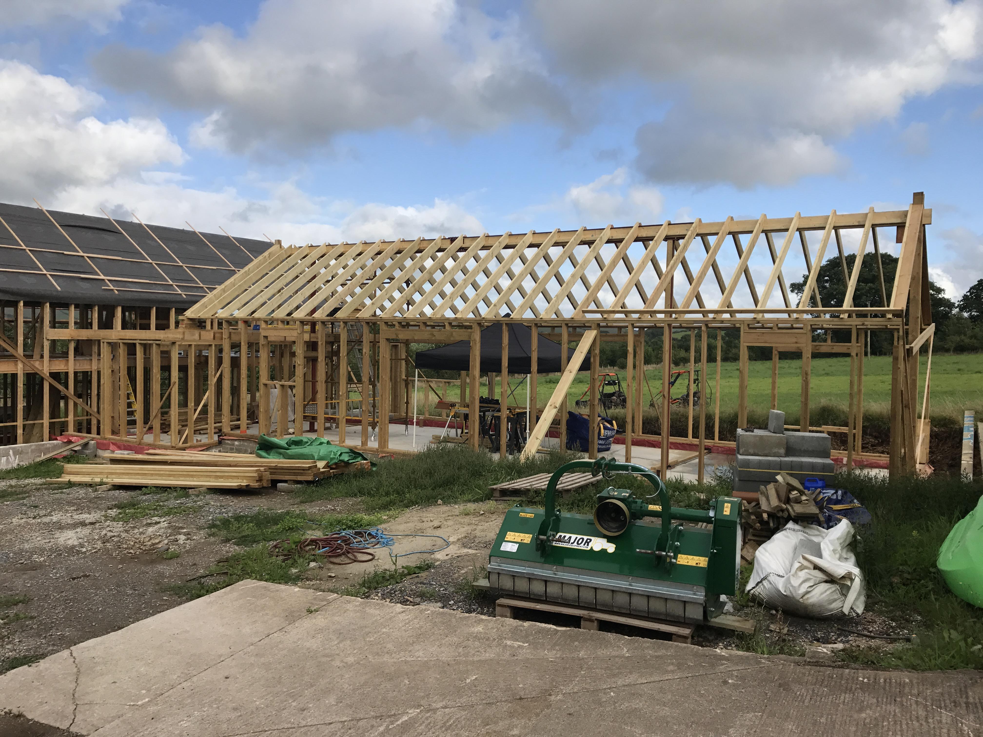

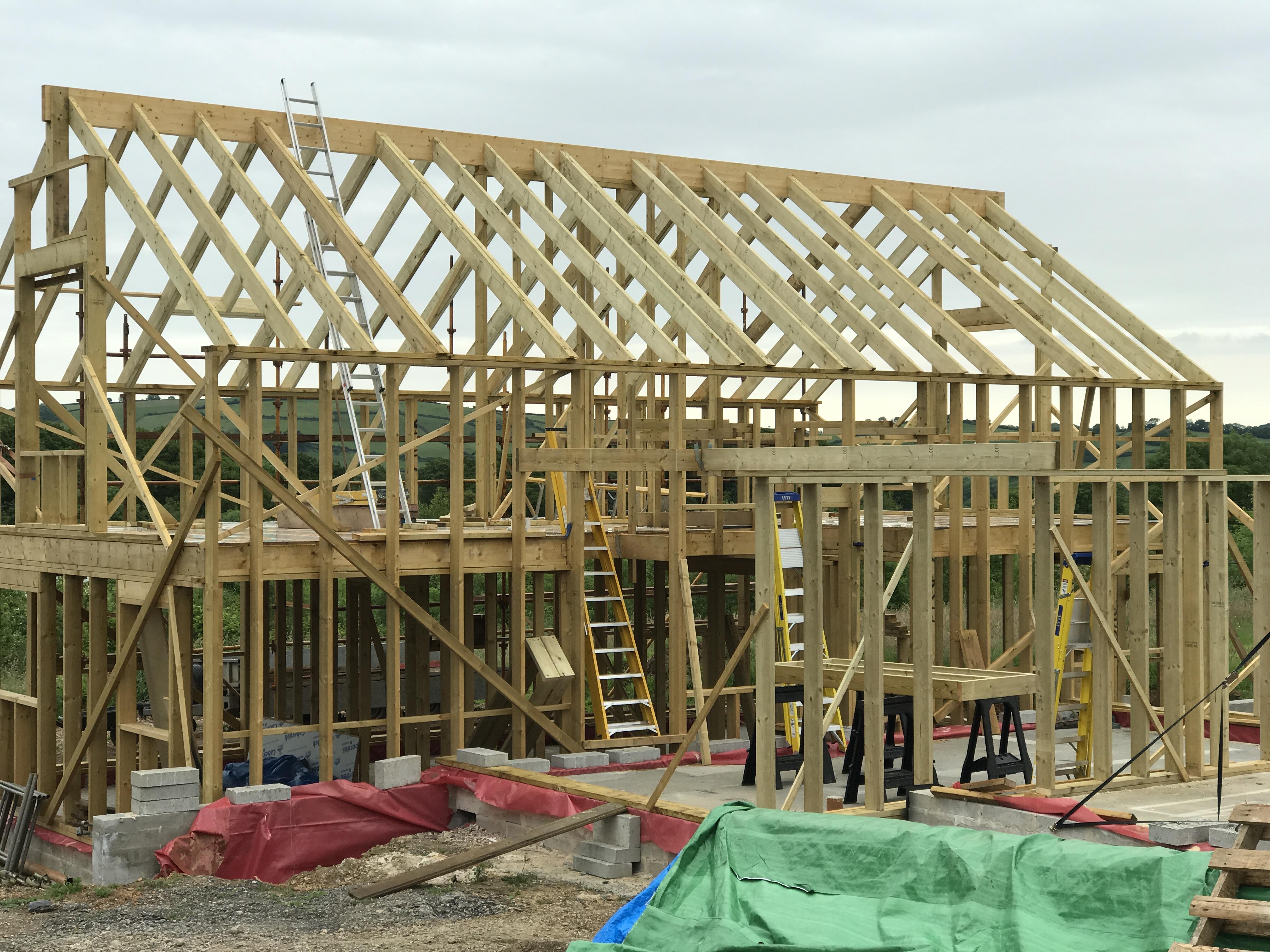

JamesP Posted June 13, 2024 Posted June 13, 2024 As you might be on a stick build journey, I have included my wall / roof build drawing (Hand drawn) and a few photos. About 275sqm, took a while to get weather tight but very much the most satisfying part of my self build and it is square! Wall : Roof details-1..pdf 1
G and J Posted June 13, 2024 Author Posted June 13, 2024 8 minutes ago, JamesP said: As you might be on a stick build journey, I have included my wall / roof build drawing (Hand drawn) and a few photos. About 275sqm, took a while to get weather tight but very much the most satisfying part of my self build and it is square! Wall : Roof details-1..pdf 777.43 kB · 3 downloads Goodness, thank you for sharing that. So your OSB skin is on the inside and is your main airtight layer in your wall. Not sure we can go that route due to fire resistance - I’m still not sure how I do address airtightness. Your framing timbers are I’m guessing circa 5.1m and your floor is hung from the side of them. Was there a specific advantage in doing that over what I think is called a platform floor? (I mean where you build downstairs, the floor sits on that and then you build upstairs directly on top of it.)
JamesP Posted June 13, 2024 Posted June 13, 2024 Yes, the first floor built on top of ground floor. Two timber stud spine walls on the ground floor to support the joists, GF was 13m x 7m. The first floor timber joists were 44mm x 220mm x 4400mm + some glulams. Vapour barrier behind the OSB, Pavatherm on the outside then batten, counter batten and cedar cladding.
