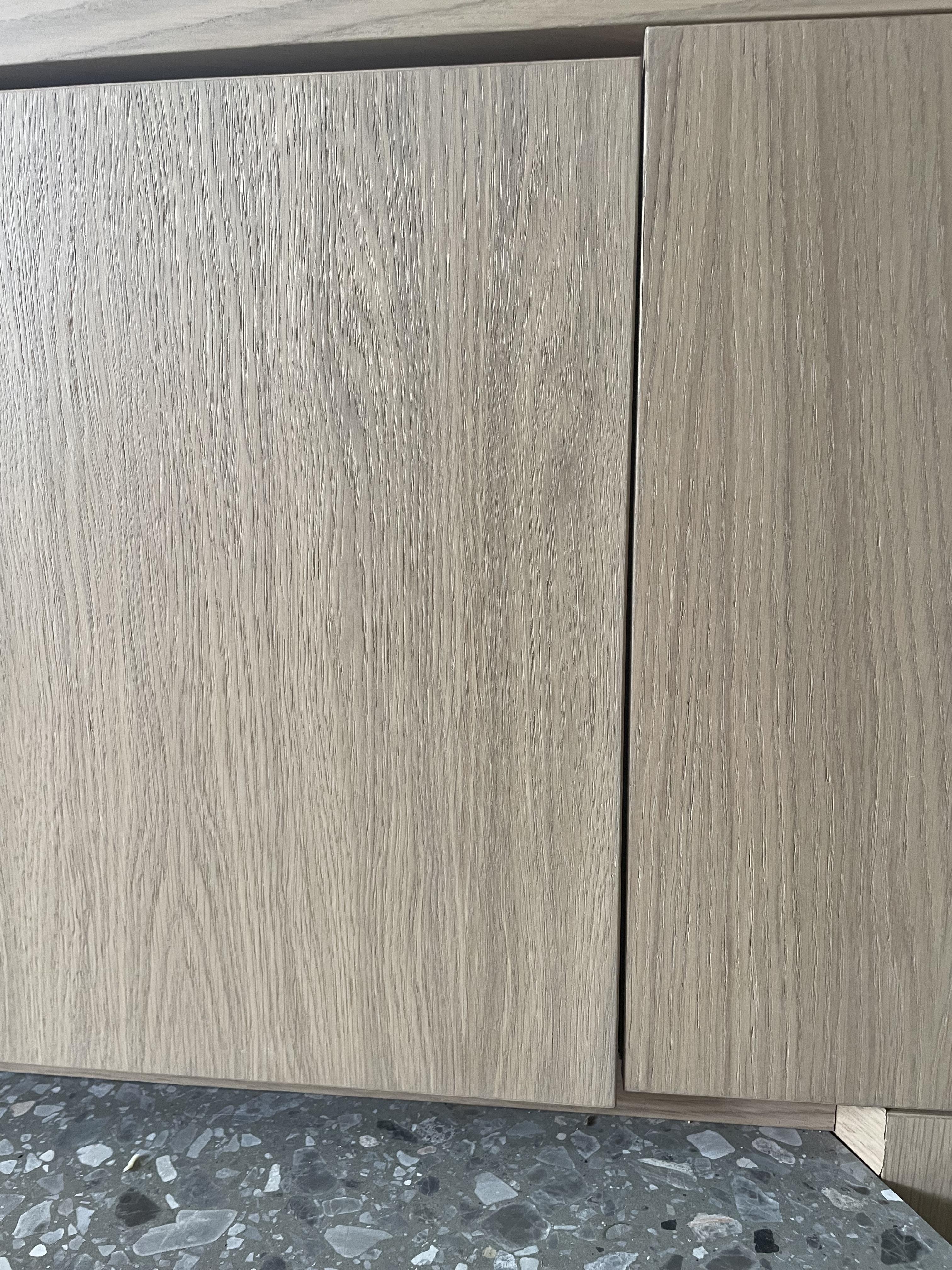

Adsibob Posted May 29, 2024 Share Posted May 29, 2024 We have an MdF cabinet door that is 79cm wide and 39cm high, 26mm thick. It sags, presumably because the width of the door creates too much weight/moment for the hinges to support the door straight. i raised it with the joinery that made and installed this for us and they added an additional hinge, so that there are now three hinges. That has not made much difference, after a few days’ use it sags again and starts to hit the frame. I have adjusted the Blum hinges, but this also doesn’t seem to make much difference; it’s almost as if the hinges don’t have enough adjustment to them, but I suspect they weren’t designed for such a wide door. Photo below. Thoughts as to a possible fix which doesn’t involve cutting the door into two? Link to comment Share on other sites More sharing options...

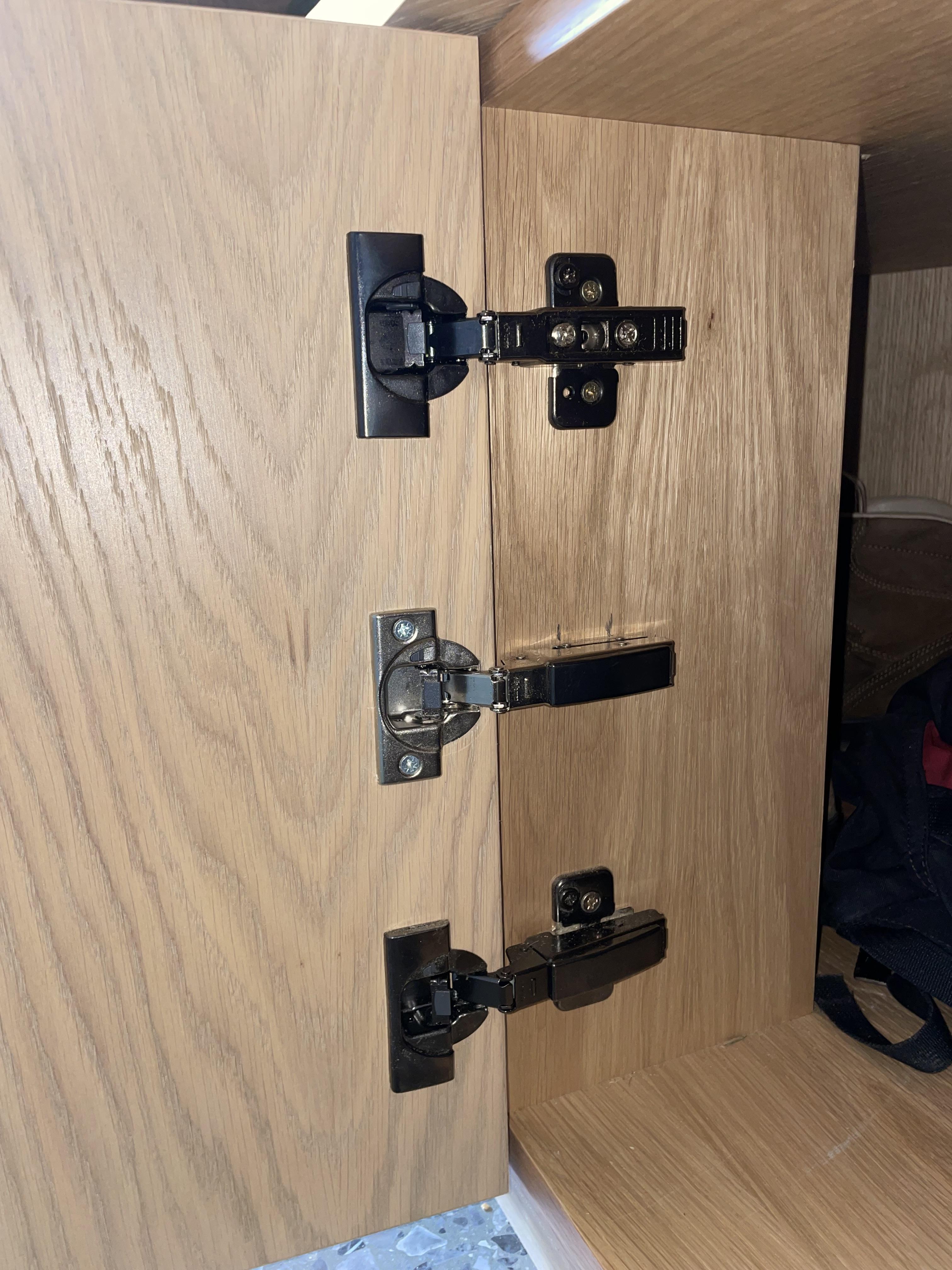

Adsibob Posted May 29, 2024 Author Share Posted May 29, 2024 These are the Blum hinges. All made by Blum, but middle one is slightly different to the other two - this middle one was the additional one they installed on the snagging visit a month or so ago. I have asked them to return to fix this issue, as well as a couple of others, but there’s not been a response, despite me chasing. It’s a shame the aftercare service is so poor. Link to comment Share on other sites More sharing options...

Adsibob Posted May 29, 2024 Author Share Posted May 29, 2024 31 minutes ago, Temp said: Blum hinges are probably the most widely used hinges on the market. Have used them myself. What I would do is remove the middle one temporarily. Set up the other two and refit the middle one. well the middle one was retrofitted, in that originally it was just the top and bottom one and I complained about the door sagging and so they fitted an additional hinge. It's very odd, this website suggests that three hinges should be plenty as by my calculation the door weighs no more than 6.5kg and three hinges will do up to 12 kg: https://ea.blum.com/en/number-of-hinges/ Though that spec sheet does say that this is for doors up to 600mm in width and that doors should be higher than they are wide, and mine is almost 800mm wide and certainly much wider than it is is high. It's very frustrating, because our design was for 18mm thick doors, and it was only because the joinery insisted thicker would be sturdier that we went with a thicker door. I don't think there is space to fit a fourth hinge without flipping the door and redrilling 4 fresh hinge holes. But if I did this, would is certainly fix the issue? Link to comment Share on other sites More sharing options...
Temp Posted May 29, 2024 Share Posted May 29, 2024 The vertical separation between the hinges matters so a short wide door is the worse combo. Think I'd look to see if they make a version for heavy doors and/or move the hinges as far apart vertically as possible. I guess replacing with two doors would look odd. Link to comment Share on other sites More sharing options...
ProDave Posted May 29, 2024 Share Posted May 29, 2024 16 minutes ago, Temp said: The vertical separation between the hinges matters so a short wide door is the worse combo. The original joiner should have realised that, and fitted the original 2 hinges literally as far apart as possible. When adding a third hinge, putting it in the middle has added nothing That is the point it will pivot about if the first 2 hinges are straining.. You might, just might fit another hinge above the top hinge, if so that would have been a good place to add it, and if one would fit a 4th hinge squeezed in below the existing bottom hinge. There is a good reason why you see heavy doors hung with 3 hinges, but 2 near the top, not in the middle. He might be a good joiner, but he is a poor engineer. 3 Link to comment Share on other sites More sharing options...

Temp Posted May 29, 2024 Share Posted May 29, 2024 I don't know if these are actually any stronger or if it's just marketing speak but they say upto 40kg. https://www.eurofitdirect.co.uk/collections/heavy-duty-concealed-hinges Link to comment Share on other sites More sharing options...
JohnnyB Posted June 9, 2024 Share Posted June 9, 2024 It's probably too late to reply to this and help the OP but the hinges Temp has linked to are a heavier duty hinge. The last company I worked for used them a lot on heavy doors. They are a different hole pattern to Blum hinges so won't fix directly into these doors without making changes to the holes. If the OP is still having an issue I would look at Grass hinges as I believe they do a slightly heavier duty hinge than Blum. They also have different back plate thicknesses and fitting a thinner backplate should help the door look better when shut. It's say that any joinery company that leaves a door that out of square doesn't deserve to get their final payment. 1 Link to comment Share on other sites More sharing options...
