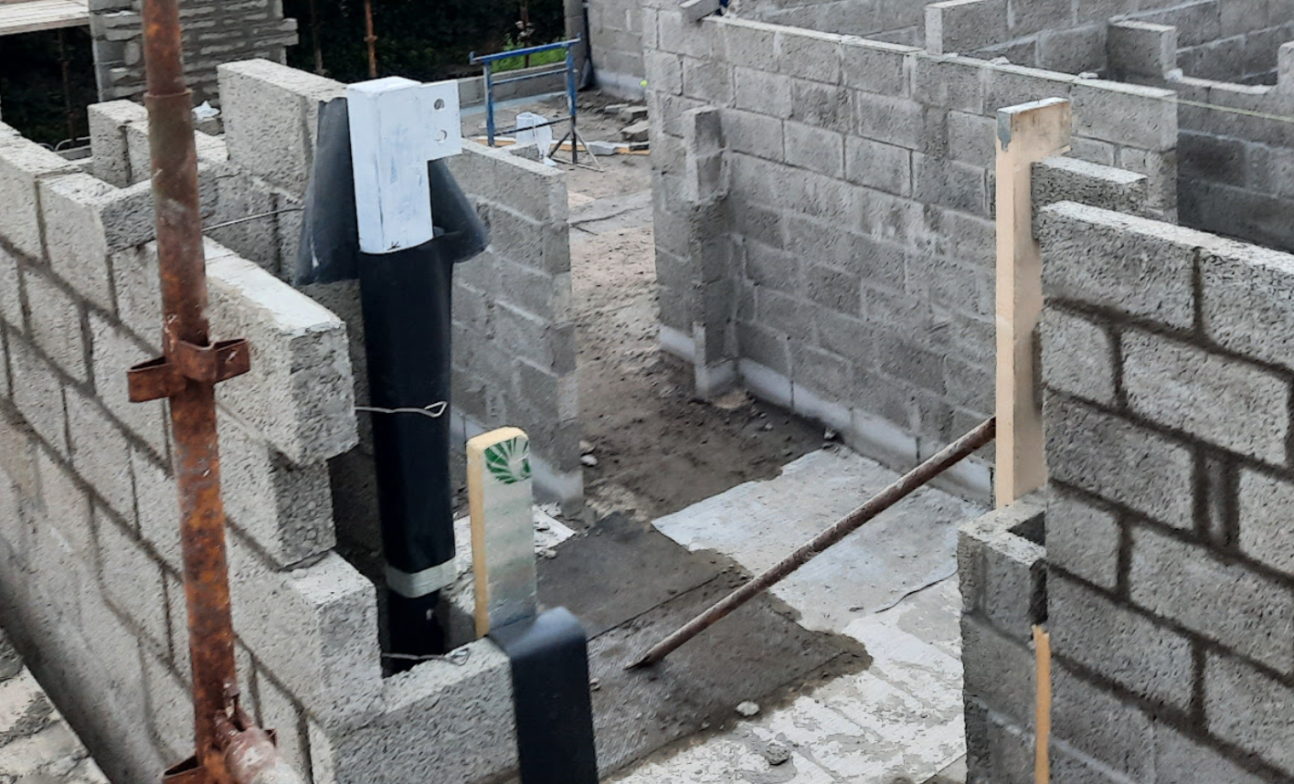

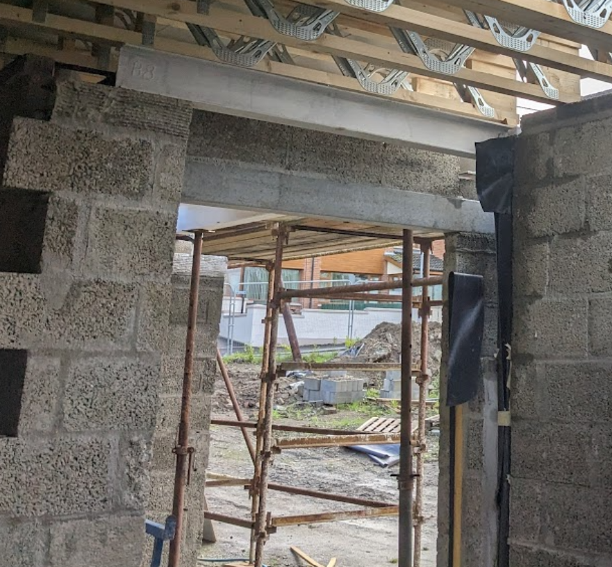

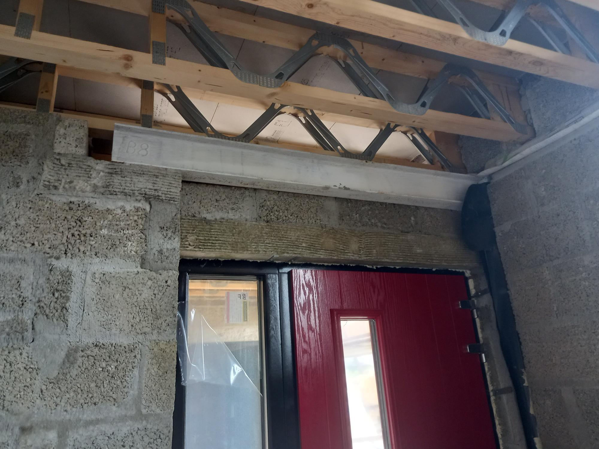

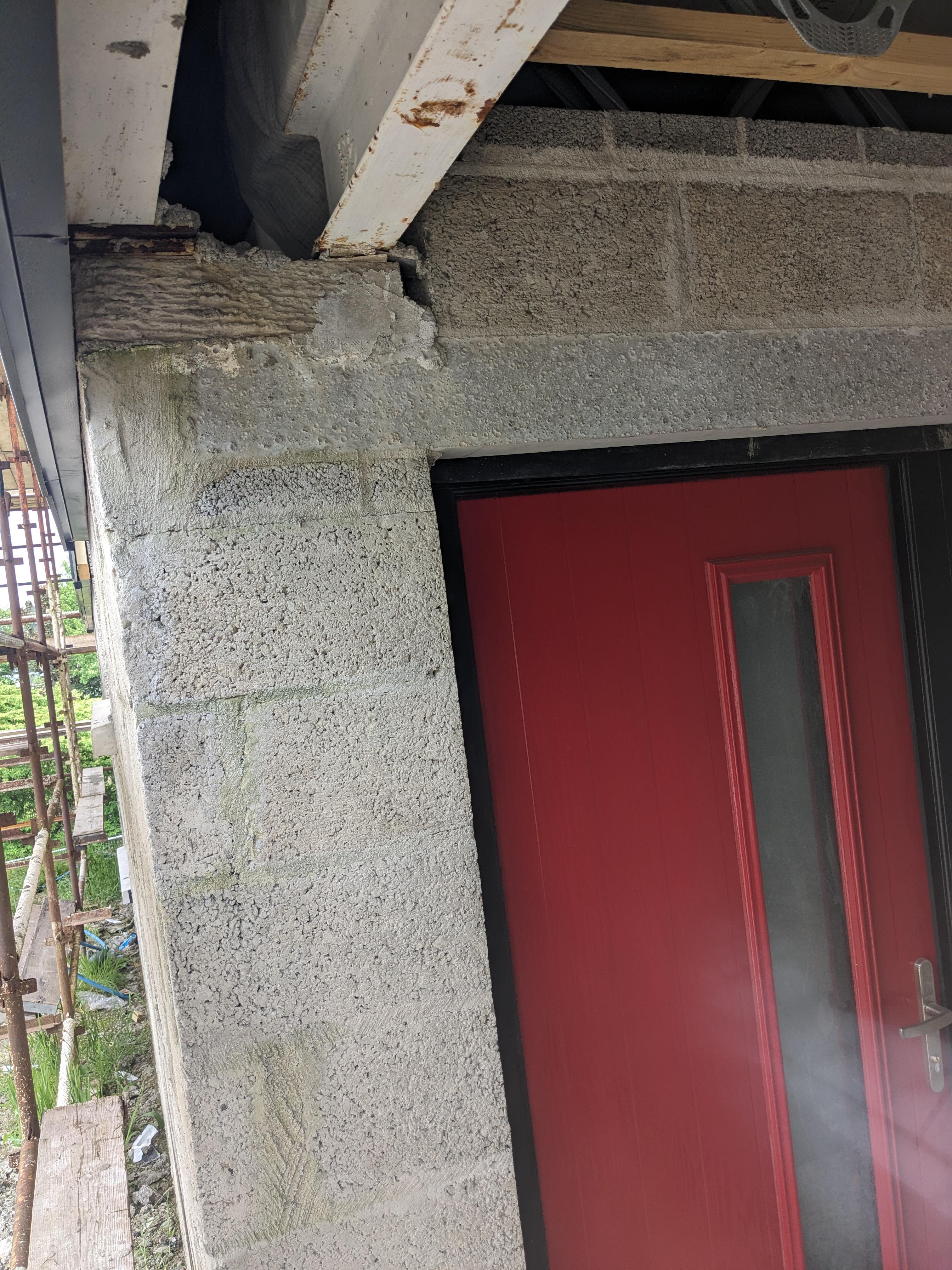

CalvinHobbes Posted May 25, 2024 Posted May 25, 2024 (edited) Hello, sheesh thought I would come on and ask advice yet again. Building control was out and said we appear to have a massive cold bridge at door. So the metal beam goes over the door and connects to another that meets a post going up (was that a wind post) so forming a sideways L shape shape. The cavity is behind it. Bit scunnered tbh. There was a change of builders and the second ones are having to fix things . Bah. Feel free to tell me something good. Edited May 25, 2024 by CalvinHobbes
Kelvin Posted May 26, 2024 Posted May 26, 2024 (edited) You can insulate them using expanding foam or PIR. Bit harder to do on the opposite side. How big is the gap on that side? On the second picture, what’s the beam that runs perpendicular to the door sitting on? Edited May 26, 2024 by Kelvin

saveasteading Posted May 26, 2024 Posted May 26, 2024 I'm not really sure what the detail is. Is this beam outside, forming a porch sort of space? I'd avoid expanding foam except for any small inaccessible spaces. Instead, fill the I section with rockwool. The rigid type used in cavity walls which is also waterproof. Or pir. Cut to shape and pressed into the spaces in the beam. Fix some more to the underside. Then box around the beam in cement board. Obv the hole in the wall need to be filled and insulated too. 27 minutes ago, nod said: don’t worry about airtightness Do deal with it. It matters even if some people don't understand it 1

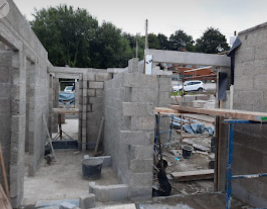

Iceverge Posted May 26, 2024 Posted May 26, 2024 Ok the beam is annoying but not a huge issue. I think you are aiming for Eps Blown beads anyway. Box out the beam EXTERNALLY leaving at least 50mm at all sides of it to at least 1m long outside the door, longer is better. Blow it full of EPS beads. Something else of concern is the door placement. It looks to be entirely within the external leaf, am I seeing this correctly? It really should be sitting in the cavity for best thermal performance. 1
Kelvin Posted May 26, 2024 Posted May 26, 2024 I did what @saveasteading describes. Filled the I with PIR in my case. I used expanding foam to reach the bits I couldn’t get into. Then faced with thin insulated cement board then the airtight membrane taped and sealed. I had a similar problem to you in that mine was fitted then closed. Fortunately I was able to open it back up again easily enough giving me access to most of it. 1
jack Posted May 26, 2024 Posted May 26, 2024 Discovered/realised far too late the same thing with balcony steels for my "cold bridge free" MBC build. When I raised it, MBC foamed in PIR insulation then wrapped it in aerogel blanket. I'd probably have gone even further than that if I'd had time to consider it. Someone said to expect mould on the plasterboard where the steel comes into the house, but we've never had a moment's problem in over 8 years. 1

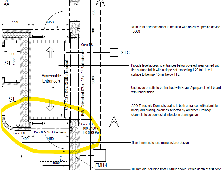

CalvinHobbes Posted May 27, 2024 Author Posted May 27, 2024 The Building control officer also pointed out we were not using approved plans which was 'not great'. Like yikes!The ones we have from the architect were blessed by a structural engineer so I hoped would suffice and as the bc said, they are allowed (didn't sound ecstatic). Anyway I found some older pics and here is the part of the plan too. TBF I do appreciate the bc flagging up things, the builder assured me he had a plan to deal with it anyway and was sorry he missed the BC officer.
Iceverge Posted May 27, 2024 Posted May 27, 2024 That beam is relatively simple to deal with. Any more info on the placement of the door?
CalvinHobbes Posted May 27, 2024 Author Posted May 27, 2024 (edited) Iceverge what are you thinking, should the door move? How hard would that be to do? I know the frame is hardwood. So bring it in a bit? I am looking at that plan and am unsure. Edited May 27, 2024 by CalvinHobbes
dpmiller Posted May 28, 2024 Posted May 28, 2024 looks like the door is sitting across a cavity closer to me? 1
Iceverge Posted May 28, 2024 Posted May 28, 2024 Is this lintil and the blocks above it on the outer or inner leaf of the cavity?
CalvinHobbes Posted May 28, 2024 Author Posted May 28, 2024 That's an internal photo and the other side of that lintel is external onto the porch. The builder is saying he will effectively make another wall outside. 1
