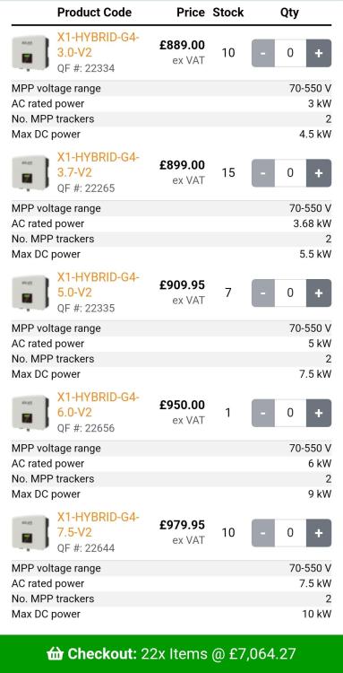

May 21, 20242 yr Would 18 panels at about 40v max put the inverter over the maximin input voltage, or if connected series/parallel, put it over its max input current? I understand you can over power them in wattage but thought the max volts was absolute?

May 21, 20242 yr 18 minutes ago, trialuser said: Would 18 panels at about 40v max put the inverter over the maximin input voltage, or if connected series/parallel, put it over its max input current? I understand you can over power them in wattage but thought the max volts was absolute? How long is a piece of string? What do you mean by "the inverter"? Few inverters will take 720V though IIRC there is a big new Victron one that does. You also need to be careful the open circuit voltage at minimum expected air temperature does not exceed inverter rating. 18 panels if of the current typical ~400W output will be 7.2 kW. Overpanelling up to 20% is reckoned to be the max sensible amount so that would imply you need a 6kW inverter as a minimum. That would probably have two MPPT inputs so 2 strings rated at 360V 10A, sounds about right.

May 21, 20242 yr 1 hour ago, sharpener said: Overpanelling up to 20% is reckoned to be the max sensible amount so that would imply you need a 6kW inverter as a minimum. That would probably have two MPPT inputs so 2 strings rated at 360V 10A, sounds about right. Is that to save money on inverter sizing/purchase cost and thus accepting some lost Solar power on the sunniest of days?
May 21, 20242 yr I think it's more to do with maxin out grid connection. Solax inverters max input is 150% of inverter size so technically you could have 5.5kw of panels on a 3.68kw connection. Tbh not much jump in inverter cost going up a size. Edited May 21, 20242 yr by Alexphd1

May 21, 20242 yr 1 hour ago, SteamyTea said: E7 places tend to be small, and often very small flats. Not sure of yr basis for this. Perhaps a legacy from flats having storage heaters, we once owned one, son's flat was also converted from that to gas ch hence some very bizarre wiring. 50 minutes ago, G and J said: Is that to save money on inverter sizing/purchase cost and thus accepting some lost Solar power on the sunniest of days? Not sure which way round the thinking is. My 2nd array has 8 x 405W panels with a 48V 60A Victron MPPT bc the 70A was a lot more expensive, was an older design and had less flexibility. But equally if you are limited to a 3.68kW inverter it is better to have more panels than that as you get more output in the shoulders of the day and the seasons, for this 20% is thought to be the sweet spot between capital cost and revenue.
May 21, 20242 yr 20 minutes ago, Alexphd1 said: I think it's more to do with maxin out grid connection. Solax inverters max input is 150% of inverter size so technically you could have 5.5kw of panels on a 3.68kw connection. Tbh not much jump in inverter cost going up a size. So if my DNO allowed only 4kW and thus I had a 3.6kW inverter I could still have 5kW of panels?
May 21, 20242 yr Yes almost certainly, but (as above) anything over about 4.5kW is probably not worth the extra expense. However there are practical considerations like the shape of your roof and what your chosen installer prefers to fit. I had a quote for 10 x 400W panels, but the day before he was due to install he pulled out (and nearly left me with a bill for a scaffold tower). New ppl couldn't supply the particular long thin panels that fitted best so I had to settle for 8 and a bit of shading in late afternoon. They told me they would bring their own tower but in fact the crew turned up with just a ladder and carried the 25kg panels up that single handed. Which was almost certainly in breach of HaSaW Act, and scary to watch. Edited May 21, 20242 yr by sharpener
May 21, 20242 yr When we installed a few years ago the dno went by inverter size and if we kept it below 3.68kw there was no problem with grid connection. We had a 3.68 with 4.4kw of panels done by a registered installer. I presume still the same now. I am planning on beefing up system
May 21, 20242 yr 22 minutes ago, Alexphd1 said: I am planning on beefing up system We couldn't get more than 3.68kW so our 4.4kVA inverter has to be restricted. Is the DNO now allowing you a beefier connection or is it a case of adding the extra power on the battery side like we did so you avoid this? 2 minutes ago, trialuser said: I hadn't realised the max 550-600v was per string Yes. Dividing the array into two parallel strings will halve the voltage and double the total current.

May 21, 20242 yr 4 hours ago, G and J said: So if my DNO allowed only 4kW and thus I had a 3.6kW inverter I could still have 5kW of panels? You can have significantly more than that. If you stick within the G98 limit of 3,68kw inverter rating, then you can get inverters that allow 200% oversizing on the DC input so you can have 7.3kw of panels. If your panels are facing differing directions then you can have more still subject to sticking within the inverters max input limits. Panels are cheap and maxing your array gives useful generation year round.
