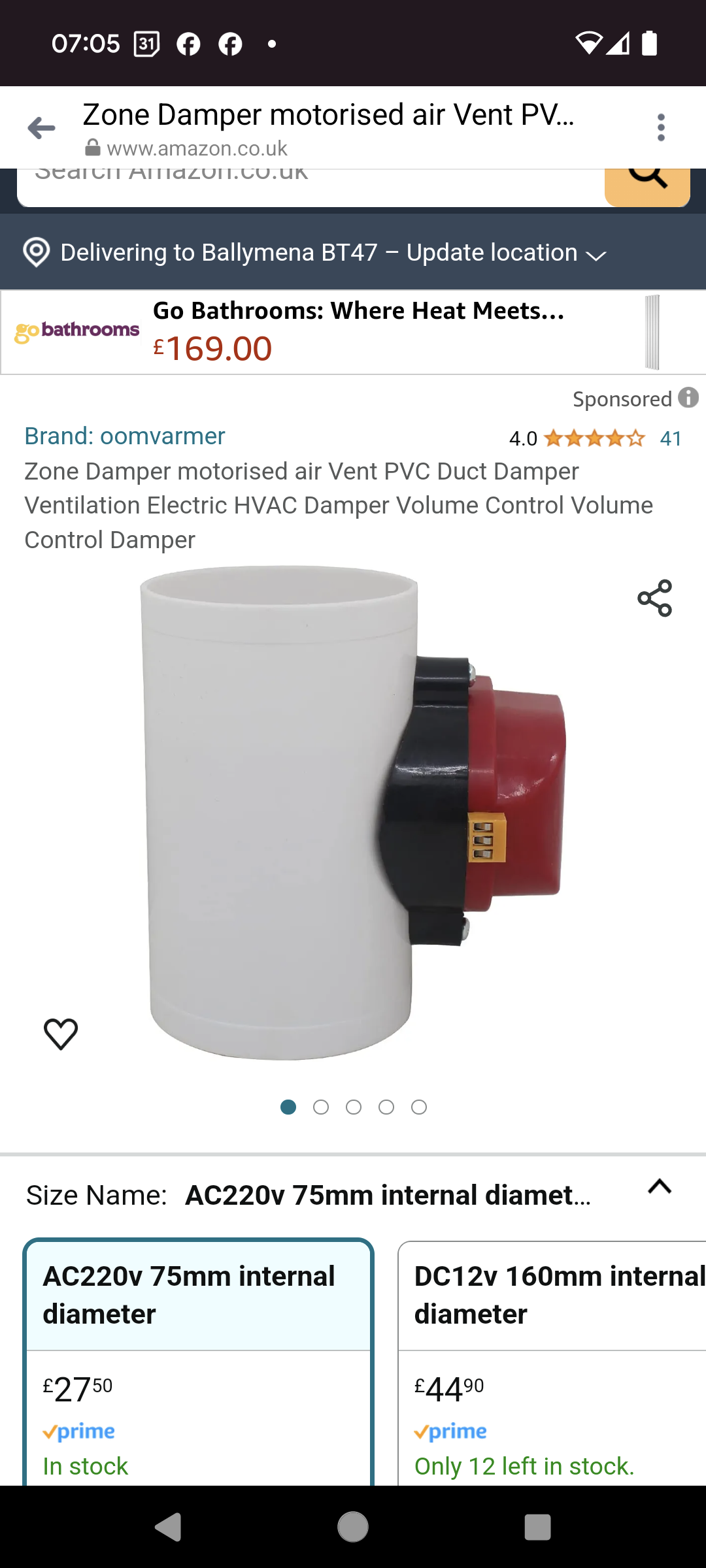

Kitchen extractor, what if you used this?
I said to all to use recirculating hood not vented but was asked what if we used this? Obviously I don't want to compromise our near passive standards.Screenshot_20240506-070559.thumb.png.0e514aeec7a4a174e4240be01916a41c.png
Edited by CalvinHobbes
Why?
You really don't need any cooker hood on daily basis with MVHR it does all the work. You only really need it occasionally.
Agreed. Fit a recirculating hob that vents to the room for the occasional time you need it and MVHR for everything else.
Those chinesium dampers may not seal off terribly well and are a pain to try to interface as they're live to open/ live to close. A spring return one would be handier...
If the MVHR has an extract point in the kitchen put a filter pad in it.
We change ours at least every six months and it is amazing what grease and crud it catches that would otherwise be deposited on the inside of the ducting and the HR heat exchanger. Ditto bathrooms to catch towel fluff.
HX in central plant then stays squeaky clean, as it is in ceiling void over stairwell this reduces need for servicing off an extending ladder.
