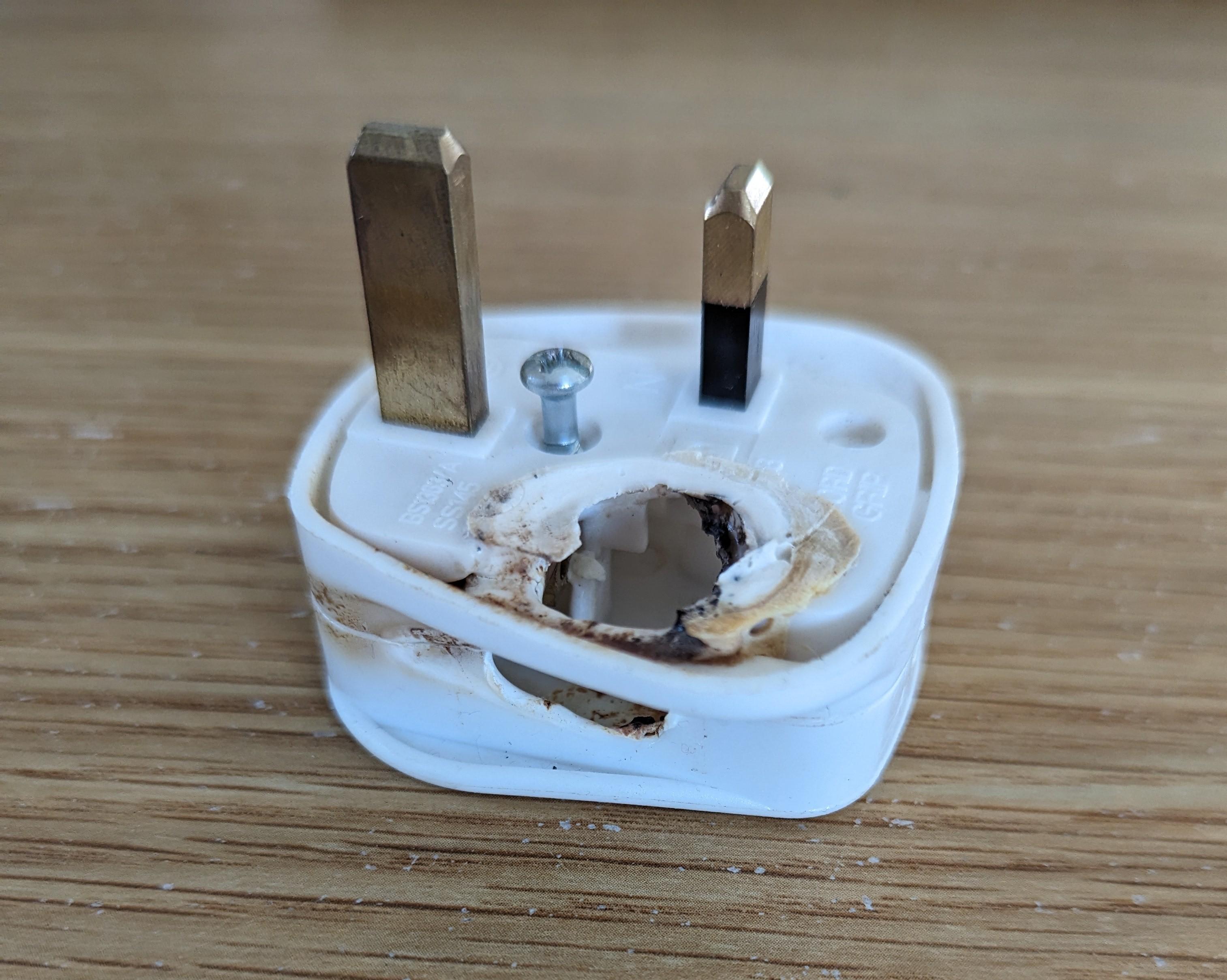

Crofter Posted May 4 Share Posted May 4 Think I had a close shave here. Plug now replaced and I'm keeping a very close eye on it. Any suggestions for why this would have happened? Link to comment Share on other sites More sharing options...
dpmiller Posted May 4 Share Posted May 4 too much for too long. There's always a small amount of heating effect at a contact point- which in the case of a plug tends to weaken the sprung contacts that hold the fuse. Vicious circle then... Tumbledryer? Immersion heater? 1 Link to comment Share on other sites More sharing options...
Crofter Posted May 4 Author Share Posted May 4 8 minutes ago, dpmiller said: too much for too long. There's always a small amount of heating effect at a contact point- which in the case of a plug tends to weaken the sprung contacts that hold the fuse. Vicious circle then... Tumbledryer? Immersion heater? Yup it was running an immersion heater. In theory it should have been sufficient for the current. This bodge only came about because the sparky didn't realise we had two immersions on the tank. I think I'll need to get it done properly... Link to comment Share on other sites More sharing options...
dpmiller Posted May 4 Share Posted May 4 Nope, 3kW continuous is too much for a 13A plug. 1 1 Link to comment Share on other sites More sharing options...
ProDave Posted May 4 Share Posted May 4 The fuse, which by it's nature is a bit of resistance wire, will also have got hot and looks to be the culprit. Feed it directly from a 20A double pole switch, not a fused switch unit or you will just be moving the next failure to the FCU. 1 Link to comment Share on other sites More sharing options...
Crofter Posted May 4 Author Share Posted May 4 2 hours ago, ProDave said: The fuse, which by it's nature is a bit of resistance wire, will also have got hot and looks to be the culprit. Feed it directly from a 20A double pole switch, not a fused switch unit or you will just be moving the next failure to the FCU. Ideally I'd be setting it up with a WiFi enabled timer, so that it could run on the E7 off peak rate, and we could turn it back or off when we're away. Not sure how to go about this though. Link to comment Share on other sites More sharing options...

Crofter Posted May 4 Author Share Posted May 4 1 hour ago, Nickfromwales said: Contactor all day long matey. The plug is rated 10a continuous…… you dodged a bullet there 🙁 Funny, it says 13A on it... which it obviously couldn't handle! Link to comment Share on other sites More sharing options...
FuerteStu Posted May 4 Share Posted May 4 (edited) People just assume they can plug anything into a socket and it be OK because 'if there's a problem the fuse will blow'. Nope. Manufacturers instructions will always tell you how things should be connected and there are good reasons for it. Even the correct contactors need to be selected to allow for suitable loads. Edited May 4 by FuerteStu Typo Link to comment Share on other sites More sharing options...
Nickfromwales Posted May 4 Share Posted May 4 (edited) 23 hours ago, Crofter said: Funny, it says 13A on it... which it obviously couldn't handle! 13a peak, 10a constant. Resistive heating can suck full power for sustained periods, and everything warms up really quickly. Fuses will run ‘molten’ where the metal is borderline melting point, and the heat then spreads and it goes terminal. Use a timer to fire a pair of contactors, and make sure the 2 immersions are fed independently, and things will be less ‘toasted’ looking Edited May 5 by Nickfromwales I can’t spell contactor 1 Link to comment Share on other sites More sharing options...
