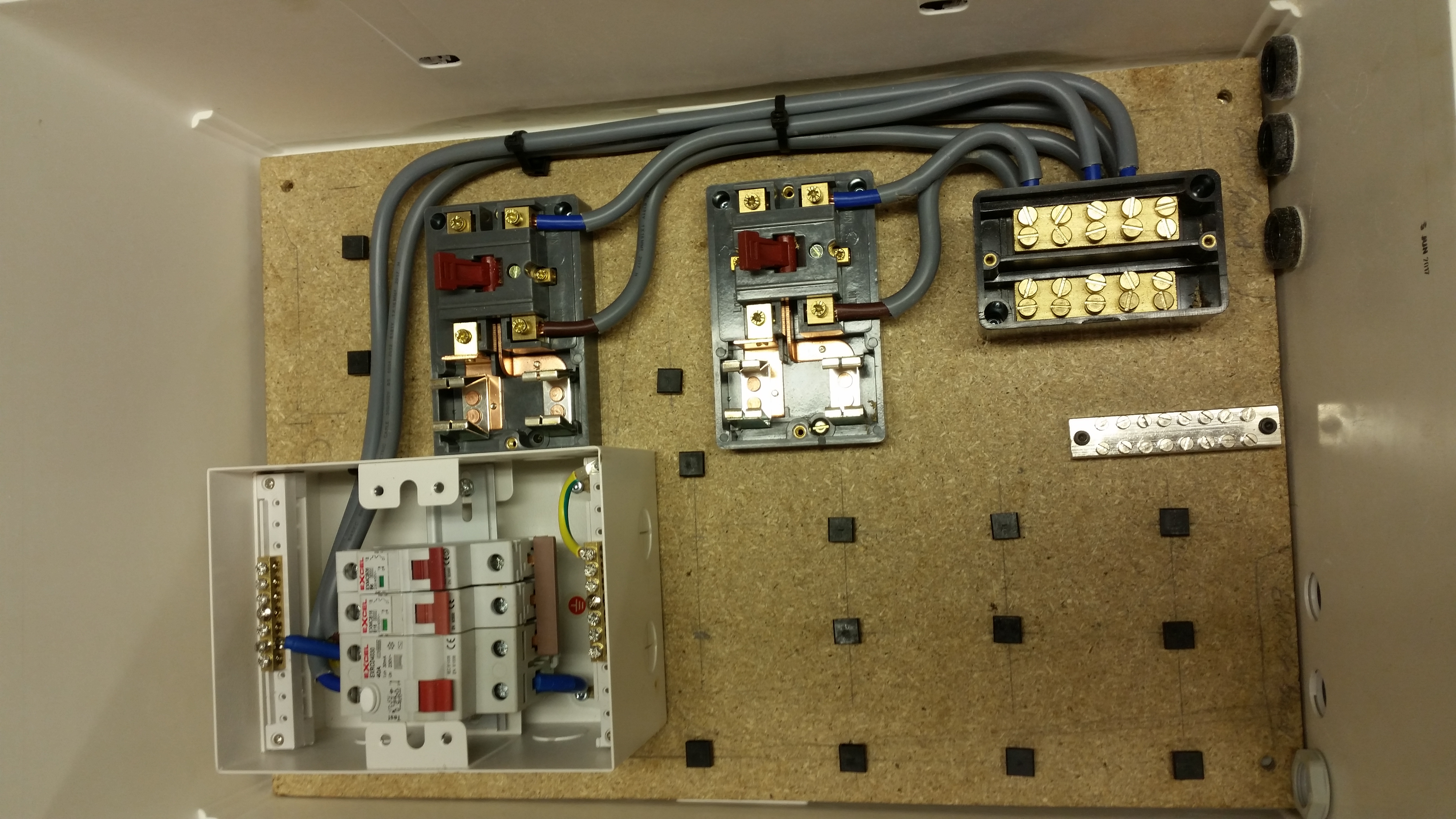

I built the distribution panel today, see below. The other cables are external and while the two leaving for the garden room and house are SWA there are two 25mm tails coming in the from meter box via the main isolator in the meter box, directly behind this panel, and I am wondering of I need to mechanically protect them in trunking or some such? Also I have stripped back the tails I have used in this panel far enough to ensure you can see the cable colours outside the housings of the switches etc - it feels like the right way to do but is this the right way to do it?

Double decker Henlys are legal but a bloody nightmare waiting to happen, IMHO.
Do NOT leave exposed single insulated cable at all, it MUST be double insulated into the enclosure.  Use tape or sleeves around the outer sheath to denote whether the cable is line or neutral, either brown and blue (preferable) but red and black is still generally accepted. Labels wrapped around the tails, with the lettering "L" and "N" is also acceptable.
This is most definitely Part P work in England and Wales, and cannot be done as a DIY task, unless under the direct supervision of a suitably qualified person.  Yes, some of it is nonsense, but there are gotcha's in the regs and it's the electrician who signs off the work that will get it in the neck if things aren't done correctly.
Yes, the tails between the cabinets need physical protection, too, the outer sheath is not specified for exposure, so needs protecting.
Worth getting a copy of the current edition of BS7671, and, far more useful, a copy of the OSGs, that translate BS7671 into plain English.

I have this - and was today reading the briefing on the changes for the upcoming edition next year. I was referring to section 412 (412.1.2) in doing the internal wiring but as you need to strip the outer double insulation off cables going into socket terminal etc I thought the same would apply here - there is no corresponding part 7 so no derogation.  However I was not sure so I hence my question, I was happy to adjust it all but will now rewire it anyway as two henry blocks will not allow me to reuse the tails I have. I guess its the openness of the panel that makes the difference which I think means that inside the CU I do not have to take the Double insulation right up to the terminal and as long as it is double insulated through the switch cover boundaries it can be single insulated for the few mm up to the terminal. I have the shrink wrap for other bits of the installation and will use it here as well. I will do some sample connections and get chapter and verse before I start though. The installation will be checked by my brother in law who will make all the final connections, check my work, and certify the installation.

The general rule of thumb is that any line or neutral cable within an easily accessible location must be double insulated, with the guidance being that the inner layer of insulation should not be  able to be touched on the outside of the switch/henly/meter enclosure by a finger or conductive tool.

I too don't like the double deck Henley's. Just one thin web of brittle plastic separates them. I much prefer two singles side by side, some makes even interlock when so arranged, but much more substantial separation. But they are in now so I would leave them.
You are not supposed to strip the outer sheath outside the enclosures. If you want to check the colour you take the cover off.

Thanks Jeremy & Dave I will get the two Henly blocks tomorrow and rewire it without the exposed colours and use shrink wrap colour marking instead.

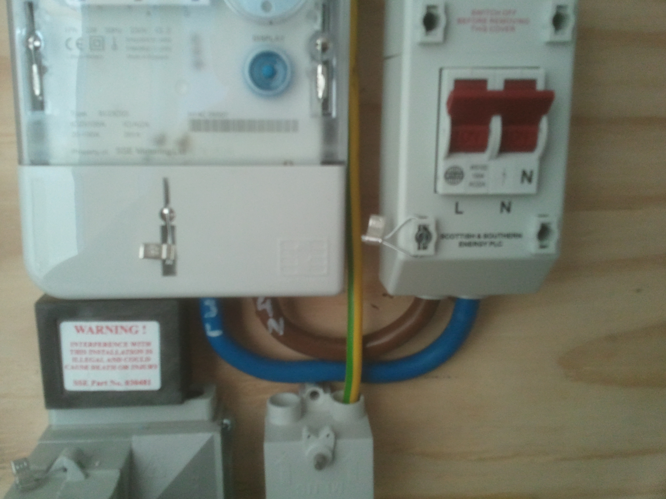

1 hour ago, ProDave said:
The meter monkeys round here just seem to use a white sharpie and don't always get it right

Just to be clear. In my picture those are insulated AND sheathed cables, it's just what the cable the DNO's use up here have colour coded sheaths.  It was the markings with the sharpie that he got wrong.
Yes - I thought as much. I have another question or two for you Dave, sorry. In this topic you posted a picture of your meter box and you have same switches that I have but I notice you have put the incoming at the top although on mine the Lin Nin are at the bottom of the switch. I understand that the electrons won't mind but is it common to use the switch in reverse direction to the labelling or is your switch labelled the other way up. If I reverse the ones I have the whole fuse assembly would be live even if the switch was off I think and there is an internal cover for the lower terminals (not in place in my photo above) to protect you if you open it live. I could simplify my cabling if I could switch the direction of one of the two switches but I guess good practice would be to have them both the same anyway. Also I took a length of the outgoing SWA apart today to see how I would run that around the panel to the top of the switches (16mm 3 core - inc Earth) I noticed that the cores are not double insulated once you split them into three so I was wondering how I handle it up to the switches given that I had in mind splitting out the earth just above the outgoing gland. @JSHarris has what looks like a solution in his meter box picture below yours in the above topic. Did you sheeth the cores Jeremy?

Yes I stand accused. Poetic license, I know my switchfuse is wired "wrong" I would not do it like that for a customer.

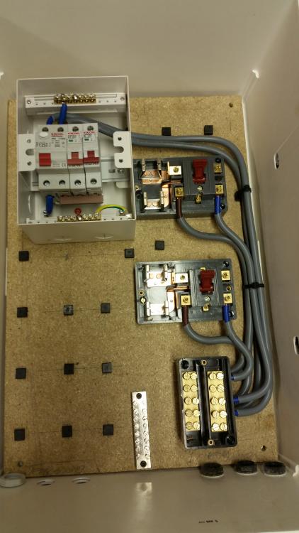

Sorry for the late reply, been away for the weekend with no internet access.
Yes, I used grey heat shrink sleeving over the line and neutral SWA cores, where they were exposed at the point where the three cores came out of the main cable sheath.  I also used a larger adhesive lined heat shrink sleeve over all three cables and the SWA core, then used a pair of needle nose pliers to form a three-way branch and seal the end of the SWA core, whilst the heat shrink adhesive was still tacky.  This formed a neat termination and maintained double insulation right into the fused isolator switch.

Thanks Jeremy - good to see you back on line. I am thinking I will do the same but thought I might take advantage of the piranha nut not being full of the SWA gland and screw a gland down over the three tails (once sheathed) and use the gland to seal the three together although now emerging able to be separated if you get my drift.

I only ran the main insulated SWA core up inside the box to avoid having to fit long lengths of heat shrink over the cores.  The central core of the SWA acts as the double insulation layer right up to the point where you strip it back to get the cores out.
