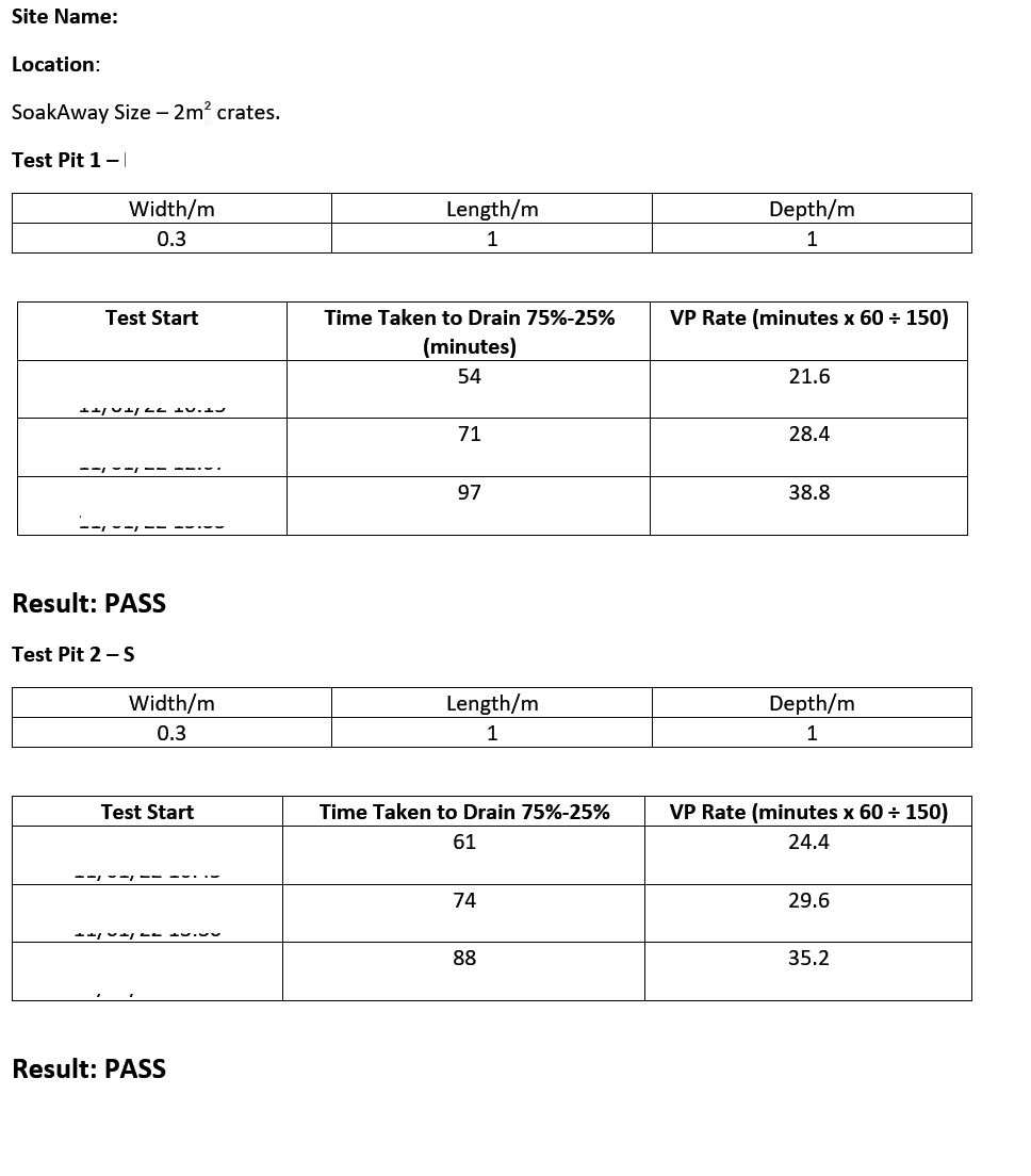

Dave Jones Posted April 30, 2024 Posted April 30, 2024 do your own perco test, its dead simple. Heres mine, warranty and BCO fine with it. ] 1
SarahG Posted April 30, 2024 Author Posted April 30, 2024 On 30/04/2024 at 07:54, Dave Jones said: do your own perco test, its dead simple. Heres mine, warranty and BCO fine with it. ] Expand Perfect- thanks. I am going to do that. On 29/04/2024 at 21:11, ProDave said: You can't have a soakaway design until you have a percolation test result. Expand Then I will have my soakaway design!
