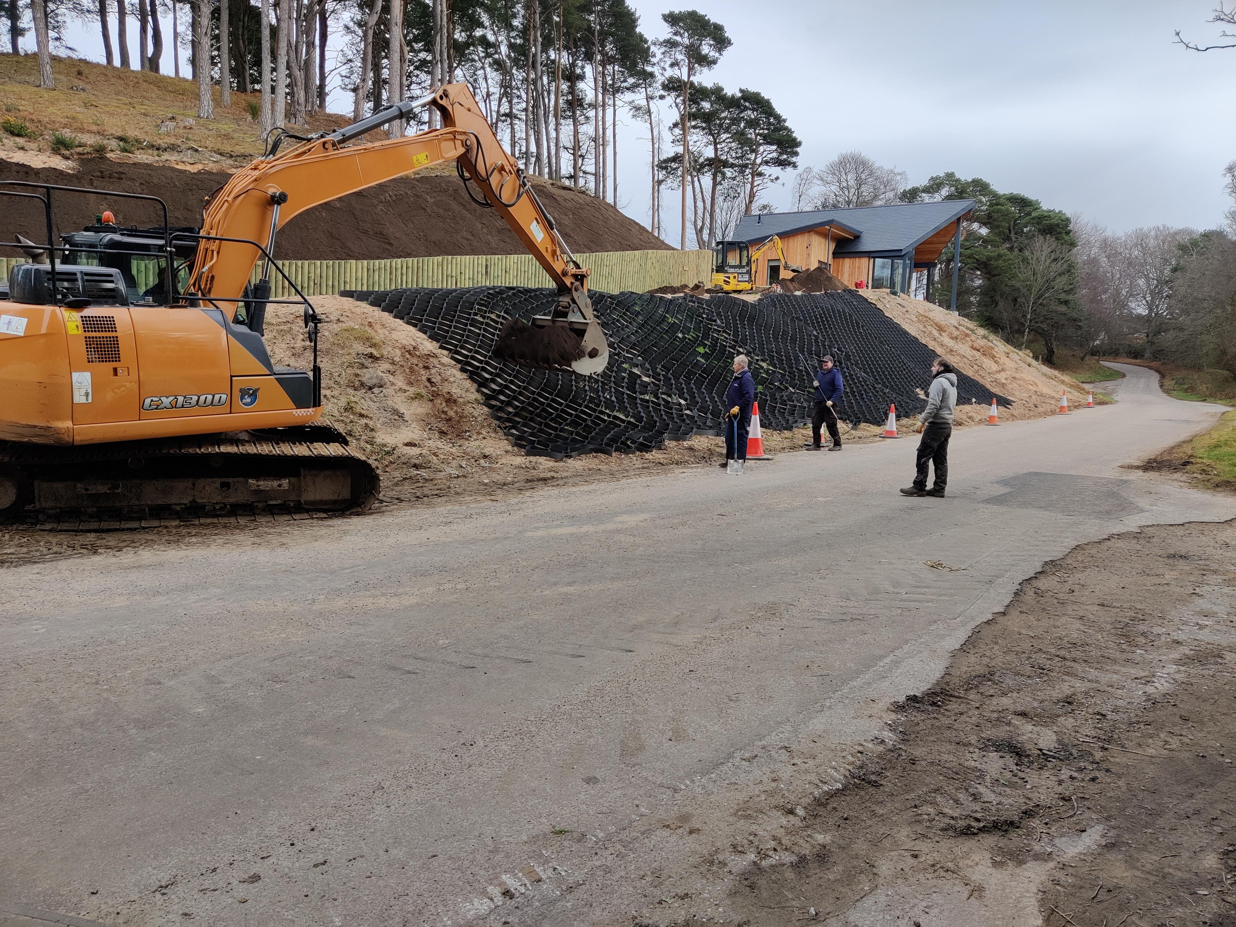

Gone West Posted April 16, 2024 Posted April 16, 2024 Our property is on the side of a hill and consequently the garden is a mix of terraces and slopes. There is one slope which varies in height from 2m to just over 3m and has an average angle of around 60 degrees. We want to tidy up the front of the slope and I had the idea of using hessian sand bags filled with soil which would be stepped back slightly to keep the angle the same. Then the bags could be slit and planted with ground cover plants. Anybody done this before?

JohnMo Posted April 17, 2024 Posted April 17, 2024 16 hours ago, Gone West said: Our property is on the side of a hill and consequently the garden is a mix of terraces and slopes. There is one slope which varies in height from 2m to just over 3m and has an average angle of around 60 degrees. We want to tidy up the front of the slope and I had the idea of using hessian sand bags filled with soil which would be stepped back slightly to keep the angle the same. Then the bags could be slit and planted with ground cover plants. Anybody done this before? I did a small area on a 50 deg slope, a couple of years later the bags have all rotted away, but it does give time for the plant roots to take over. Much less labour intensive is the correct landscaping mesh then back fill with soil. 1

Gone West Posted April 17, 2024 Author Posted April 17, 2024 14 minutes ago, JohnMo said: Big scale That looks interesting. I guess the mesh is plastic and pinned into the soil. I doubt I would be able to buy a 25mx3m chunk.

JohnMo Posted April 17, 2024 Posted April 17, 2024 57 minutes ago, Gone West said: doubt I would be able to buy a 25mx3m chunk. Think it came in manhandled sections and was pinned to the ground with bent rebar pins. 1
Ferdinand Posted April 17, 2024 Posted April 17, 2024 It sounds like you need a flexible system not a rigid grid. This was done on one the very first Grand Designs, back in 1999, with Kevin being introduced to landscaping mesh as used on embankments, which comes as a folded concertina of large hexagonal cells. This was when he was still an interior decorator and had hair. Series One Episode 4. Probably there are now "biodegradable over X years" products made of organic materials. The Amersham Water Tower. Lovely background music. Here's the C4 link. You'll need to tolerate some adverts. The first GD with application of "commercial architecture" techniques. They have done a couple of revisits since. The bit you want is at about 37 minutes, but the whole thing is worth a rewatch. https://www.channel4.com/programmes/grand-designs/on-demand/26262-004 Look under "soil erosion prevention" or "gravel retention" or "GEO grid" categories. 1
