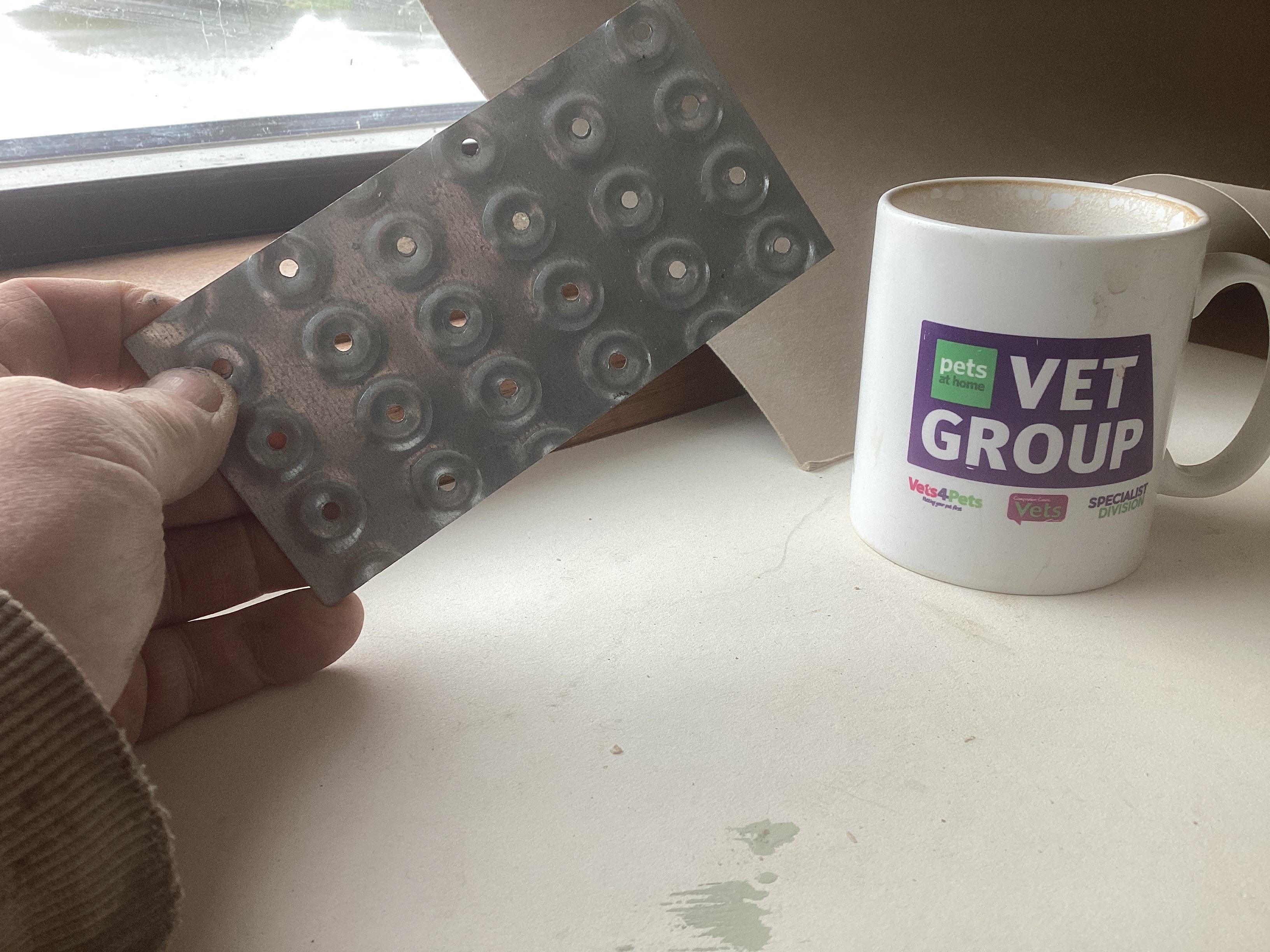

Mr Blobby Posted April 10 Share Posted April 10 So our window fitter didn't have enough of the specific fixing straps that clip into the side of the frame of our very expensive internorm windows. He said he would drill into the side and that would be fine, but it just seems a bit crap to turn up without the straps and then improvise on site. When I asked him to use the proper straps he said it would take too long to get them from Austria. The window fitters are off site for a few days and coming back to finish fitting the remaining windows (including the very big windows and slider that will be the most challenging) next week. (We are responsible for the delay) Should I insist on the proper fixing straps or let him drill away? Link to comment Share on other sites More sharing options...
Russell griffiths Posted April 10 Share Posted April 10 (edited) You can get a multi hole strap from most builders merchants and screw fix. I had boxes of the correct straps, the fitters said they are crap and sent me to screw fix for a bundle far better, more flex for acurate screwing. Edited April 10 by Russell griffiths 1 Link to comment Share on other sites More sharing options...
Mr Blobby Posted April 10 Author Share Posted April 10 8 minutes ago, Russell griffiths said: You can get a multi hole strap from most builders merchants... To screw into the side of the window frame or clip on ? Link to comment Share on other sites More sharing options...
Russell griffiths Posted April 10 Share Posted April 10 Screw to frame. I think I used 5x30 wood screws. strap is probably the wrong word plate is a better description 120 long by. 75wide ription Link to comment Share on other sites More sharing options...
