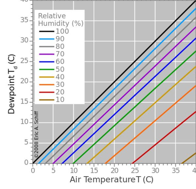

When it comes to condensation, the absolute humidity (the grams of water in a kg of air) can become important.
Indeed.
But the problem here is simple, so keeping it simple.
10 minutes ago, Roger440 said:
Indeed.
I think I improved that marginally.
