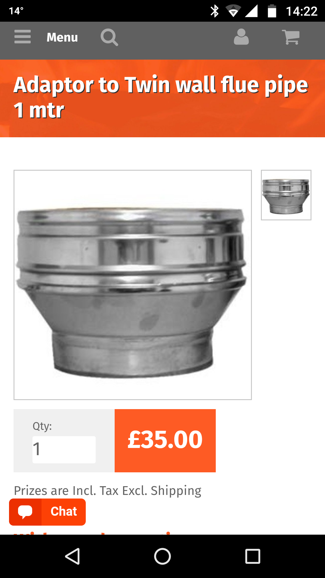

ProDave Posted October 11, 2017 Author Share Posted October 11, 2017 My flue-pipes.com flue arrived today. Heavily over packed and on pallet, and delivered in a 30t truck that had trouble with our little road. But very quick delivery It all looks good and as I expected. Now I am just starting to piece it together, I have one issue, the interface from the stove to the first bit of pipe: The 2 45 degree bends fit together snug as they do into the adapter and into the twin wall. But where the first bit of pipe fit into the top flange on the stove, it is a loose fit, probably 2-3mm all round. What do I fill it with? Fire cement? fire rope? or some high temperature sealant out of a gun? Link to comment Share on other sites More sharing options...
Tennentslager Posted October 11, 2017 Share Posted October 11, 2017 (edited) Do you not need one of these? Oh and yes fire cement...too high a temperature for sealant and you'd have a job ramming rope in there but possible I guess. Fire cement is 4 squid from screwfix Edited October 11, 2017 by Tennentslager Link to comment Share on other sites More sharing options...
ProDave Posted October 11, 2017 Author Share Posted October 11, 2017 I have that adaptor, that's there after the two 45 degree bends but I have not yet fitted the locking band to clamp the sections together. One small tub of black fire cement ordered from CPC £2.54 Link to comment Share on other sites More sharing options...
