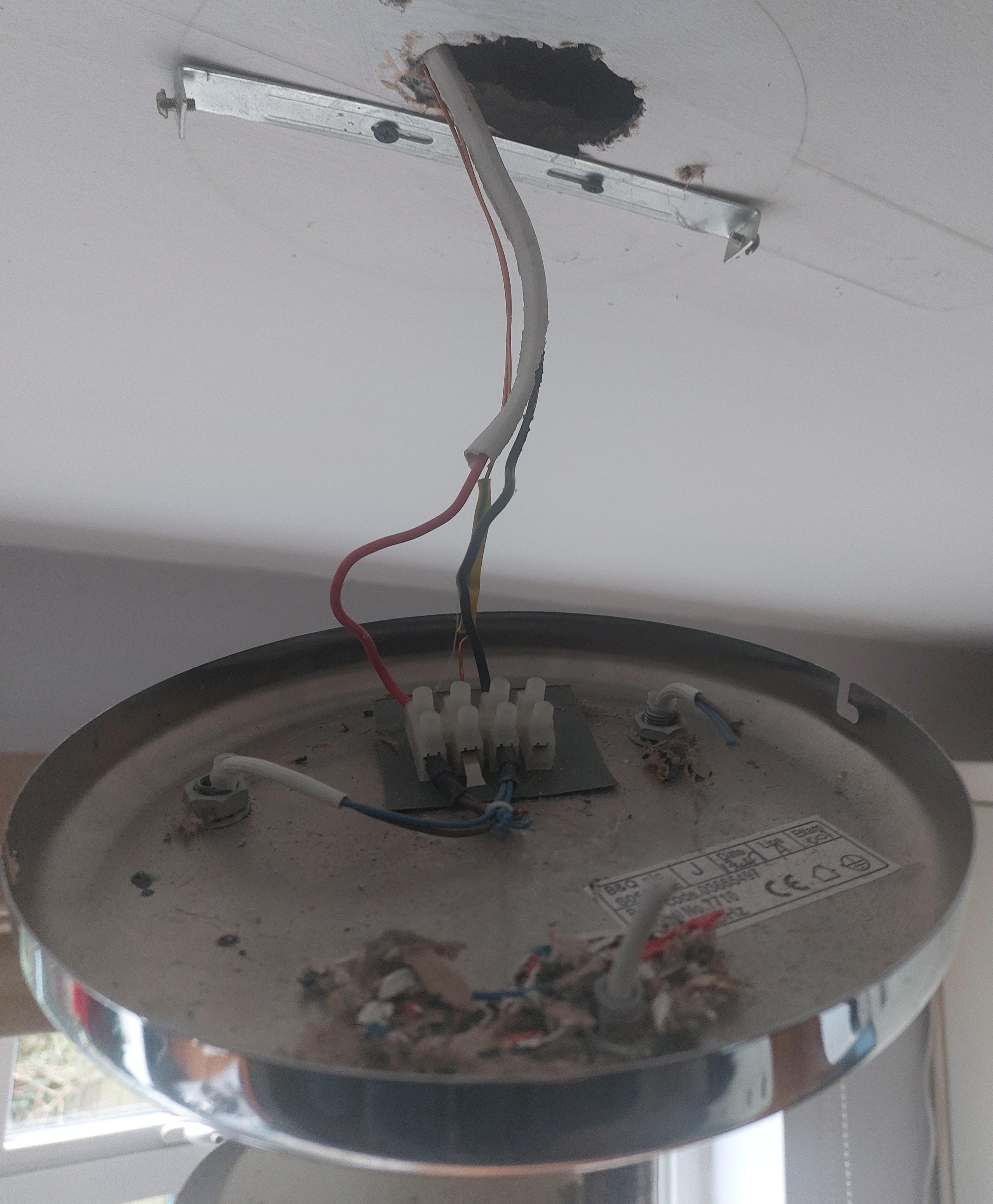

saveasteading Posted April 3 Share Posted April 3 The kitchen lights went off. so I went to the CU and reset the fuse. Usually that means a cooker hood light has failed. The lights went back on but the fan and other bulb still didn't work. On the basis that a chain doesn't break in 2 places I assumed the worst, that the fan had a major fault and the local spur fuse had failed when it was turned back on. (We hear mice crawling thereabouts.) New fan assembly needed? As a matter of course I checked the local spur fuse, which I found was was blown, and changed it, and expected it to immediately fail. But it didn't and it's all working with a replacement bulb. Hoorah. How can a light bulb fail and cause the spur fuse and the CU to ping at the same time? One must fail first and open the circuit. Fundamentally I don't know why a bulb failing (a fuse wire in itself) causes a trip at the fuse box anyway, let alone a ceramic fuse as well. Link to comment Share on other sites More sharing options...

saveasteading Posted April 4 Author Share Posted April 4 1 hour ago, Alan Ambrose said: mice don't nibble cable so much Something small did this. Link to comment Share on other sites More sharing options...
